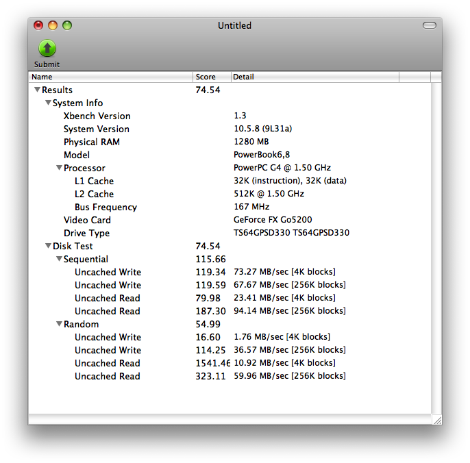

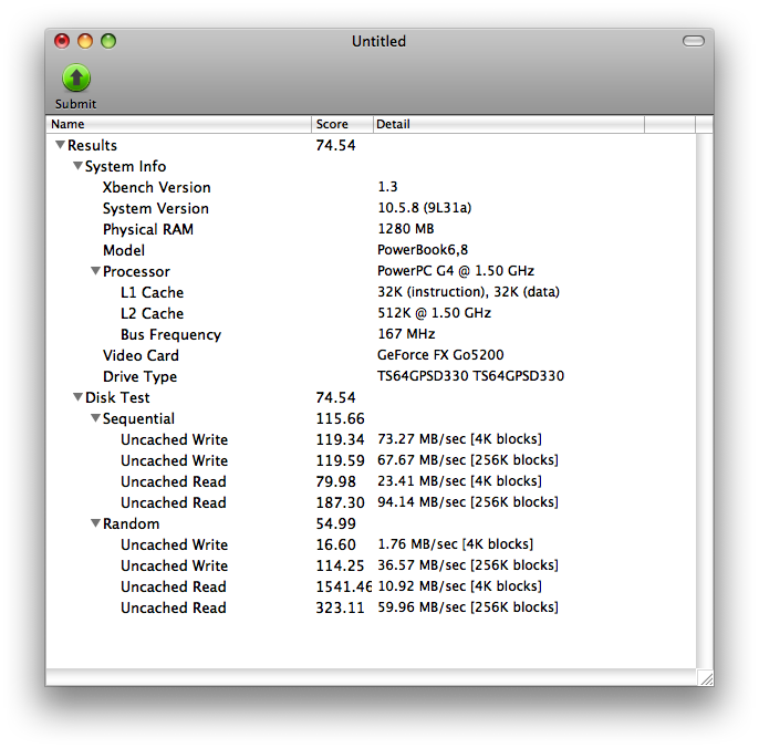

Why you not buy one of current available PATA SSD's? i have a transcend 64GB version on my powerbook, and its working pretty fine.
