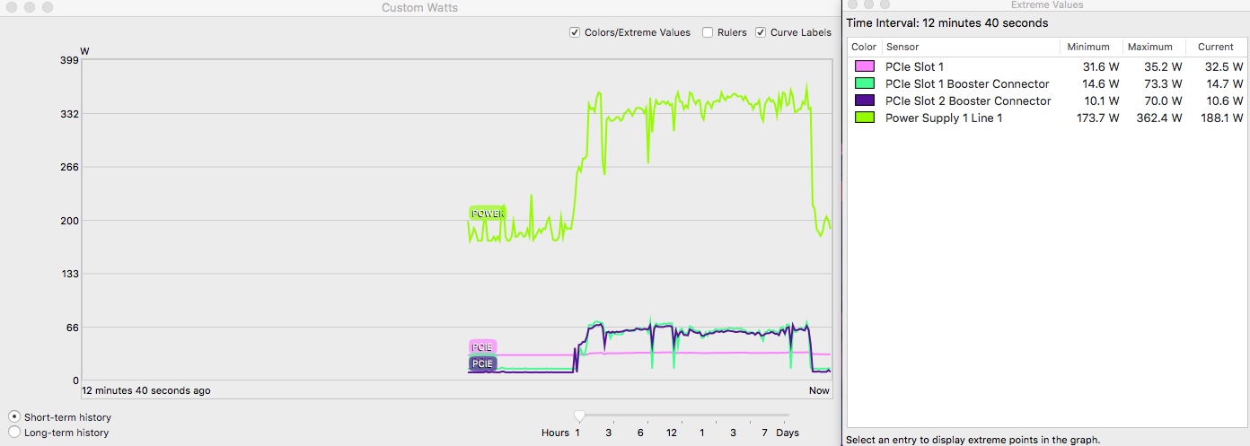

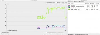

If I want to move forward and play this undervolt game, what would I need to verify how much wattage is being consumed by the GPU? right now just using hardware monitor with a benchmark test on Dirt 3 (settings all maxed) I got a max wattage of 74/70 but that itself is inconclusive.
Play it safe, I want to try an undervolt and bring it down just a tad and see what it does.
Hardware monitor should be good enough to let you see the difference. Of course hard to tell the accurate reduction because the demand is varying. But you should still able to see a noticeable difference if you do it right.

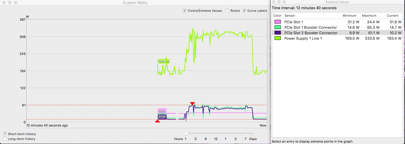

After some tinkering under windows I was able to drop the voltage from 1256mV to 1145mV which is about close to a 9% drop.
One thing I should clarify if anyone attempts to try this.
You must use the factory saved rom that you better have backed-up (in my case I did)
If your try editing your EFI modded rom that gives you the apple boot screen with VBE7 it will of course delete the EFI when you save, but when you apply the EFI patch, the patch will not work right and you will lose the apple boot screen.
You'll have to use the original rom (A copied backed-up original rom) go to windows, make the voltage changes using VBE7, save, go back to OSX, apply the patch, go back to windows and flash the rom.
I can confirm that the voltage changes did bring down the watts used on the PCIe power connector close to 10 watts
Thanks for the detailed report and correction. I can't quite remember if I can "re-patch" a VBE7 edited Mac ROM. Anyway, we can always start from the original ROM and patch it. You found the way.
Anyway, the new power draw looks very good to me, 65W max on the mini 6pin, very comfortable.
