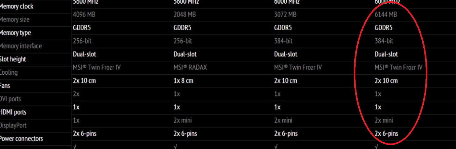

In addition to just being a beastly, beefy GPU with a ridiculous amount of VRAM, it has two 6 pin power connections, so if the leaked specs are correct, than it will run reliably within the limits of the cMP power supply.

Great news. 2x 6pin is impossible on 280x, though. Regular 280x TwinFrozr has 6+8, like all Tahiti XT/XT2/XTL cards do. I hope that they're improved cooling. 3GB one was getting a little hot under load. 270x looks promising as well. I'll be waiting for pricing and availability. Thanks for sharing.
Cool + totally agree re: power, but check out the image in the second link in my first post.
I'm including the images here for reference. Perhaps it's not a reliable source but we can hope!
Would have included direct links to these images but could not find anything other than what I shared in post #1.

You can see in Newegg's high-res photo that the card has one 6-pin and one 8-pin connector, but the package includes an 8 to 6 adapter cable.
