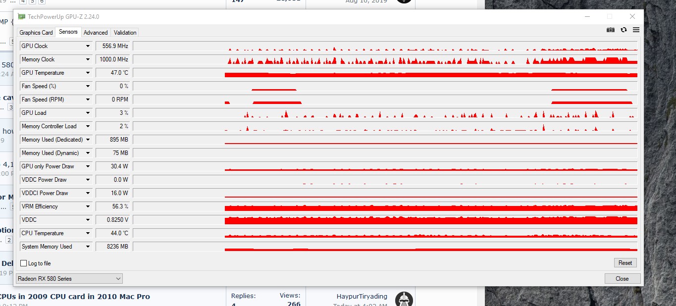

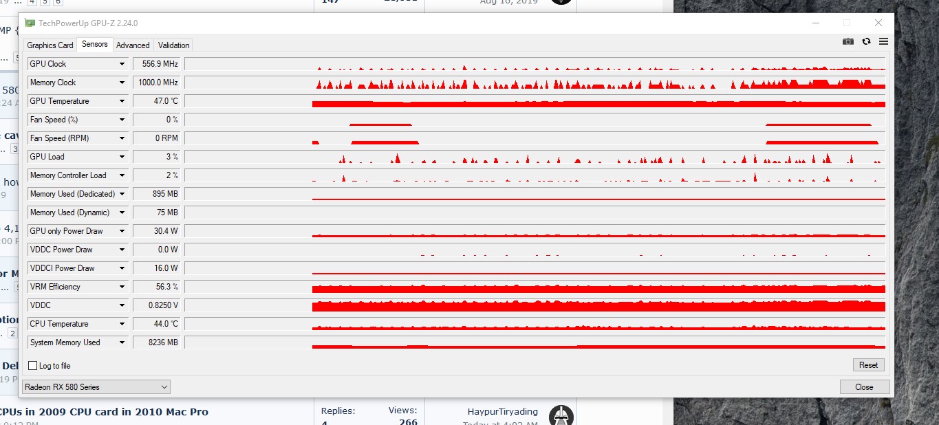

if your card is like my RX 580 pulse then at low use the fan will not spin then it hits 'x' temp and spins up then spins down, at idle to low use it's set to keep the gpu temp about 50-55c
off hand, I can't remember but in windows it's easy to watch with GPU-z, the fan will spin up temp drops fan stops temp goes up fan spins up and so on.
so if it's like my GPU then it has a 'zero' rpm fan setting, if you want lower temps you can edit the bios to keep the fan spinning non stop even at low use.
the power use from what i have seen basically matches what AMD say, one thing that catches people out is with 1 display it uses X power but with 2+ displays it changes to a higher power state and uses more power at idle.
relay easy to test if you have more than one display unplug one and you see something like a 10W drop in power use (from memory not tested it in ages)
I have noticed slightly higher power use in OSX over windows but that's from software and im not 100% if that's just different software reading things wrong or osx uses more power or just random error on my part
edit
so my gpu fan hits on aroud 50-54c then drops gpu to about 48c then turns of and so on at low use

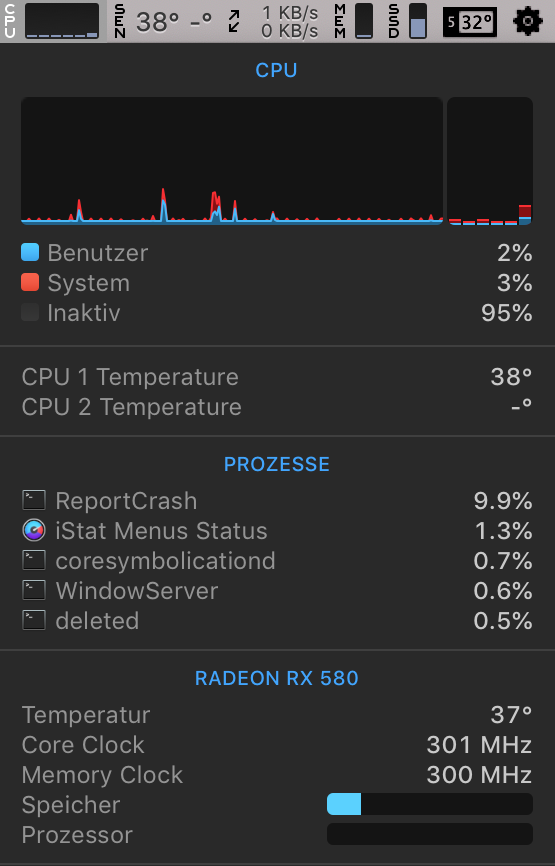

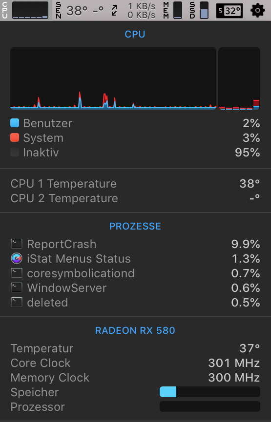

GPU temperature around 38°C just after cold boot is normal with ambient temperature 25°C, if the Mac Pro was switched off before for some time.

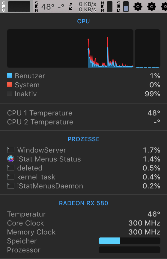

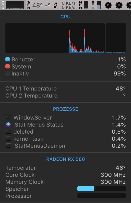

After a short time with normal use the GPU temperature is around 46°C.
