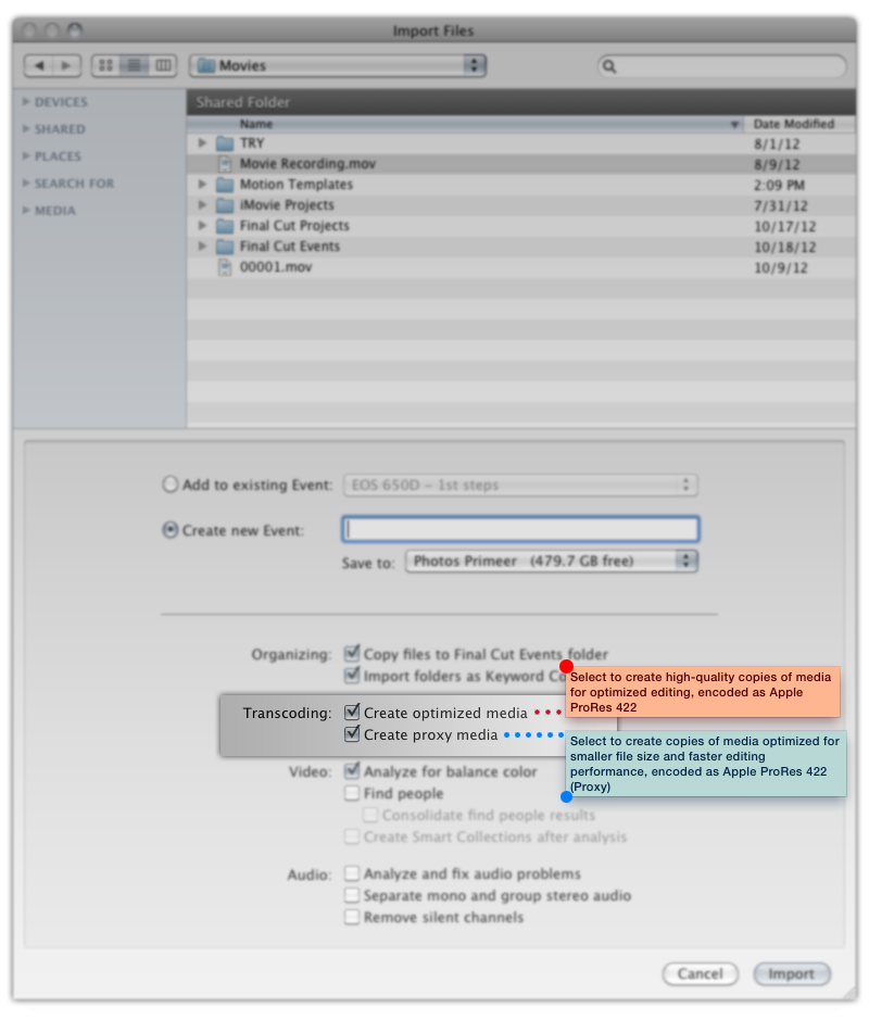

I spoke too soon... I tried running through this and it really didn't get me anywhere. The best solution I can come up with is to convert the original HD files to .mp4. They import fine and are quite good quality. Now I have a new problem though. When I import it into FCPX and start editing it, the playback is not smooth - in fact I can't really do a proper edit since it's too choppy to see how I did during playback. It starts playing back fine and then a couple of seconds in, it starts to go choppy. If I stop playback and move forward to a new part of the video and playback again, it will once again playback fine for a few seconds and then go choppy. How can I solve this so once it's imported it plays back smooth. Does it need to get rendered before editing - if so how? Or do I need to do something with Compressor - once again, if so how? Thanks again for anyone taking the time to respond. It's very frustrating as I have about 6 hours of video that I really need to rescue and get started editing a final product. Thanks.
What did you try? The guide (1st link) or the ContainerSwitcher application by floh (second link)?
When importing the MP4, did you select to optimize the video (meaning it is transcoded into a proper editing format)?

I followed the second link. The first one seemed a little complex (I'm fairly new to this). When I imported the mp4 video I did not select anything about optimizing. How do I do that? I assume you mean within the FCPX application itself. Is there something I can select to do that?
Ok, I'll try importing my .mp4's converted from high def .m2ts as optimized tonight and see if I can edit without jitters. Thanks again. Helpful youtube video by the way.
Ok, that did the trick. I thought it was something simple. Looks like I have lots to learn about this new app. Thanks so much!
