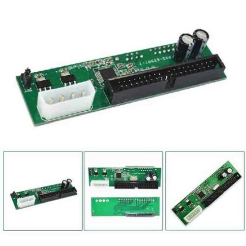

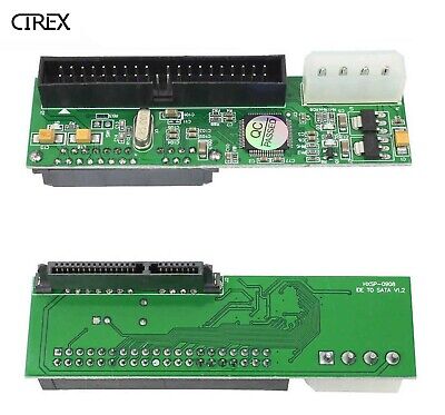

The ATA -> SATA board that I picked up off eBay - the power connector and the data connector are the wrong way around. Because of the position of the "missing pin", the board wont work on the Cube. I would love to try set the SSD up in the optical bay - as with the extra wriggle room (and missing optical drive) I have enough room to get the data and power connected - but I can't even instal an OS on the SSD in order to test it.
So - back to eBay...
This is what I bought:
This is what I need:
The notch/missing pin are upside down, so power cable has to go on the opposite side to accommodate the data cable.
Sheesh. Things you don't expect to have to worry about...
