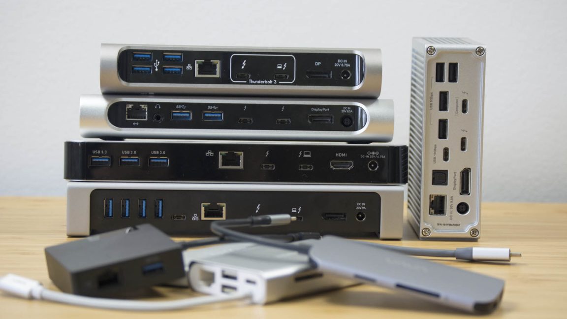

Now, if you want to use the "extra speed" of those USB-C TB3 ports, then you want either:
A Thunderbolt 3 hub - like the CalDigit TS3+ - although that gives you lots of stuff like ethernet, DisplayPort and laptop charging that you don't want and costs a lot.
A Thunderbolt 3 to USB 3.1 adapter/hub like this: https://www.startech.com/Cards-Adapters/USB-3.0/Hubs/thunderbolt-3-usb-3-1-hub~TB33A1C - looks like a regular USB-C hub but isn't (...but probably the Caldigit is still better value).
Maybe A "real" USB 3.1 gen 2 hub like this: https://www.lindy.co.uk/usb-c4/4-port-usb-3-1-gen-2-type-c-hub-with-power-delivery-p11211 - big "beware" on this, but a man in a pub told me that true USB 3.1g2 hubs can actually share the extra bandwidth of the faster 10Gbps USB gen 2 between multiple 5Gbps 3.1g1 devices (...i.e. each device can't have more than 5Gbps, but the total over all devices can be more than 5Gbps). Maybe others here can confirm it (I'm taking it with a pinch of salt at the moment).
