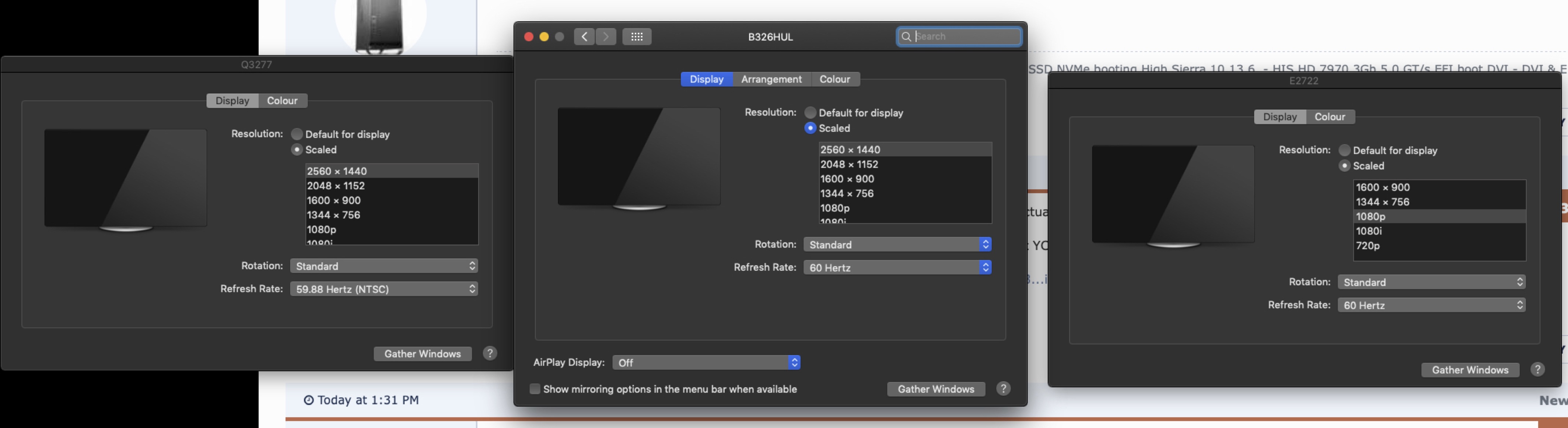

I just updated to Mojave and as usual the monitor Overrides that I set up in High Sierra were deleted Notice one of my monitors showing NTSC 59.98 instead of 60 HZ and the scaled resolutions include 1080i and 720p TV res.

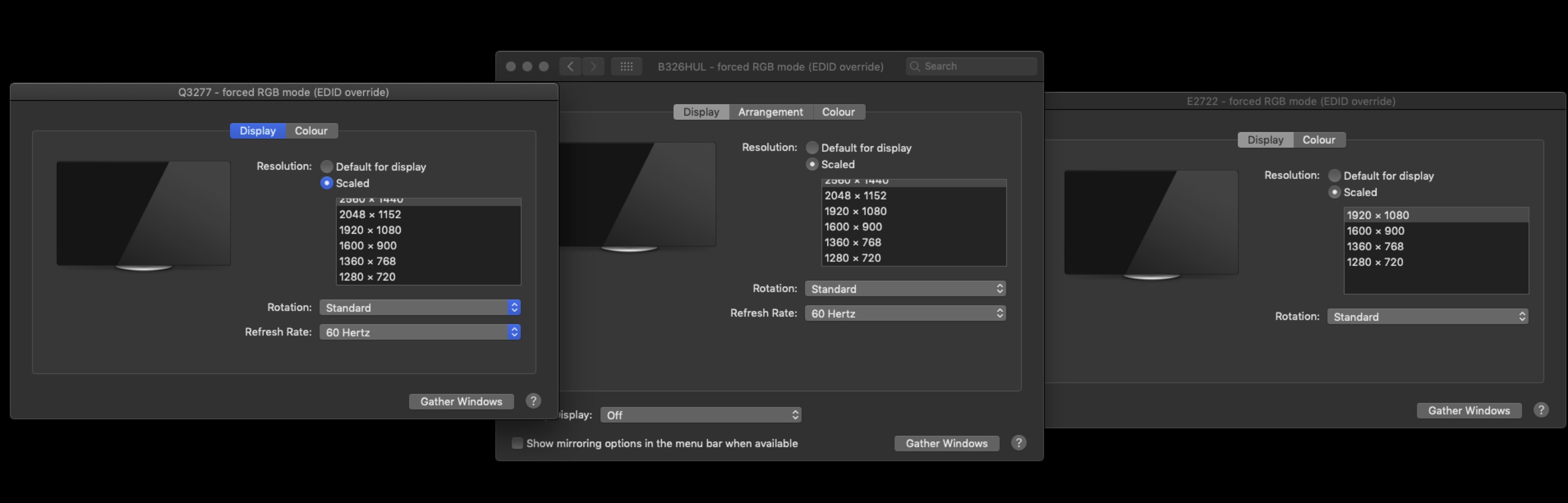

So then I ran the force RGB script and i get correct monitor resolutions and all at 60hz
