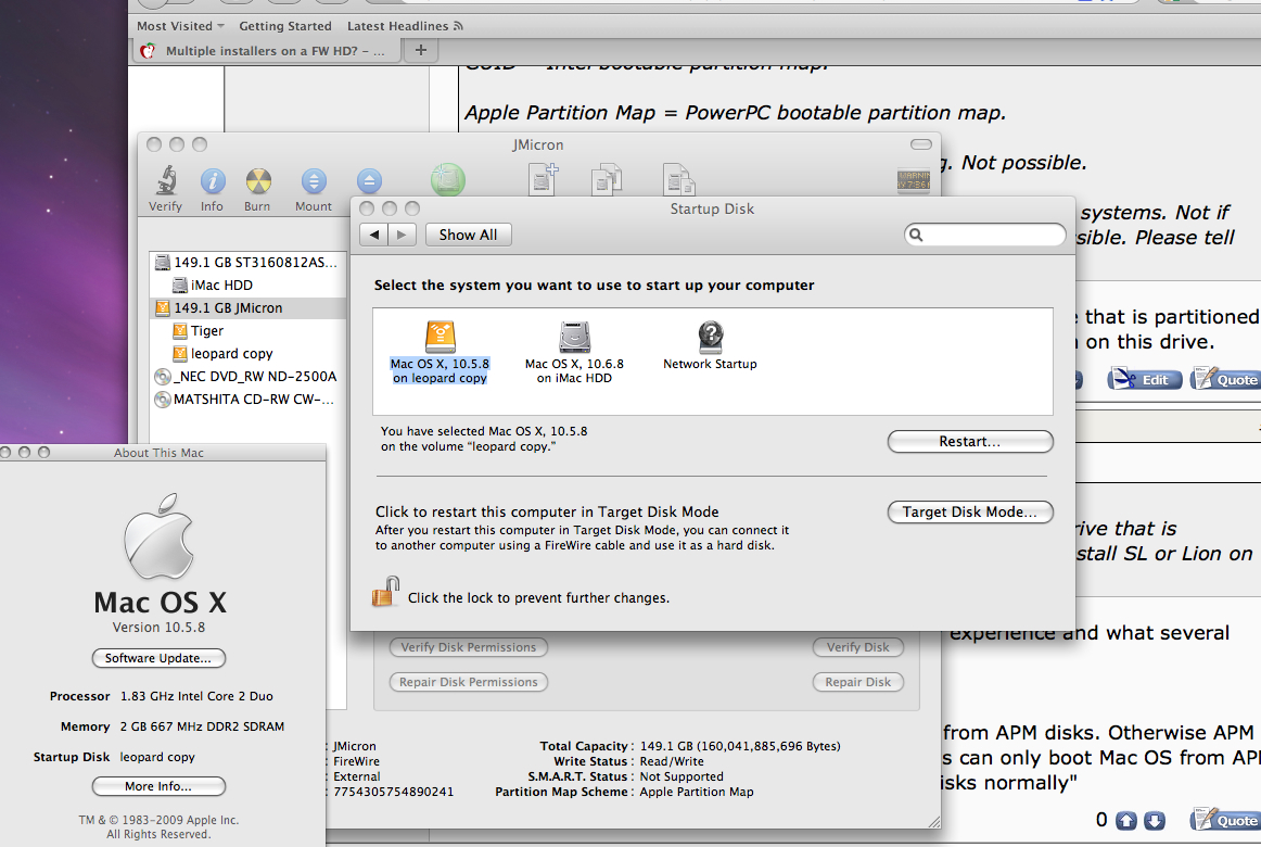

My Intel C2D iMac will boot to APM or Guid. I'm booted to a drive that is partitioned with APM now, with Leopard. I know that I can't install SL or Lion on this drive.

All I know is what my iMac will do.

I have the late 2006 iMac, and it did come with Tiger. However, it is easy to boot to a APM HDD. I just hold down the option key, after I turn on my Mac.
