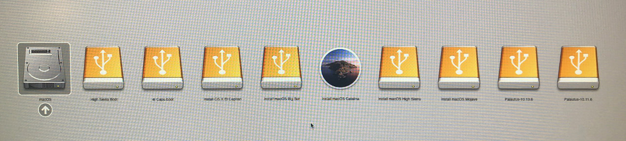

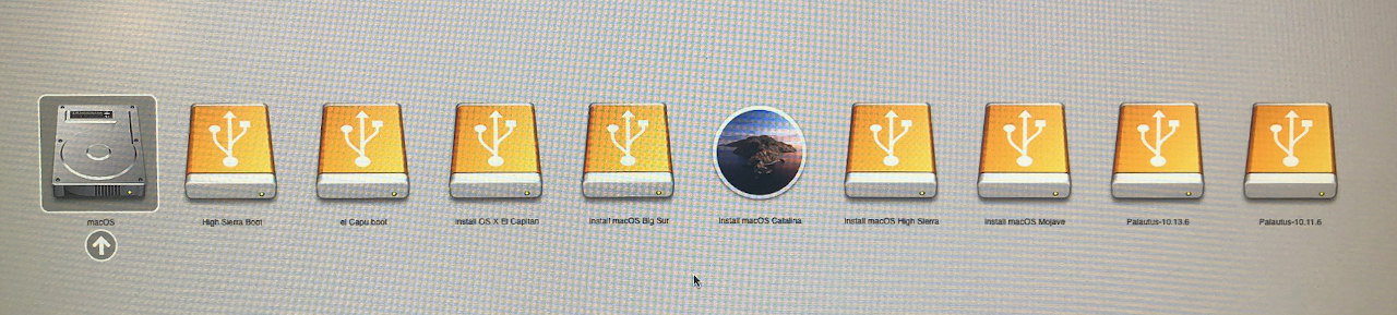

I tried if this USB blade SSD (the ssd was originally in MBP) of mine with several different bootable partitions work with my 5,1 and yes it does (also works with my iMacs, MPBs etc). Cannot figure any reason why it would not work the same way installed internally. And don't know any reason why 7,1 would be different. So, I suggest you try. Partition your drive and clone the existing OS to the new partition or even do a clean install to it. Then boot with alt pressed to get the boot selector.
