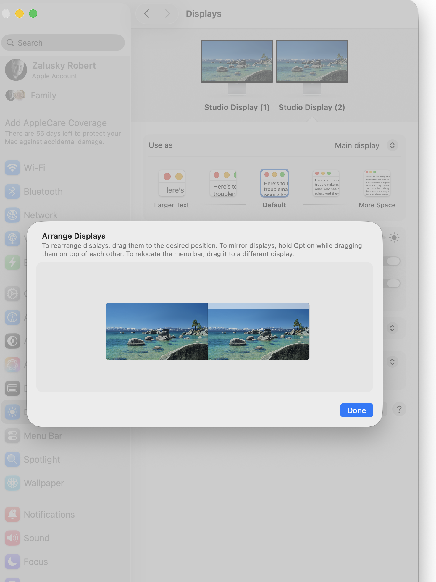

system settings -> displays -> arrange
Been there done that. That just moves them around - it does not change what is 1 and what is 2.
I want my new 2026 monitor on the right and the old 2022 monitor on the left.
System settings > Displays > Arrangement. Drag the small white menu bar from the Studio Display 2022 to the Studio Display 2026.
Been there done that:

Safari does not seem to have an option to set the default camera.

So what are you actually saying with that screenshot, buddy? That the rearrangement doesnt' work and you can't drag them to change their order? If yes, then it sounds like a bug. Have you tried to connect the older one also directly to your computer?
Did you read the whole thread? Somebody asked about my setup. The screen shot shows the setup but what I have learned is the application be it an app or or a web app is responsible for the monitor selection and apparently my particular medical group website does not have a monitor selection and simply goes to Studio Display(1) for the camera.

No, did YOU read my question? Can you arrange the monitors by dragging them under your system settings or not? If not, have you tried connecting them both directly to your computer and then dragging them?

What your suggesting will not work. The web app (the page OP is connecting to) does not have an option to select the camera -- it simply defaults to the first one presented by the operating system.
macOS assigns Studio Displays (and thus the cameras built-in to them) on its own at boot; there's no way to designate which one the OS sees first, not a way to reorder them. Rearranging the displays in the control panel as you suggested does not change which ASD camera is defaulted in the OS. And there's no way to disable a camera in one of the displays so the OS thinks there's only one camera connected.
Unfortunately for OP, the website he's connecting to is choosing the first camera in the list, which is the suboptimal one, and doesn't present him with any way to choose between more than one source like virtually every other app and website will.
Has nothing to do with which display is "primary" in the system settings. I currently have two Studio Displays connected to my Mac, plus an Obsbot Tiny 3 webcam. I'm able to choose which camera I use in most apps, but if the developer didn't put any method to choose, it would likely default to the wrong one -- and there's no function (at least accessible to the end-user) to tell macOS to ignore/disable the cameras in the Studio Displays. Requires physically unplugging them -- which of course prevents you from using them as actual displays.
It's a weird catch-22 of having the camera built-in to the display(s) but with no ability to turn it off at a system level.
