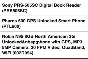

Are u trying to do something like in the given attached file.If so then create custom view,in draw rect of it draw string.And cell height should be the height of string that u want to display.Custom view should be added as subView to cell.contentView.If u are trying to do something like this,then i can give u code.
Ya suji.I want like this
Still have the source for this? I sure could use this. Still learning about custom table views and cells.
