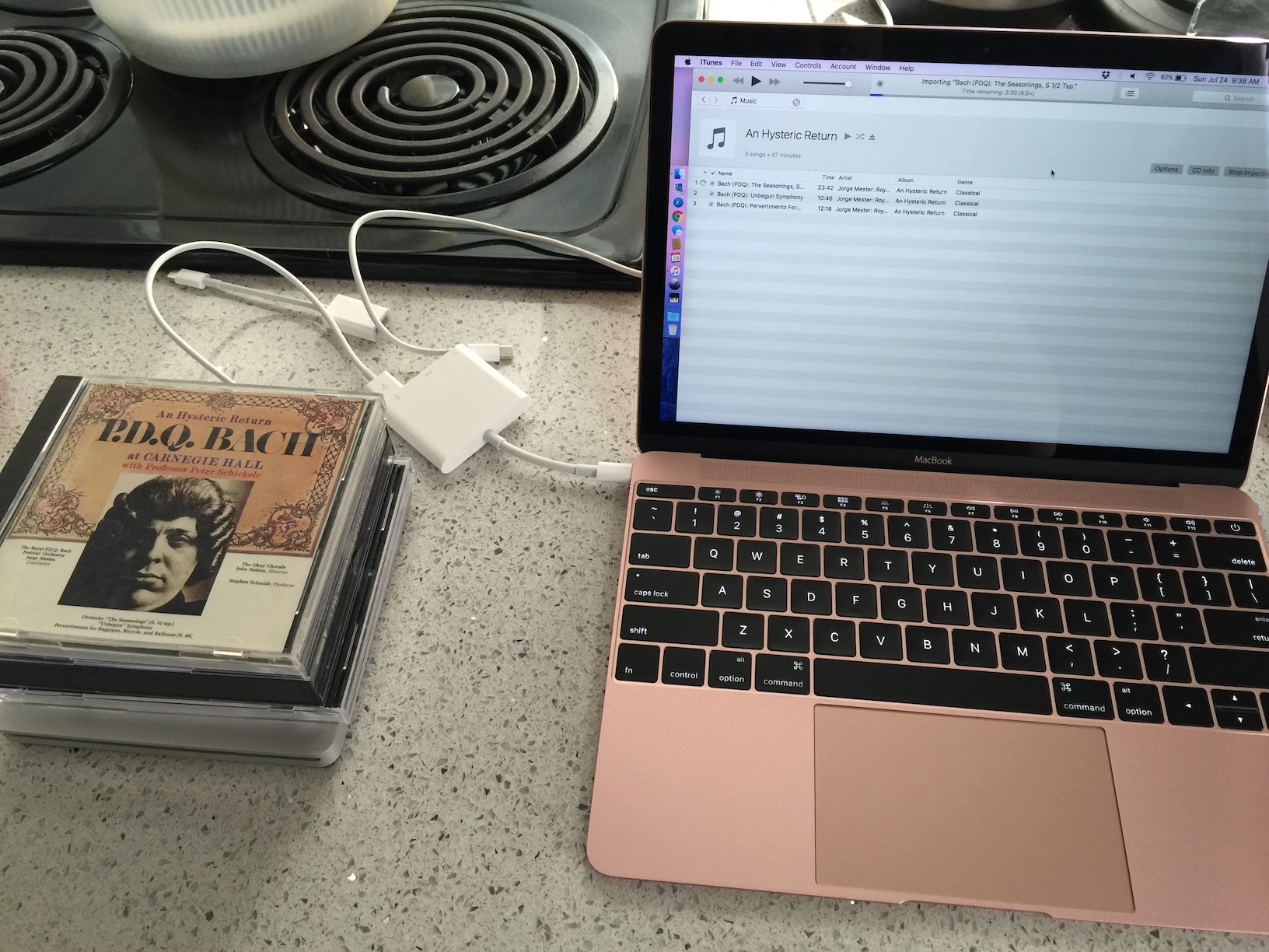

The $79 Apple adapter works without external power. See pic.
Oops! wrong thread. 😛
