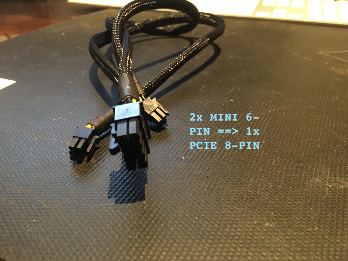

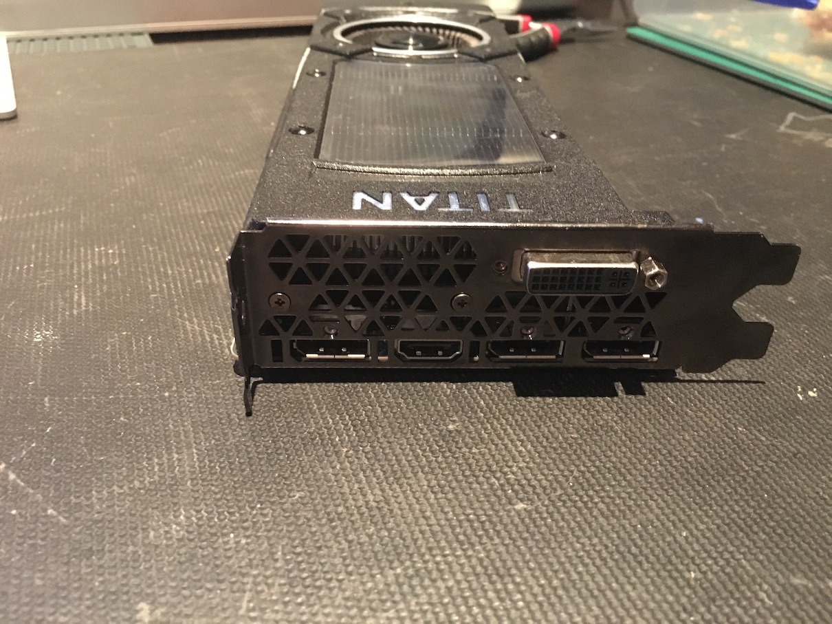

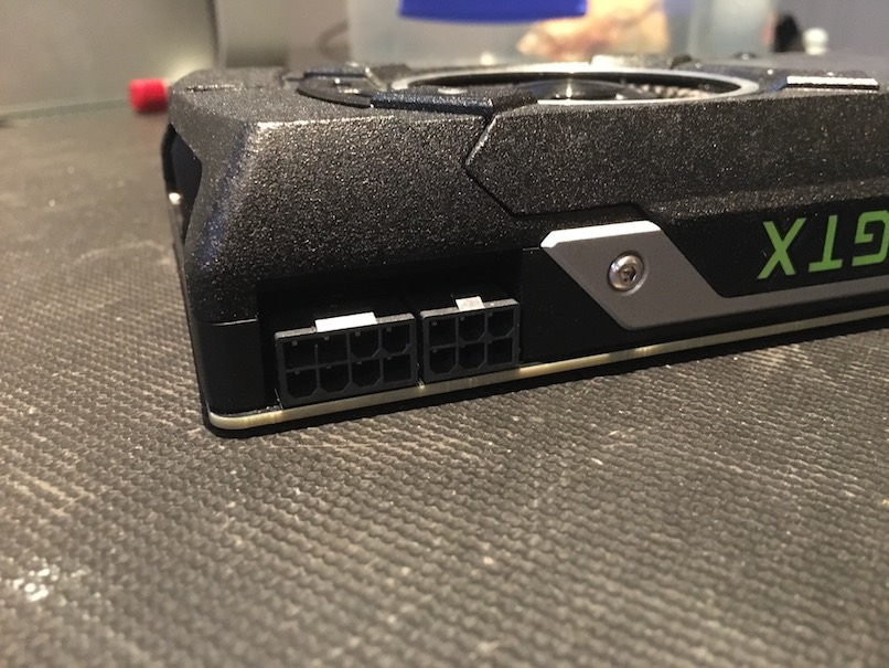

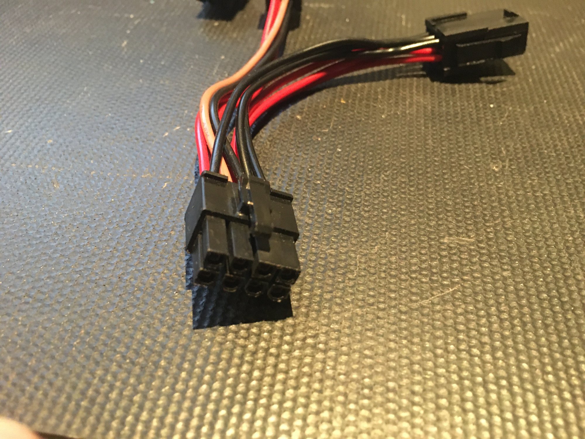

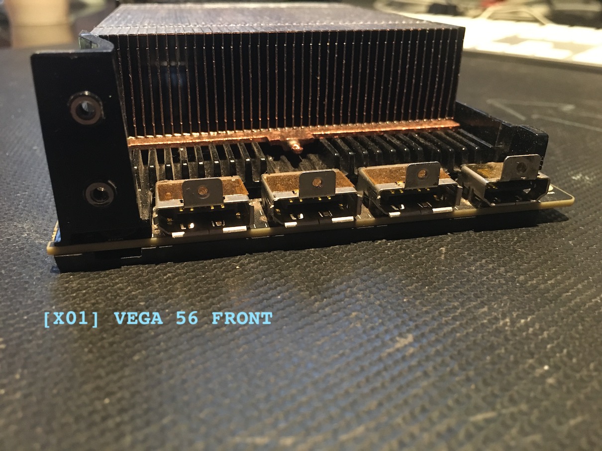

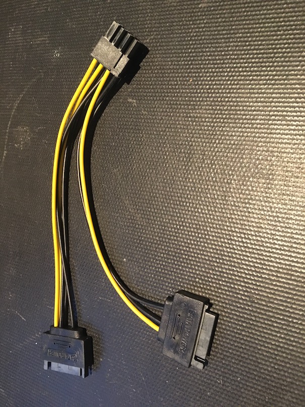

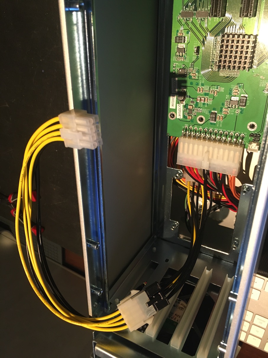

[ TAXONOMY OF ASSEMBLED FACTS AND OBSERVATIONS ABOUT THE RX VEGA 56 ]

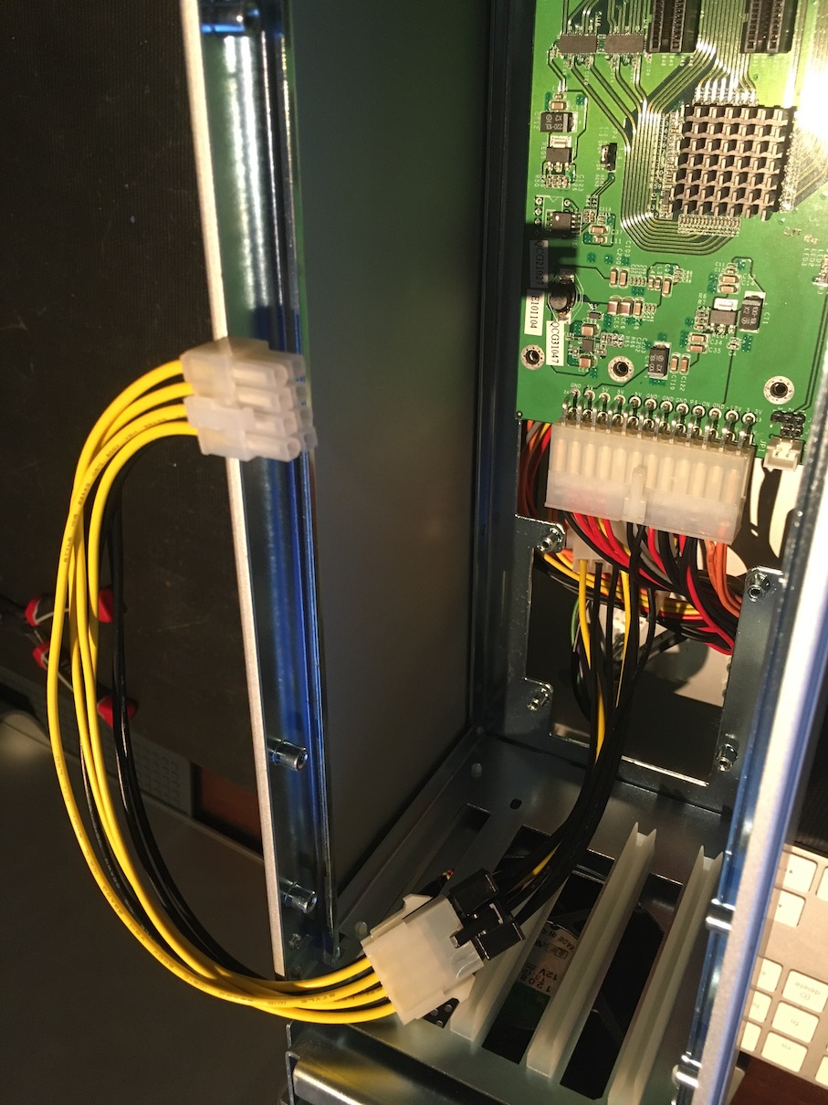

I've just been reading through this thread with great interest.
I'm in the unique position to report on my own experiences (and problems) with both of these very important Mac Pro tower GPUs (GTX TITAN X and VEGA 56).

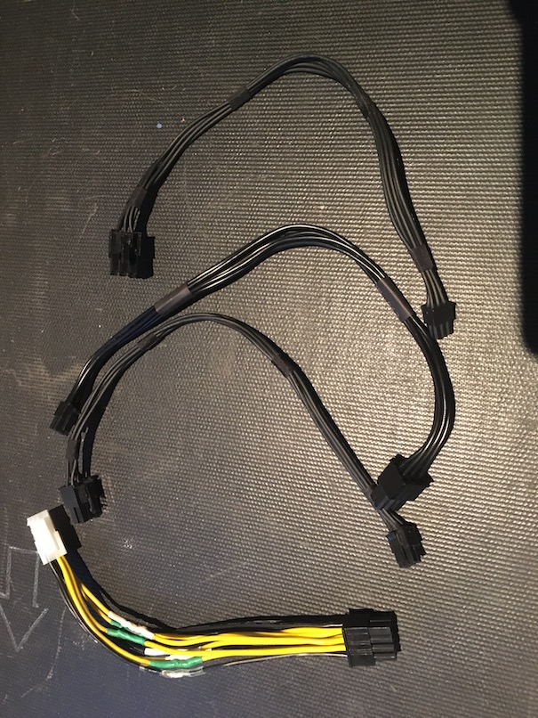

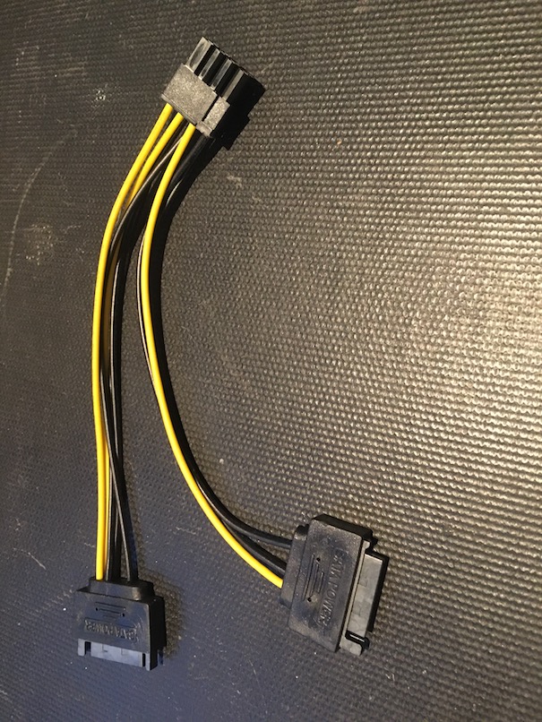

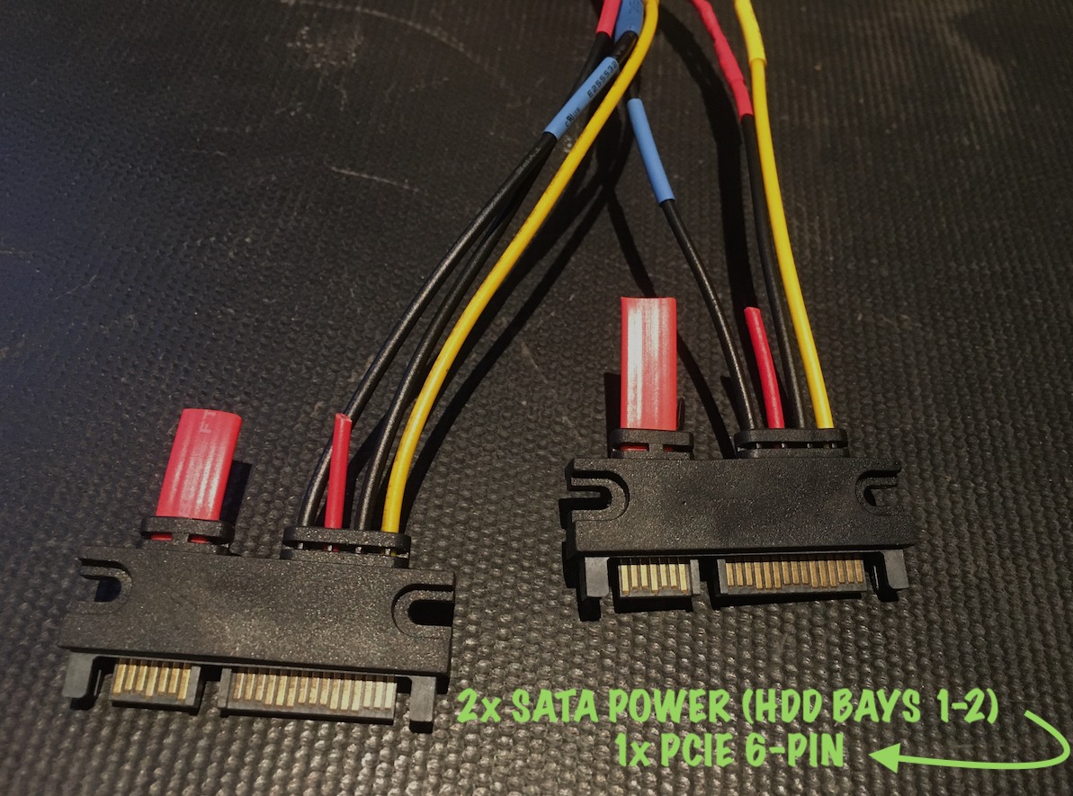

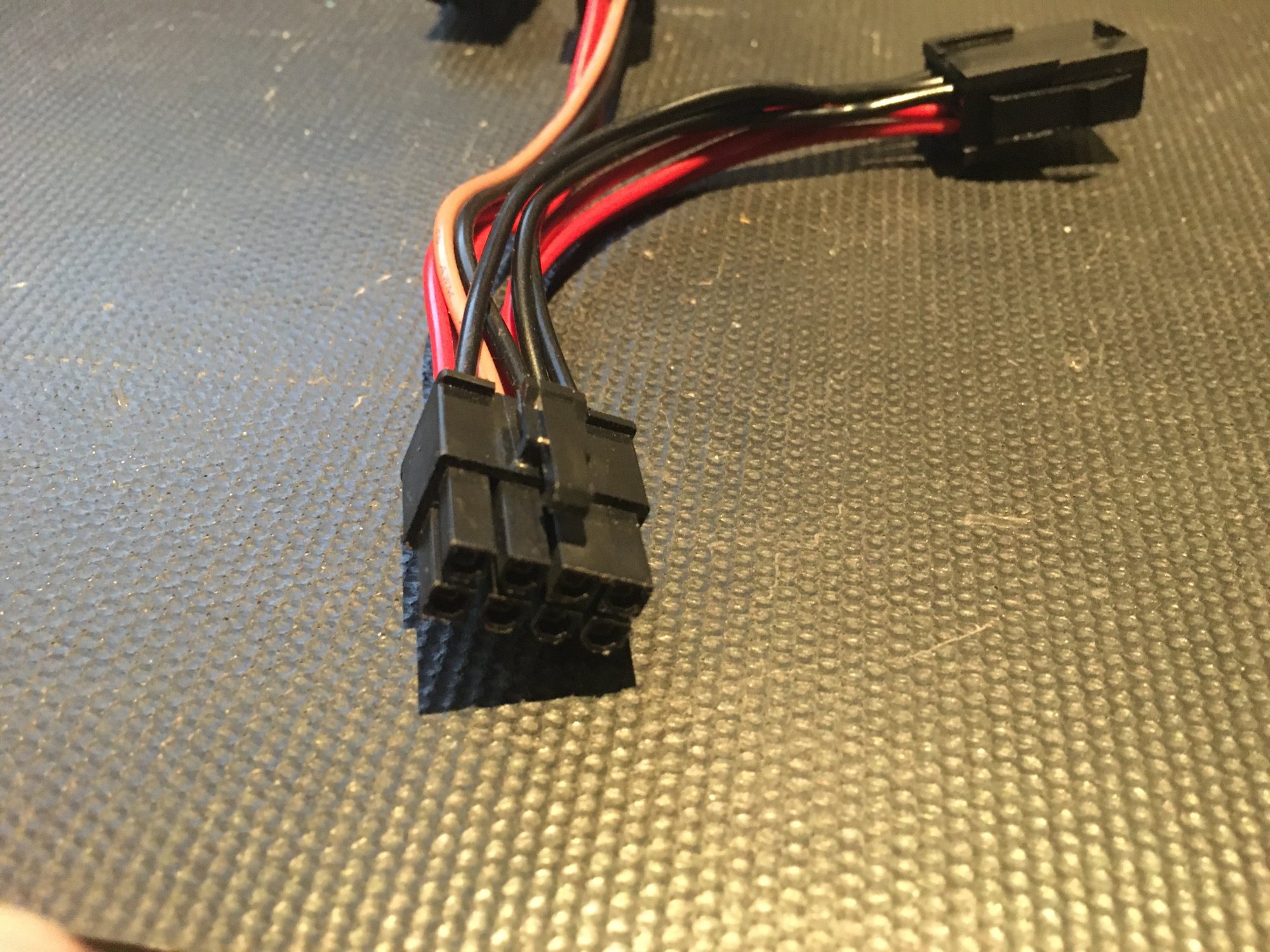

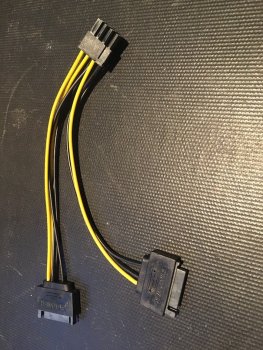

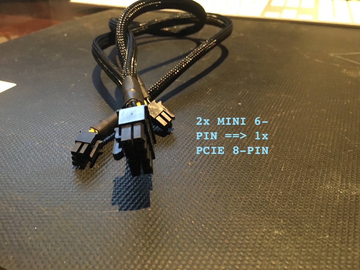

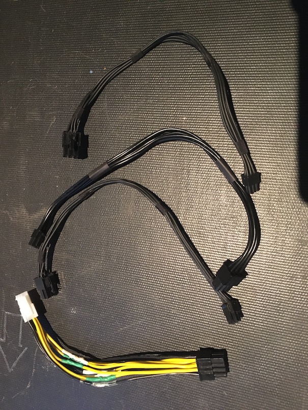

I will spend the next three hours running through a series of ower configurations tests using the extraordinary basket of GPU power connection possibilities in my possession.
Scientific method applies (trial and error). Images of PCIe power connection options pictured below.
I am very light on cash resources at the moment, so I would encourage you to chime in with your test requests ASAP as I will be selling all of the component parts featured in these tests over the weekend.
I hope we can solve many of the questions raised above. They were all my questions and I just decided to buy everything to do my own testing and eliminate doubt around so many of the soft answers I was getting. The last of my special 8-pin connectors arrived in the mail today - so let's get started..

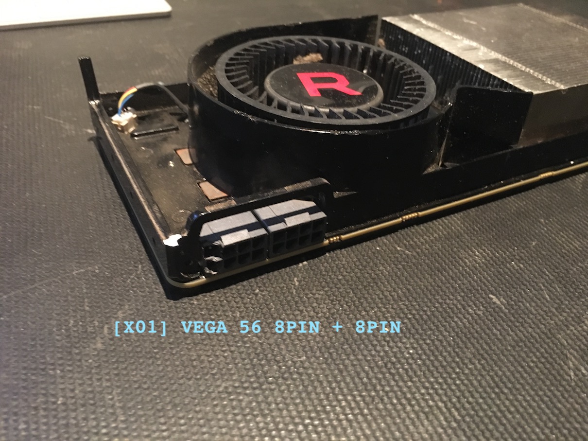

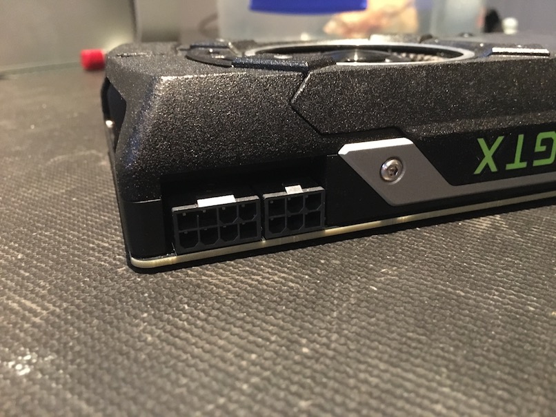

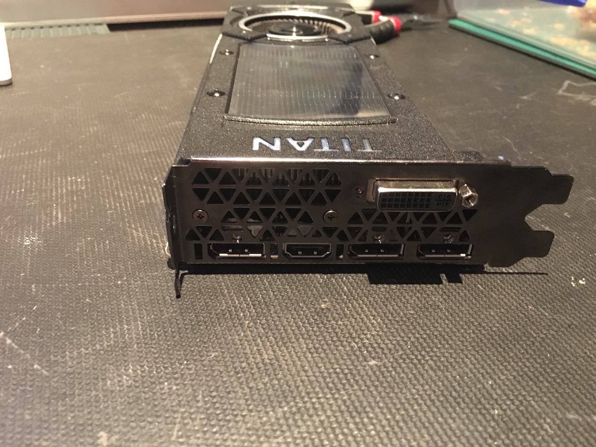

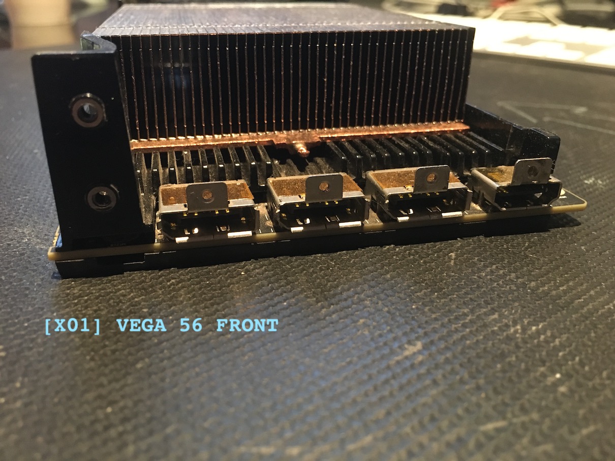

GPUS TO BE TESTED:
[X01] AMD SAPPHIRE RX VEGA 56 (REFERENCE MODEL) / 8-PIN + 8-PIN
[X02] GTX TITAN X 12GB (MAXWELL) / 8-PIN + 6-PIN
[X03] NETSTOR EXTERNAL GPU PSU (just in case it keeps crashing the cMP like @K Funk mentioned already)
MY preliminary testing before all the extra cables and external PSUs arrived was same as K FUNK. cMP clicks off in first 1 - 10 mins.
2x SATA POWER (HDD BAYS 1-2).JPGMINI PCIE POWER 8PIN.JPGMINI PCIE POWER.JPGP1.JPGNETSTOR EXTERNAL GPU PSU.JPGVEGA 56 8-PIN.JPGVEGA 56 FRONT.JPG TITAN X2.JPGTITAN X1.JPG

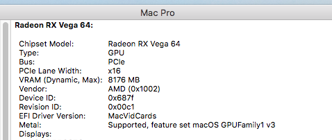

After only a single response of "did you plug the cables in?" I've heard nothing since after repeated emails. It seems he willingly takes your money but doesn't stand behind what he sells. I've confirmed the card is clocked too high and that's why it keeps shutting the machine down. I tried a bone-stock Vega 56 and it ran on internal power no problems, the card MVC sells reports as a Vega 64 in the profiler and is clocked way too high.
A stock Vega 56 is clocked at 1590/800MHz GPU/MEM and draws 160watts. His card is clocked at 1630/945MHz draws over 220watts and immediately shuts the machine down. I don't know why he's selling a card that doesn't work but he needs to make it right, ignoring folks is no way to run a business.
UPDATE: I stand corrected. Upon closer inspection there is a BIOS switch. Unfortunately when I switch it there is no boot screen, nothing at all, not even a desktop. It works in either mode with a Windows machine but I don't see a difference in clock speeds at all, in either position. 1630MHz graphics and 945MHz memory. I also noticed in system profiler under OS X it reports the card as a Vega 64?
I wonder if indeed your Vega is a Vega 64 ? . . . a mistake by MVC ? Are there any model number stickers on the card that you can check on the net ?
Nope it's a Powercolor Vega 56. This is the exact model listed below in the link. I'm at a loss for why he won't respond. I really don't want to open a case through PayPal but he's leaving me no choice.
