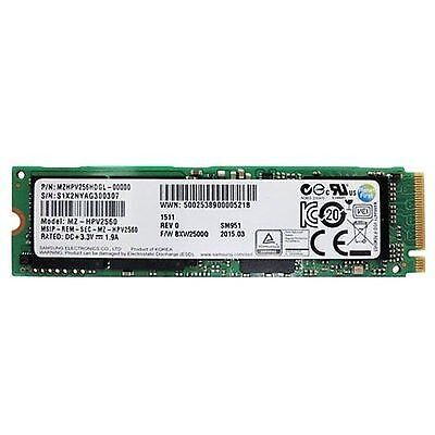

Samsung AHCI M.2 PCIe SSD models :
MZHPV128HDGM = 128 GB .
MZHPV256HDGL = 256 GB .
MZHPV512HDGL = 512 GB .
Use this adapter Sintech model ST-M2PCE4X :
There are three widely used AHCI PCIe drives with the M.2 format:
Samsung XP941
Samsung SM951-AHCI
Kingston Predator AHCI

XP941 seems the most compatible, even have a working TRIM. SM951-AHCI TRIM won’t work with macOS correctly

SM951-AHCI TRIM works until the drive is full, after that you have to boot single user and run a fsck -fy manually or the write throughput becomes around 200MB/s. For people that don't have a GPU with pre-boot configuration support, this become tiresomely fast.
