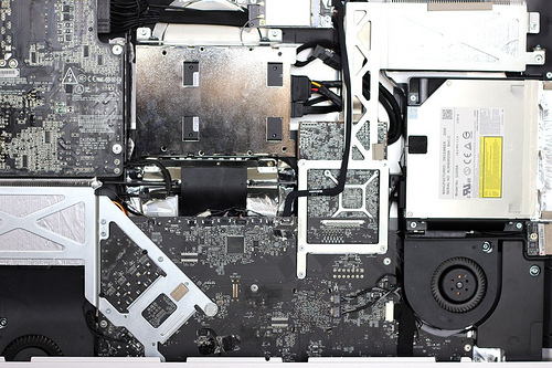

It took me quite some time to finally get this project off the ground, but my dream of cramming 1TB of SSD storage and a Blu-ray burner into an iMac has finally been realized.
I cracked open my 27" 2010 iMac yesterday and:
  • Installed a pair of 512GB Samsung 830 series SSDs (in a 2x2.5 to 3.5 adapter; replacing the stock Seagate HDD)

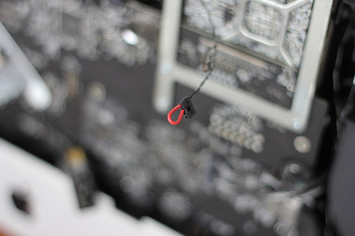

  • Shorted out the temp sensor in order to avoid full-RPM fans
  • Swapped out the stock optical drive for a Panasonic UJ-235a Blu-ray burner *
The end result? Damn, it's fast! Incredibly fast. Switching users and waking from sleep are where it's most noticeable. Those two actions are instantaneous; less than one second. Booting is, of course, very speedy. Loading up Final Cut Pro (which used to take a good 15 seconds) now takes approximately 3 to 5 seconds.
* I'm having problems with the Blu-ray burner and will need to open it back up to diagnose. It's failing to grab the disc and will only pull it in if I open Disk Utility on the iMac (odd, eh?). It may actually be that the eject button (which the stock optical drive does NOT have but the Panasonic DOES) is being permanently depressed in the iMac optical drive bracket.

An update:
That Panasonic UJ235 Blu-ray burner never functioned properly in the iMac (it works fine, however, in an external enclosure). As I mentioned before, it would not "pull in" the disc while installed in the iMac unless I opened disk utility (at which point it violently grabbed the disc). I think it's possible that the disc eject button on the drive was being depressed by the bracket in the iMac and causing the drive to malfunction.
So I thought I'd give it another try and purchased (for $150 on Amazon) a Sony Optiarc 5850 internal Blu-ray burner. I thought this was a safe bet given the fact that the "SuperDrive" I pulled out of the iMac was also a Sony Optiarc.
And, indeed, IT WORKED! But not without a little mod. Look up that drive and you may notice that it too has an eject button. At a $150 I decided the price was low enough to risk forcibly removing the disk eject button from the face of the drive. I used a small screw driver to bend away the metal plate surrounding the eject button. I then peeled the tiny button away from the drive and used a sharp knife to cut the VERY small ribbon cable running from the eject button into the drive. And that's it! I installed it in the iMac and everything is functioning beautifully.
I'm now enjoying a lightning-fast 2010 27" iMac with 1TB+ of SSD storage and an internal Blu-ray burner. I'd say I successfully "pimped my iMac."

I can report that I successfully performed this upgrade on my late 2009 27-inch Core i7 model.
It basically went as planned using Nathan's valuable advice, along with the iFixit guides. I took my time and also cleaned out the iMac with compressed air. The whole installation took about 3 hours.
I installed the Samsung 830 512MB SSDs in a 3.5 inch bracket, and then the Sony Optiarc BD-5850H. While I was at it I also upped the RAM to the full 16GB capacity. I didn't bother with shorting out the hard drive temperature sensor, but just installed the HDD Fan Control software instead, along with TRIM enabler (don't know if it's needed for the Samsung 830, but just in case).
The end result? Wow!! This is the iMac it was always meant to be. Everything happens instantly and now I can watch and burn blu-rays too. I no longer stare with envy at those new 'thin' iMacs. This has breathed new life into my old iMac for quite some time I think. :D
My thanks to Nathan for posting his experience and advice. Very valuable, particularly for giving me the confidence to cut the eject button and cable off the brand new optical drive.. it wasn't as complicated as I had feared.
I might must just add one small caveat for those attempting this on the late 2009 iMacs. The plastic bracket for the optical drive has a few small 'pins' that hold it firmly in place on the original pre-installed DVD drive. I found that the 5850H has minor differences in the outer casing, which means the plastic pins do not fit neatly into place, causing the bracket to protrude. I found that it was safe to simply slice off the small pins with a sharp knife, and then rely on the bracket screws and metal tape to hold the drive firmly against the bracket. Other than that, everything worked perfectly.
Thanks again Nathan. :)
