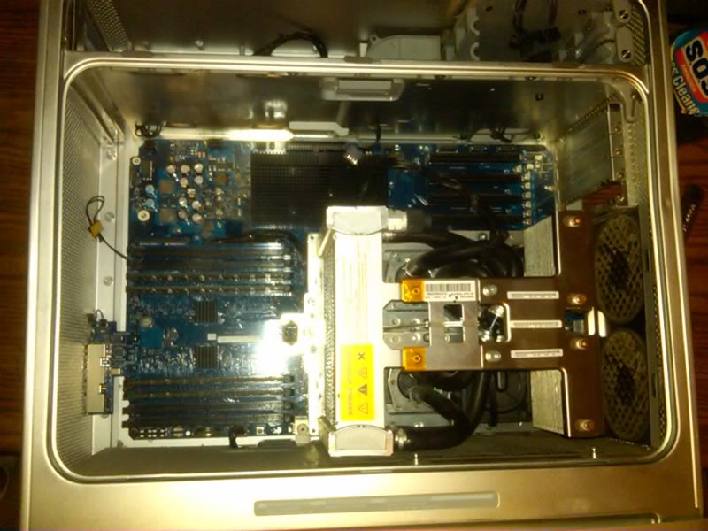

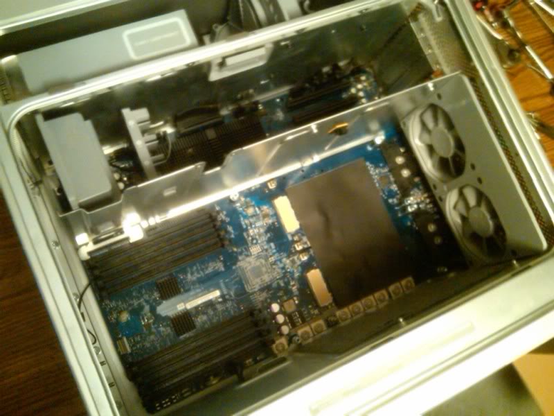

As the title suggests, I currently own a June 2004 2.0DP PowerMac G5. It is in MINT condition, and I love it to death.
A 2.5 Quad just hit Craigslist, but the case is a bit beat up. I would have no problem actually performing the swap, but my question is whether I would be able to swap out the back panel so the ports on the 2.5 Quad Logic Board would fit.
Can this swap be performed in my 2.0DP case, assuming I change EVERYTHING over from the 2.5Quad? (Including the PSU) If it can, you guys get a lot of pics. 😀

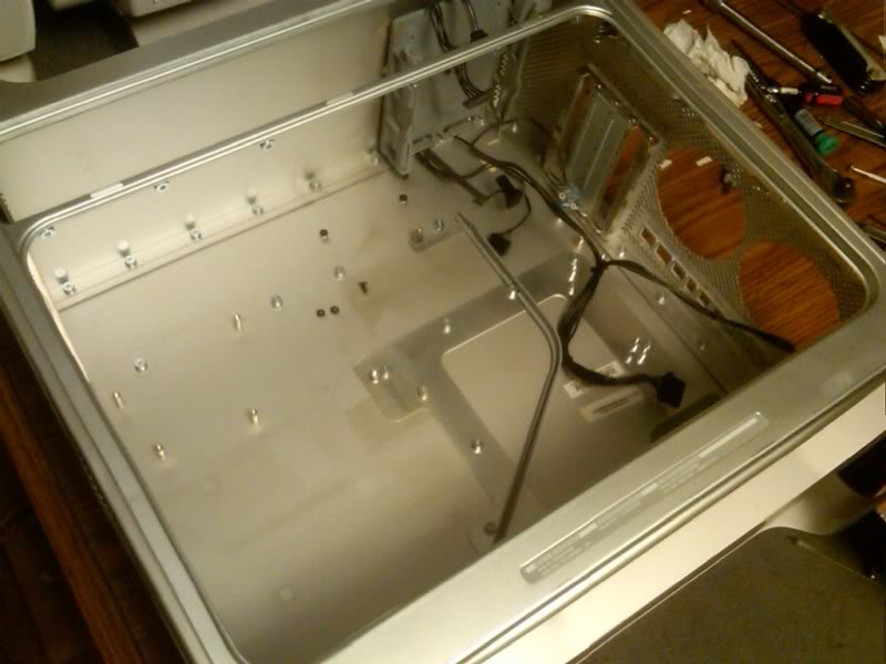

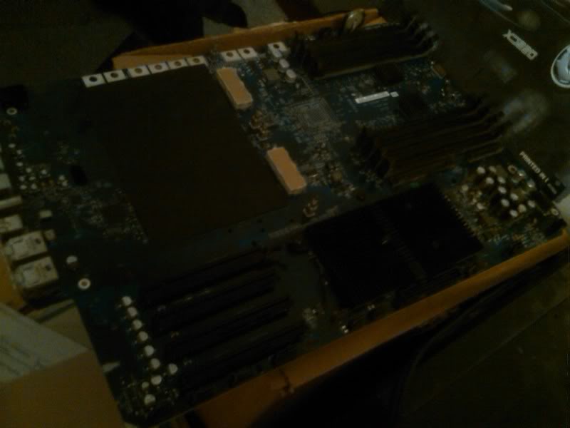

What I'm seeing inside my 2.0 are a lot of torx screws holding the frame and individual panels together. My main worry is that the 2.5Q Logic Board has different standoffs and screw holes than my 2.0. Comparing pictures of the two boards, they SEEM to use the same case standoffs, but the only way to be sure is to ask someone that's actually got experience with this.
Well, I purchased the 2.5 and started the teardown earlier tonight.

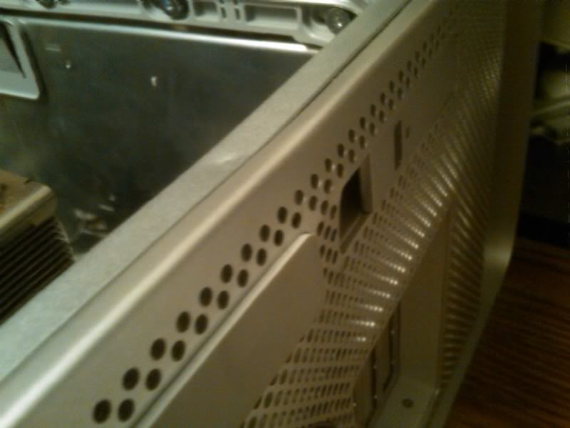

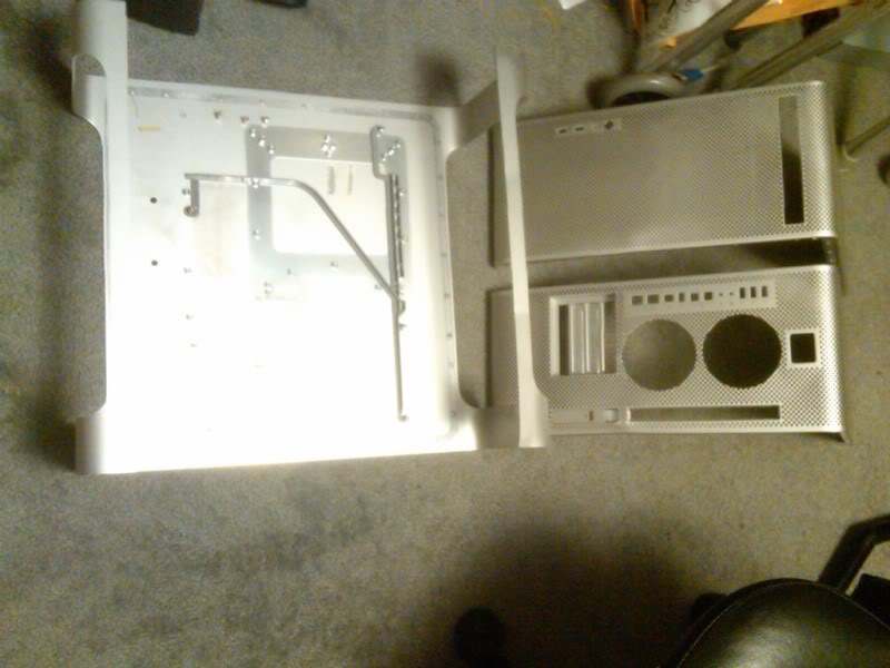

I'm tearing it down to the bone, and taking certain panels of the case apart. Gonna have to do some bodywork because the rear panel is dented a little bit. This case was transported to the US from London, and it shows.
It appears the case really is the same across the generations. The front panel I/O are different, but they can be swapped.
This failed. The motherboard standoffs are different between the two generations, based on images I've found on eBay.

Going to try and make the most of the beat up 2.5 case now unless I find a nice one on eBay I suppose.
Complete. I'll be fixing the dents carefully with a vise grip and a hammer. Hopefully I can bang them out a whole lot better than they were. It might be getting a new paintjob once I determine how well it cleans up.

How the heck did you disassemble the case itself?
I never found any screws in their to do that, neither in the G5, nor the Mac Pro.
There are a bunch of T8 Torx screws that hold it together. Once all the components are out, they LINE every seam of the case. There are probably about 18 6mm hex bolts as well.
On top of that, there were about 10 rivets I had to drill out of the panel that has the barcodes and serial number sticker on it. Quite the task.
I'm taking the pieces to my Uncle's house today to use his bench vise. Hopefully I can squeeze the metal into position. In any case, it'll probably be better than how I got it.

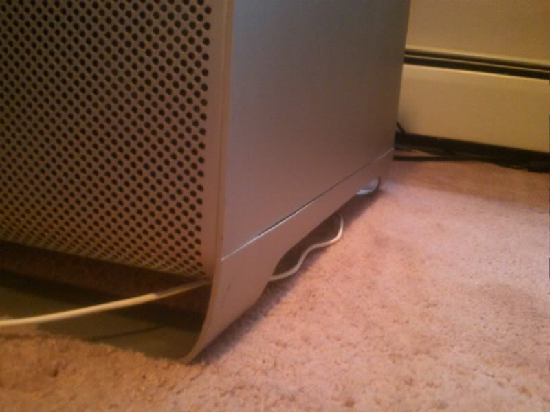

The front mesh took such a hit, that the superdrive door was stuck in the down position! The woman told me the Apple Genius "took" the door when he repaired it😀, she had no idea it was still there.
Looks like it took a serious hit or was dropped. Did you verify the machine still worked fine before beginning the tear down?

Yeah, when I picked it up she had it running and I tooled around with it.
Once I got it home I didn't even turn it on, just started the teardown and vacuum. The radiator was 100% caked in dust, no air could get through whatsover. I'm surprised it was running as quiet and cool as it did.

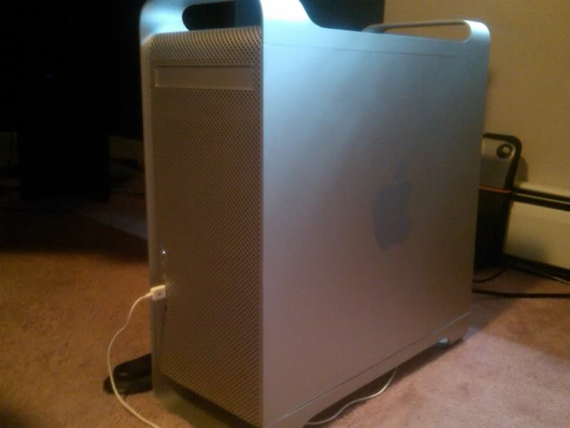

The case:

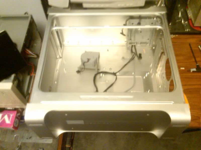

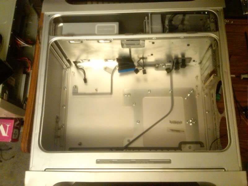

I just rebuilt it after getting home. The vise really straightened some of the panels great, and now the superdrive door works smoothly! The feet are essentially f*cked, but still a lot better than when I got the machine.
Well, I'm typing this from the Quad. 🙂 This thing is so snappy, wow. I'm gonna learn to love this thing very shortly I think.

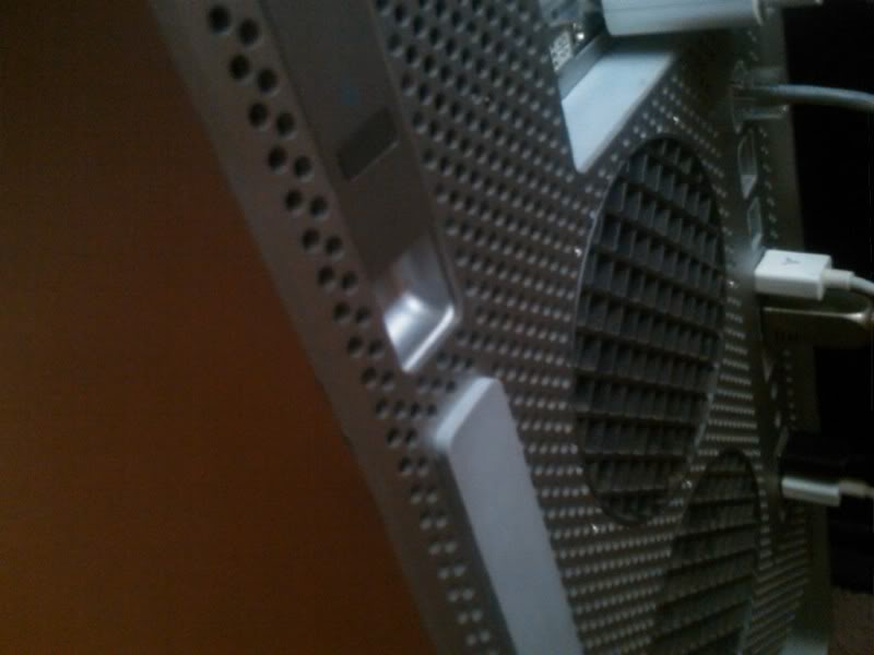

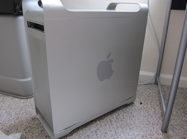

Done! Minor improvement to the base, major improvement on all the subtle bends you couldn't see on the camera. The panels are no longer bowed, and the superdrive door slides now!
Progress:

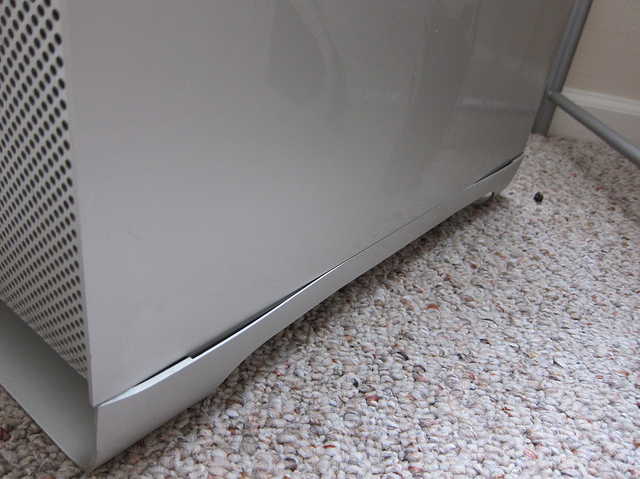

Exactly how did you straighten out the case? I've got a June 04 DP 2.0 that got some case modifications courtesy of FedEx that I would love to get straightened out, but I've never heard of a good way to do it.

I accidentally deleted the pictures of me straightening everything in a bench vise, agh! Basically, I would take the bent piece in the damaged area, and put half of it in the vise. The other half would be the straight unmolested metal. The vise would then correct the bend when clamped so it was significantly more straight. The thick aluminum such as the door and the outer shell were nearly impossible to straighten, while the cheesegrater portions were simple. A plastic hammer also helped straighten it once in the vise.
