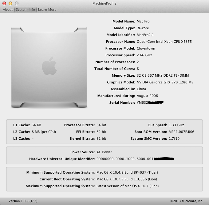

Whats the specs of the machine how many cores etc.
Edit: I am a dumbass did not look at the specs picture

Here's mine:
15sK8rb
