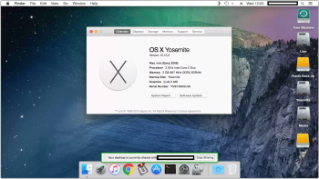

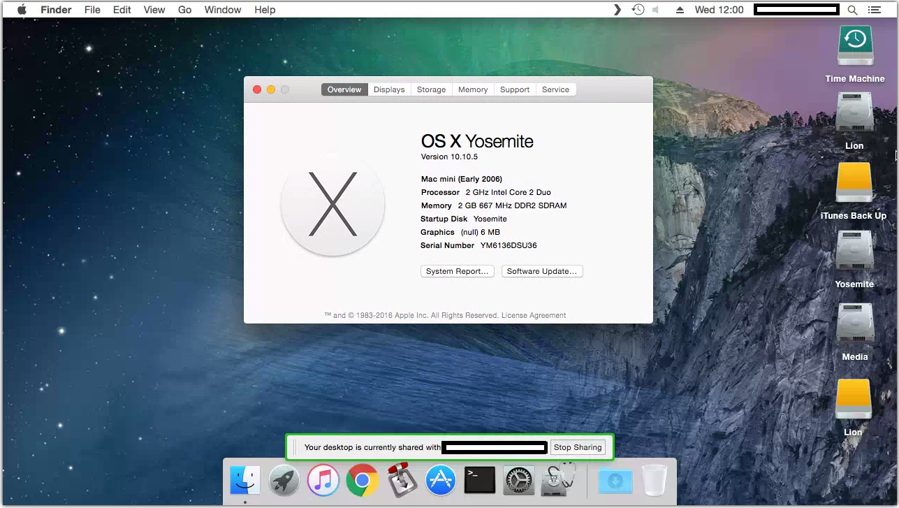

I first upgraded to Mountain Lion which installed successfully however there was an issue with no 64bit Kexts being available for the GMA950 on board graphics. This meant although everything ran, the screen would constantly flicker making remote connecting to the machine it was pretty tough to switch from windows and generally use the machine - there is no work around.
I thought i would give Yosemite and El Capitan a go with MacPostFactor to see whether the issue was the same, worse or better.
I started first with El Capitan 10.11 but the installation was repeatably unsuccessful, this was also the same with Mavericks 10.9 but Yosemite 10.10 installed without a hitch. Even better the graphics although not perfect were far improved, no flickering of the screen. The only issue were that animations although were not slow there werent very smooth. I could easily live with that!
So after spending £106.49 probably 10 man hours in total (most of which is research, tasks above is probably only a total of 3-4 hours) i have a 2006 Mac Mini running 10.10, with the latest version of PMS and iTunes which i can connect to via Chrome Remote Desktop perfectly.
