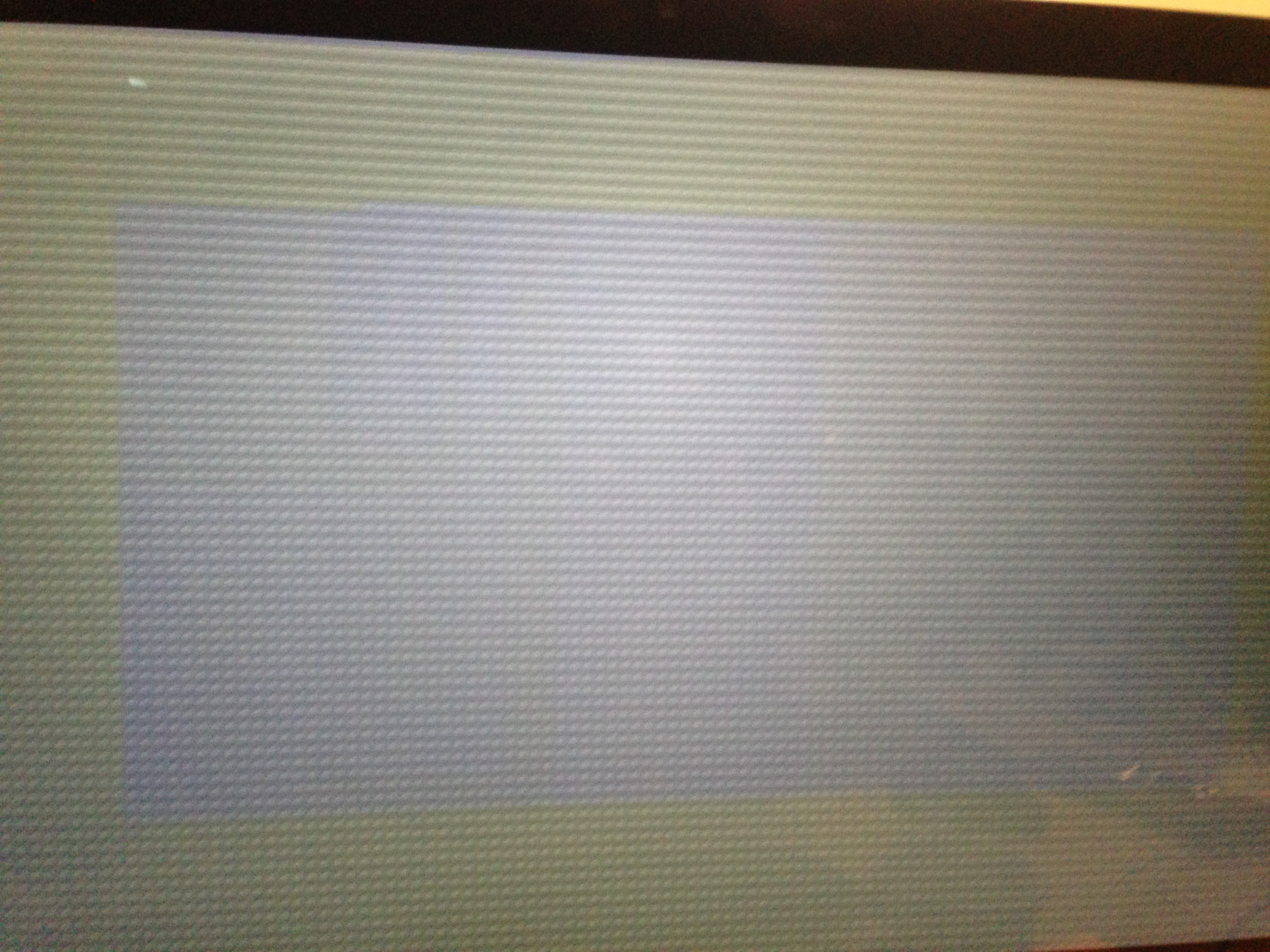

The iMac I had at work definitely didn't exhibit the IR until it warmed up under normal use. I first noticed the issue while installing applications. (I ignored it at first, hoping it would go away.) If the replacement unit also has IR, I will try to get temperature readings. My ambient office temperature is usually between 73 and 77 degrees (F).

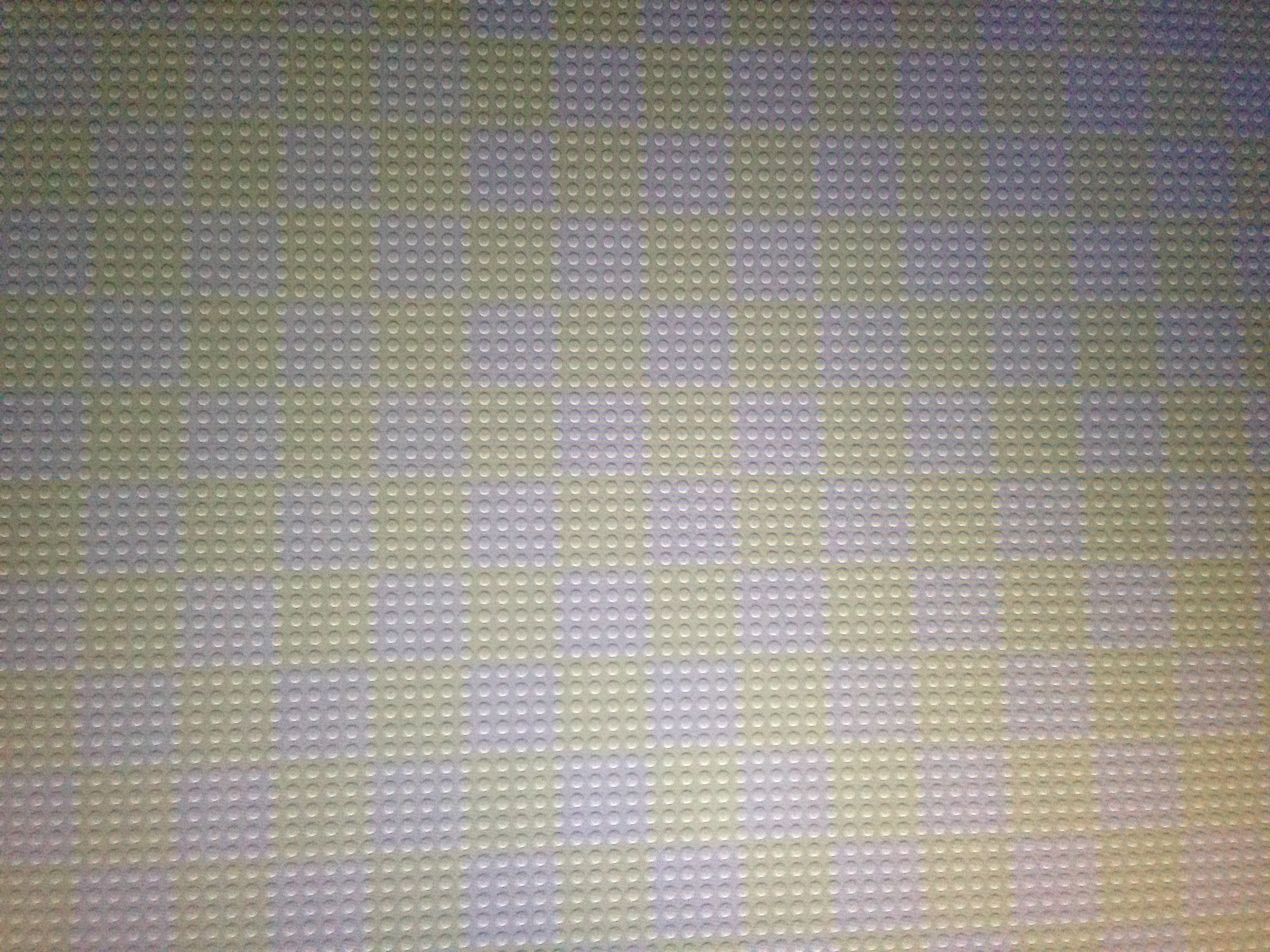

Here is another photo I had taken:
IR of Checkerboard Pattern

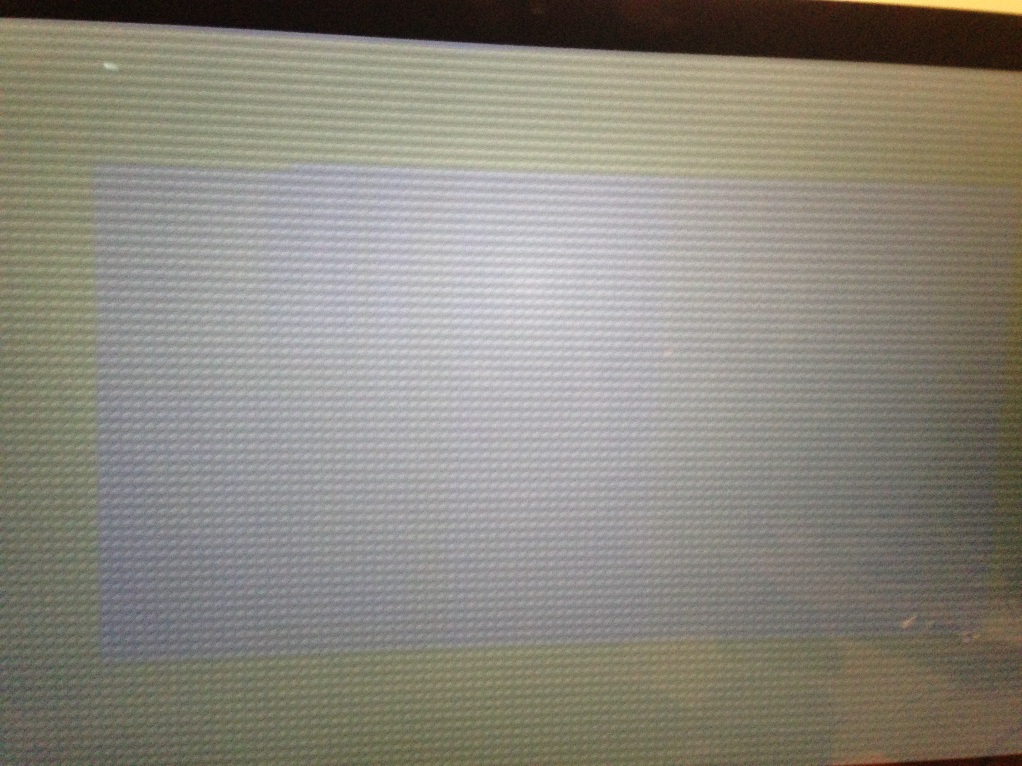

Previously posted:
Youtube Video of IR
Test Image
IR of Test Image
Zoom 1
Zoom 2
No IR here either. Tried to heat it up as much as possible but no even a little bit of IR.

Today the image retention was very bad, which is strange because yesterday I never noticed it. Today browser and email windows are being retained very quickly. Even keeping a web page open for 5 minutes results in a phantom of the window I closed. With the difference between yesterday and today, it makes me wonder if it is heat related. I don't feel any heat when I touch the back of the iMac, though.

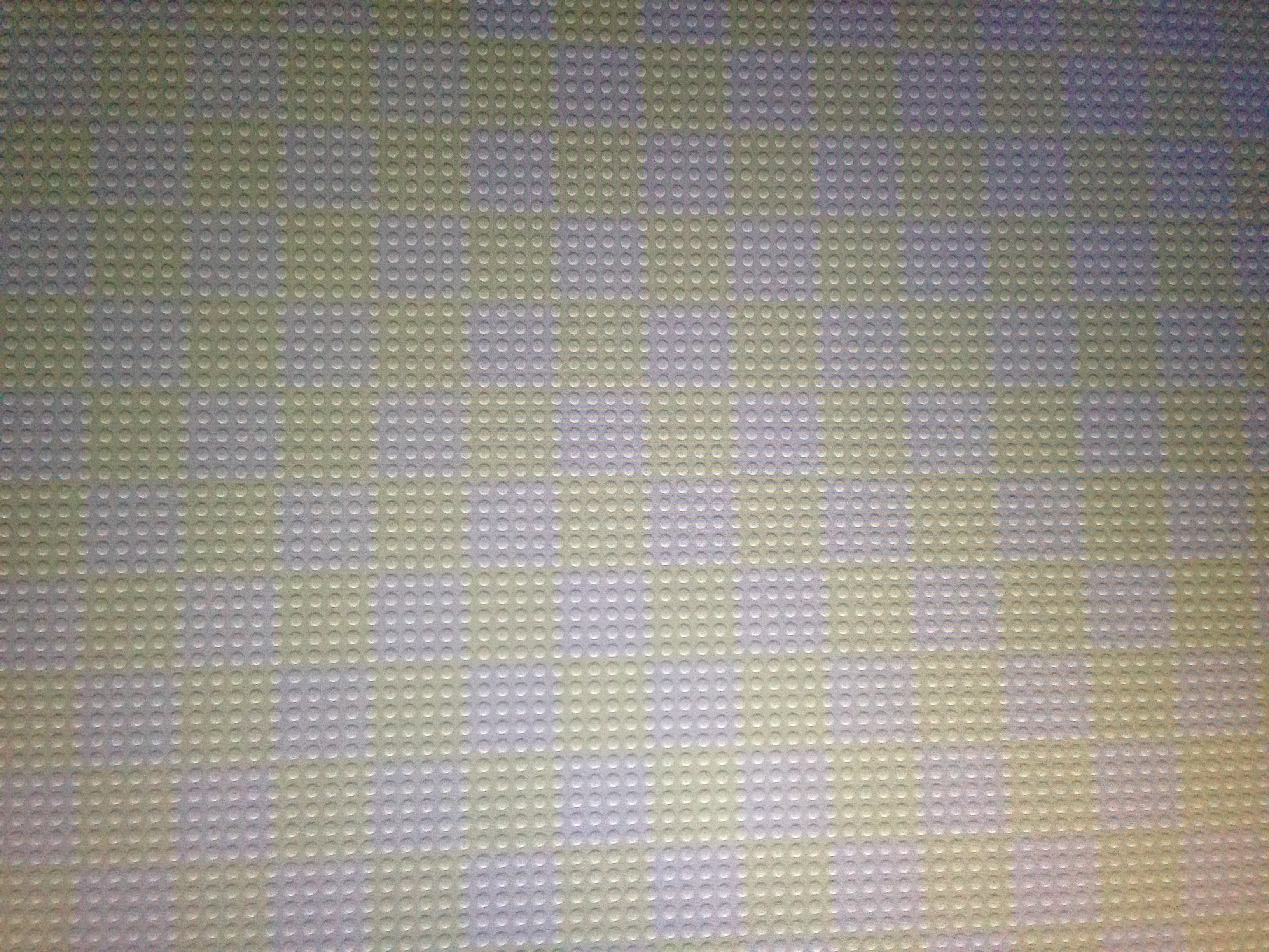

I ran the grid pattern again and in 10 minutes it looked very different than when I did the test last night. Last night it seemed to only show up on the bottom of the screen, but today the pattern can clearly be seen over the whole screen, and it is taking a while to go back to normal after doing the 10 minute test.
Something else I'm noticing is that on a completely grey screen I can see a faint vertical lines at all times, even after the image retention has faded. I've never noticed that on displays before. You can clearly see the lines in the right side of the picture below.

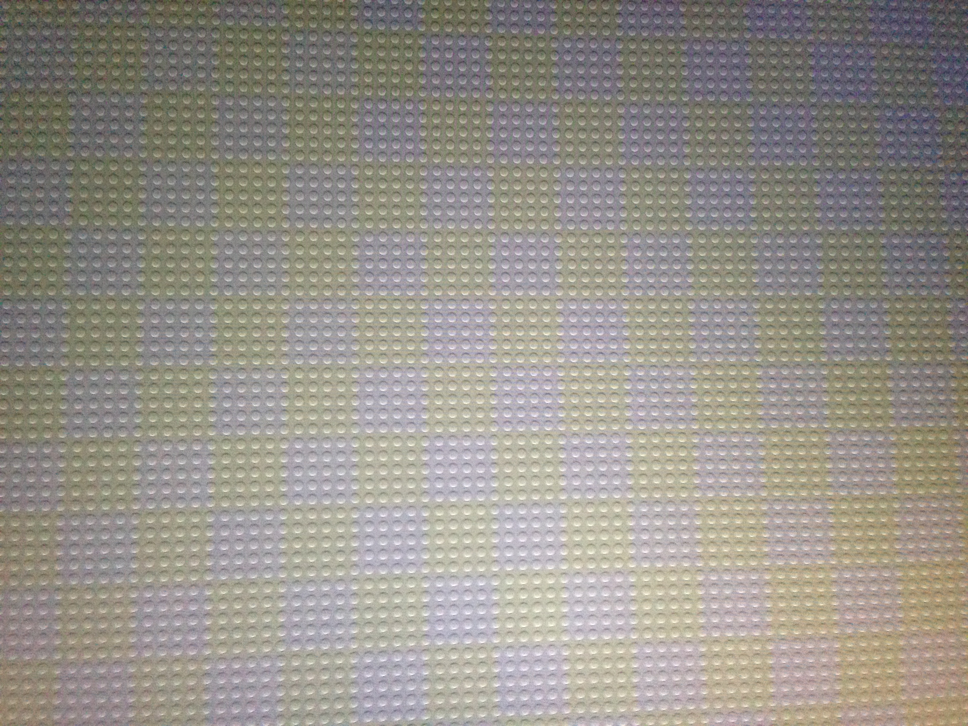

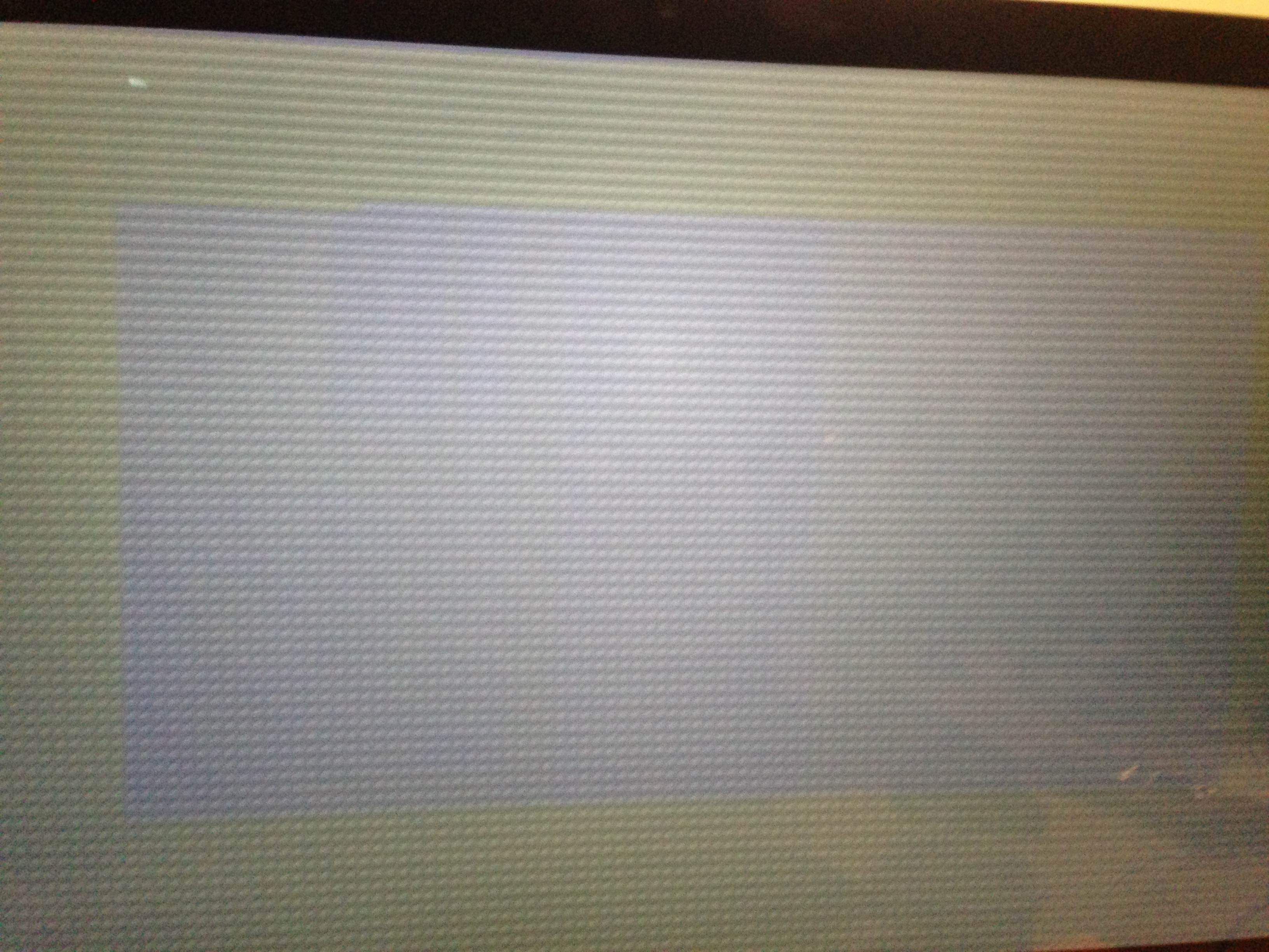

My new imac seems to have bad retention, if I leave a document open for 10-15 minutes I will then be able see an the imprint for several hours.
Please see the attached images.
I think I may have to return this imac.
