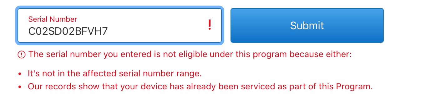

If it is the original battery, it might be eligible for the replacement program due to the recall. Check you serial number here to see if Apple will replace it for free! https://support.apple.com/15-inch-macbook-pro-battery-recall
its not
