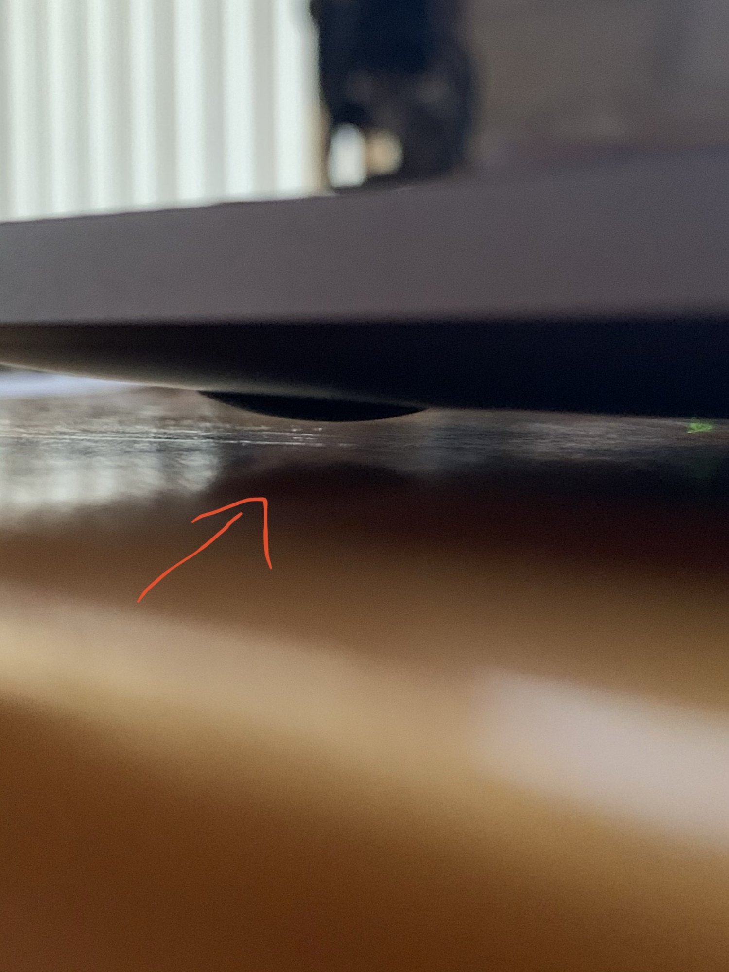

I hit apple support up. They just said I need to take it in to get it looked at and they suspect the battery. LHS foot in the image... RHS is similar. Laptop is nearly 2 years old. Does the swollen battery normally break or require other parts to be replaced as well? Anyone know rough cost?
Often, damage to the top case caused by a swollen battery is just charged as a battery replacement if not covered under warranty, so it’d be the $199 price. Otherwise the top case replacement would probably be in the $5-700 range.
