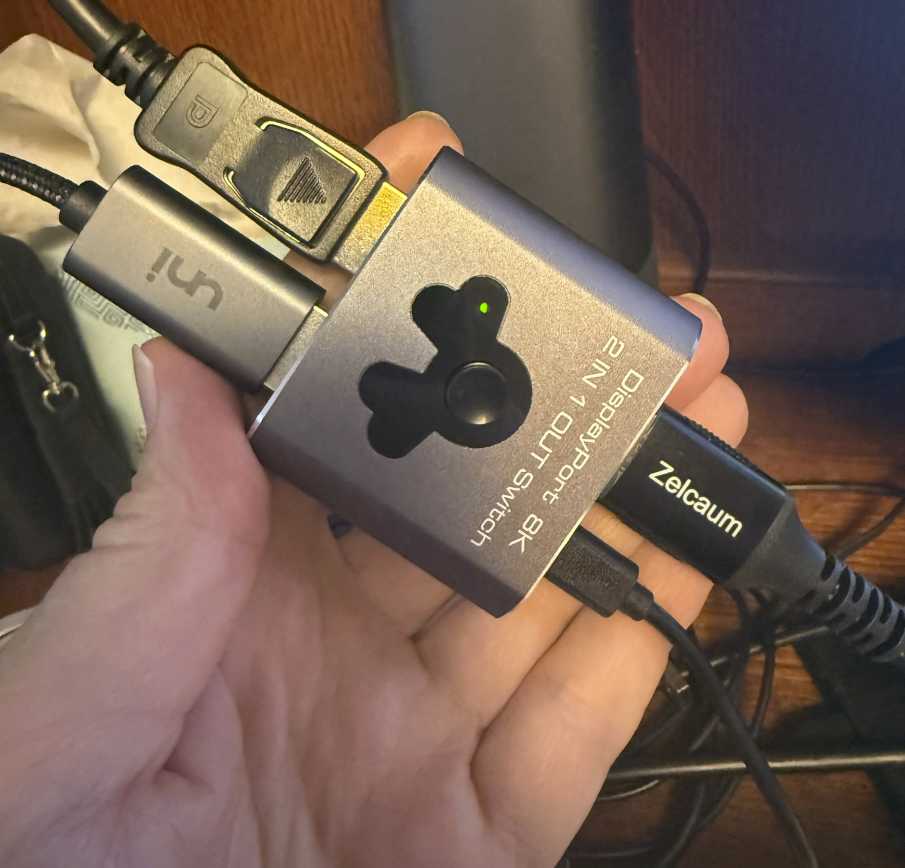

Maybe I should get a powered DP switcher, and a Thunder-to-DP adapter, and use the HP's DP input instead of the HDMI--I want to switch between the Mini and my Windows machine...

To put a ribbon on this, I got a powered switch and cables and once I plugged the 2nd "uni" cable into it properly (!) it worked great. Upper cable is to this Windows PC and lower is to one of the Mac Mini USB-C/tbolt ports. The switch works better than the HP's own "Source" switch as it's noticeably quicker in operation. Thanks everyone.
