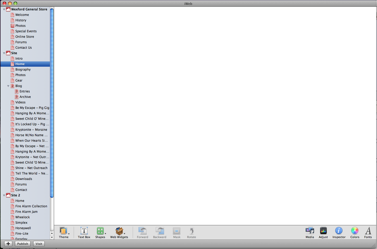

Just a few minutes ago, I pulled up iWeb to work on my band's website, only to find that it's nearly all gone. 😡 Only one page of the site remains, and everything else just shows a blank screen. When I try and publish it to a folder, it gives me "Publishing error, an unknown error occured." I simply can't have this happen. This website has taken me over a year to create, and now it's trashed. Where does iWeb store the website? Is there some way I can get it back? I've tried everything, but have had no luck. 🙁

Stupid question: Do you have a backup? E.G. Time Machine?
If the website is online, then you can save the HTML pages.

Ok I did a little digging with my tripwire software. It saves the site in this directory.
~/Library/Application Support/iWeb/Domain.sites
on my machine. Easiest way to get there, go to Finder, cmd-shift-G, and copy-paste that exact path into the dialog box. Find your file and dbl click to open it.
Edit: Go the store. Buy an external hard drive. Turn on time machine. Do it now.
