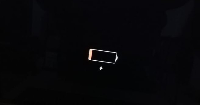

I got my brand new Mac Pro 16 inc 2019 today, When I unbox it and try to turn it on the display shows that the battery is empty (Red empty battery icon).
I plug the charger to the wall and to my Mac (usb-type C) try to turn it on again, it shows the same icon and won't to turn on.
I leave it connected about 2 houre then try to turn it on but unfortunately same thing.
Any help :(

Sounds like it might be DOA. If you have another power adapter that you could try I would give that a shot. Otherwise you're probably going to end up having to send it back to Apple for a replacement.

Definitely second the idea of trying a different charger if you have one. I would also suggest an SMC reset. In the machine’s current state, I think you can only do the first step of the procedure linked below which is hold the power button for ten seconds.

+1 on the SMC reset.
Also, if it was completely dead it’s still going to need a certain charge threshold before it will turn on for you even when plugged in.
Do the SMC, unplug and plug it back in, give it 20 minutes to ensure a minimum charge is reached. Try to boot and let us know how it goes.
I know the machine has been connected for 2 hours, but the key here is to do the SMC THEN let it charge for a bit.
I try the steps but nothing happens, I will try to find another charger to test it.

I tryied to SMC reset then follow your steps but still the same, tring another USB-C charger (Mac Air) but nothing change the device still won’t turn on ?
