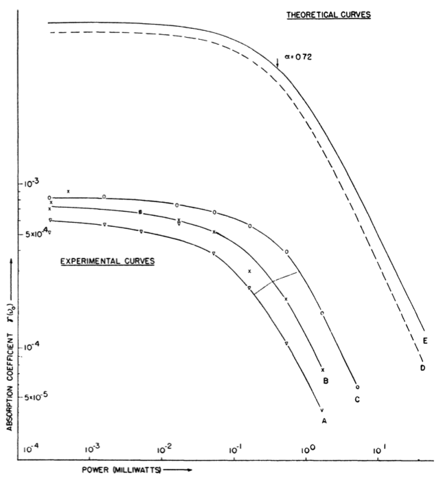

1) There is a saturation effect, wherein whatever is causing the detuning in your hand (water, proteins) can be saturated for sufficient power levels. In other words, when the microwave power is high enough, your hand becomes "transparent" to the phone. Here's an old example of this effect with ammonia (accessible through most universities):
http://prola.aps.org/abstract/PR/v73/i9/p1053_1
The crux of what I'm referring to (the x,y scales will of course be different for different molecules and frequencies) can be seen here:
