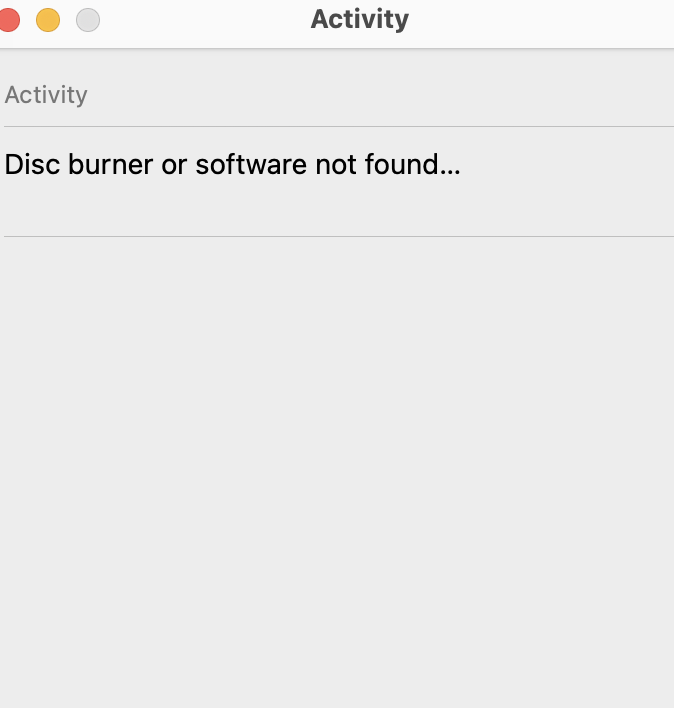

I tried it again and it recognized the burner once and I tried to burn after it asked for a blank disk it started spinning than I thought it was complete but came out no good
Tried again and again can't get it to recognize it again Screenshot 2023-06-10 at 2.40.38 PM.png
