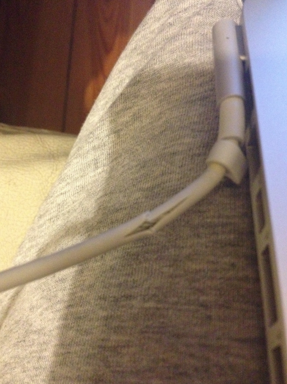

My charger wire has split, is it safe to tape?
Hi,
So I'm using a Macbook Pro with its original charger, I've had my Macbook Pro for about 2 years now and the charger wire has developed a split. None of the insides are poking out and if I bend it straight, the slit closes up neatly. I am aware that replacement chargers are fairly expensive so I was wondering if it would be safe to use a tiny bit of duct tape around the slit (Once its aligned) would be safe to carry on using?

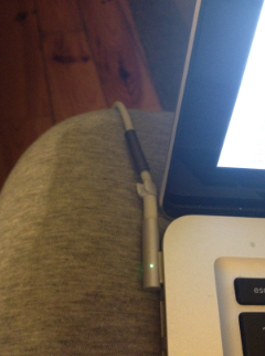

I would use electrical tape and it should be fine to use. But, you may want to take it to the Apple Store. They may replace it for you.
Electrical tape is different from duct tape.
My then kitten chewed into the cord on my daughters charger just over two years ago. The wires were fine, just the tubing was split. I put electrical tape around that and it's still working fine (knock wood).
Duct tape is usually silver and has a nylon webbing to it. Electrical tape is black and will insulate the wire. Actually, if you have a hardware store nearby, you can probably find a white electrical/insulating tape and then it will not be so noticeable.

But will Duct Tape be ok? I googled and there doesn't seem to be much difference apart from insulation. I don't really want to wait a few days to get electrical tape and would rather it be fixed now so would it be ok to use the duct tape I have?
I decided to use Duct Tape in the mean time but I'll be buying a new charger probably in a few weeks.
Don't use duct tape for this. Electrical tape is flexible and will stretch for tight wrapping. The best tape is 3M/Scotch. It's more expensive, but I recommend it over cheaper brands.
When you wrap, start about an inch from one end of the slit and pull on the tape to stretch it while wrapping in a spiral with an overlap of half the tape width. Continue to about an inch beyond the slit. It would help if someone could hold the cable taught while you wrap.
