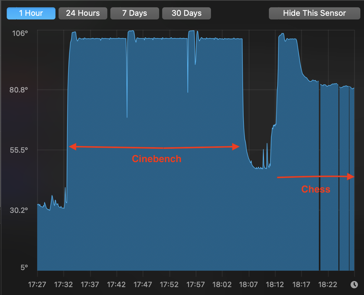

I decided then to drop the fans idea (wife was complaining) and just use it normally with my chess engine running full bore. I particularly wanted to see what the CPU temps did over time. This was a surprise too. They started out at 102-105, same as the Cinebench test, but after about five minutes dropped to about 80C, but CPU was still high.

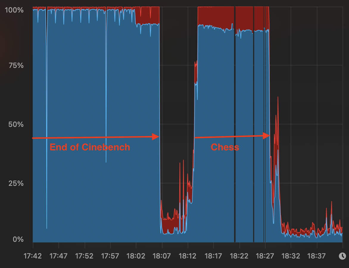

The CPU % and CPU Core Average temp plots from iStat are below. Red is System, blue is User. So it looked like the User CPU dropped for last two runs, corresponding to the extra drop in Cinebench score. The Chess phase looked like it never had 100% user. And note that the sharp drop in CPU temp occurred at 18:17, but there is no corresponding change in the CPU used.

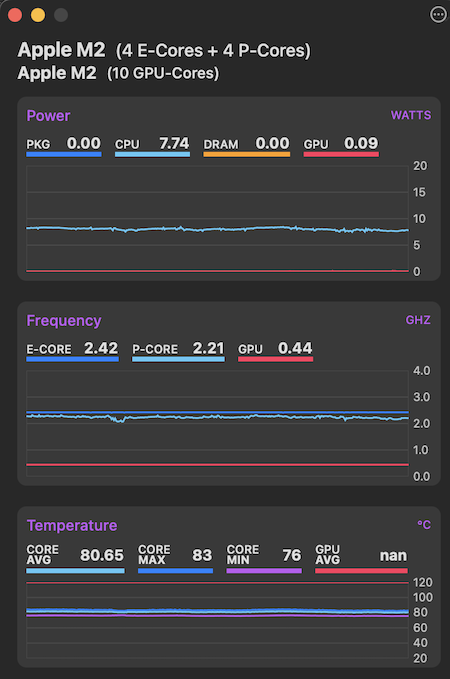

I have been doing some more extended testing with my chess engines and, together with the Cinebench testing, feel I have a reasonable understanding of how the machine behaves under this load, which I will do maybe once a fortnight, and am quite happy with the conclusions.
1. The machine protects itself by limiting the CPU core average to about 80C after 5-6 minutes, and stays at that level. (at least for 40 minutes I ran). It takes about 20 mins to slowly drop to 80C, faster initially.
2. Peak performance at the very start is e-core 2.4GHz, p-core 3.2Ghz
3. Fully throttled performance is e-core 2.2GHz, p-core 2.2Ghz (see screenshot of Mx Power Gadget after 30 minutes running)
4. The performance at the fully throttled state is about -15%, deduced from Cinebench CPU testing. (This is faster than my 2017 iMac 3.5GHz, which I had until M1, then M2 MBA, replaced it).
During the return period for my M2 MBA, I have thought about returning it for a 14" M1 MBP, but not any more. I could have more chess engine capability with a cooled MBP, but I am happy to have the advantages of the M2 MBA and give up the extra performance. Magnus Carlsen would probably have gone the other way 😉

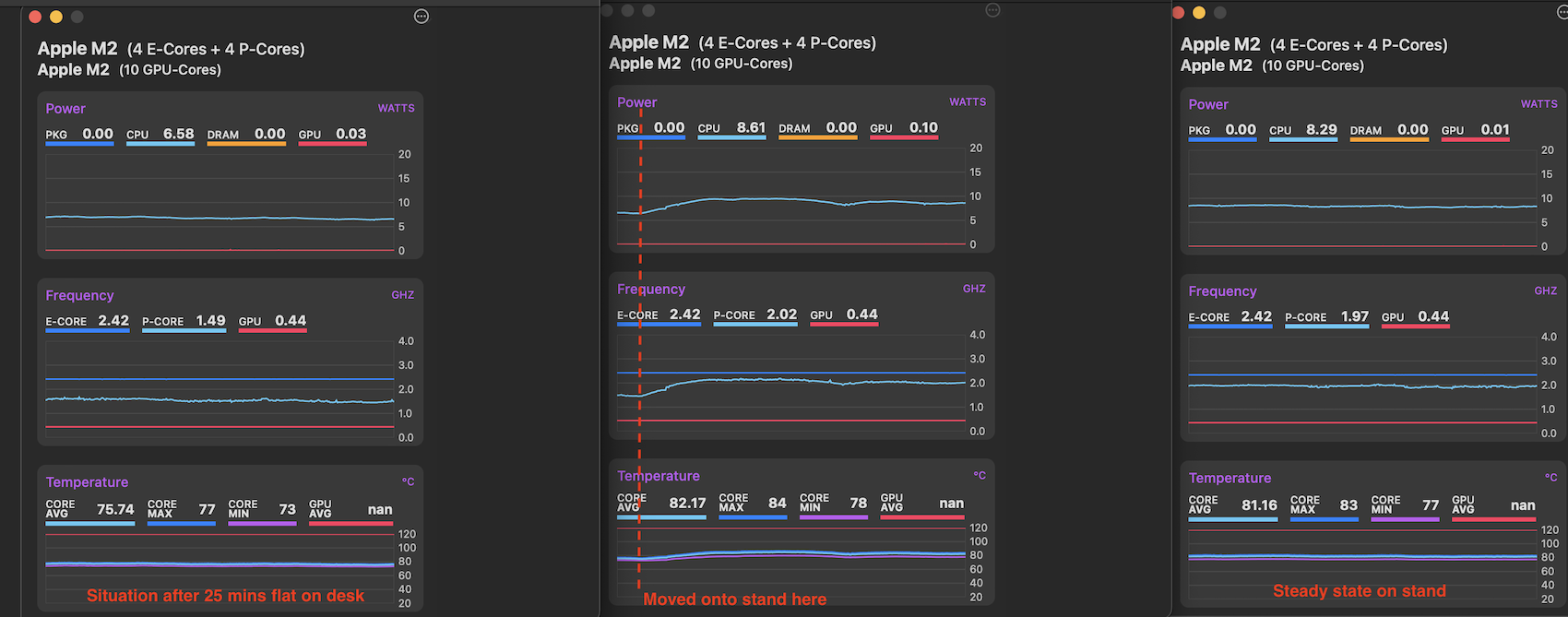

EDIT The above chess engine numbers have been done with the M2 MBA resting on an ordinary open back laptop stand, no fans. Prompted by @jdb8167 's post I am repeating with the M2 MBA flat on a wooden desk. The results are different. I did the original Cinebench test with Mac on wooden table.
Reactions: jdb8167
The steady state p-core values I see are:-
Flat on wooden desk 1.49 GHz
After putting on stand 1.97 Ghz
NB the 1.97Ghz should have been the same value as in my previous post ie 2.21Ghz but it never got there.
Anyway conclusion is that raising it up off the desk does make a difference, even without a fan.
