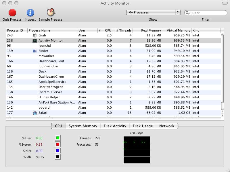

    It's normal for the CPU to heat up during those kind of conversions and graphic applications. TO make sure it isn't doing this with no load on the CPU, open Activity monitor and check for which applications are using the processor. When those stop, do the fans still continue?

    first the is cpu b and i only have 1 cpu which i guess it should be cpu a
    second i've took a picture of my activity monitor to let know everything, and this picture is after the shut down i made.
    i hope that my issue is cleared :D
