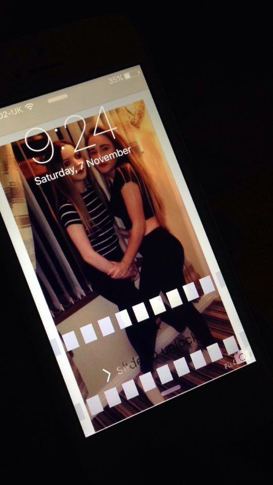

Do they look anything like this?

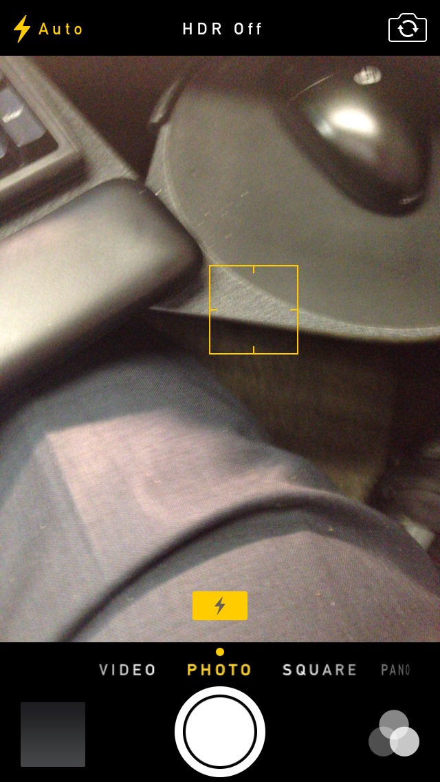

it sounds like he has the grid lines turned on for the camera app. Go to settings> photos & camera. down near the bottom , there is the option to turn the grid on/off
Reactions: Merkie
I completely forgot about this option as I never use it.
I think you've got the answer, here.
