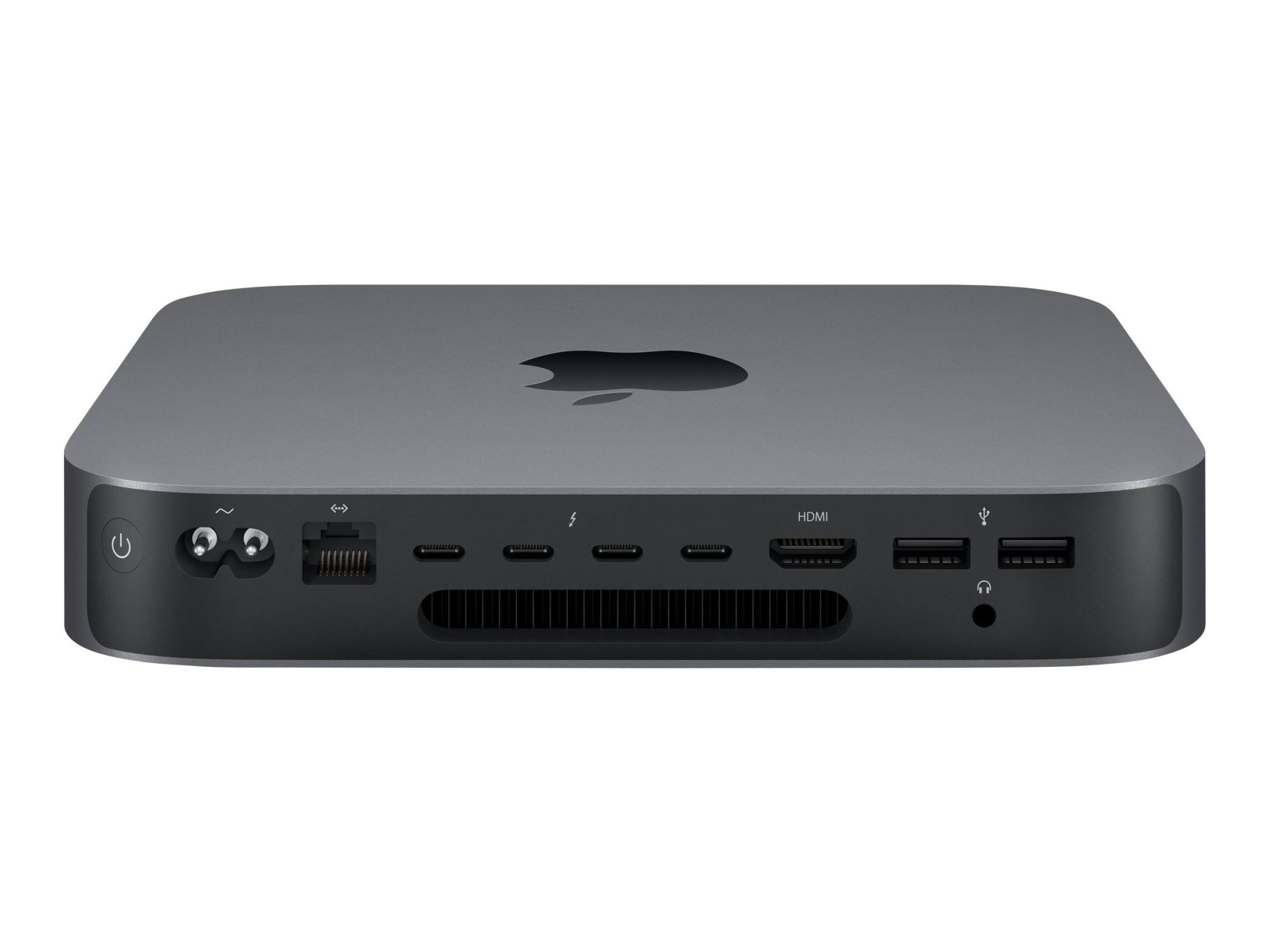

There is nothing plugged into my HDMI port. Looks like my monitor is plugged into one of the thunderbolt ports?

How does that plug into the 2018 Mac mini, which has HDMI and USB-C video ports?
You need to connect the HDMI or USB-C (which is DisplayPort through a USB cable) port on your computer to the VGA port on the monitor via whichever cable you choose and the appropriate VGA adapter.

It's plugged into the third port from the ethernet port, which I believe is one of the four thunderbolt ports? It is a direct cable into the monitor with no adapter.
There is nothing plugged into the HDMI port

Daisy-chaining a DVI-to-VGA adapter to a USB-C-to-DVI adapter does not work. DVI-to-VGA adapters don't actually convert the signal, they just tap into the analogue signal that a DVI-I ("integrated", i.e. analogue and digital) or DVI-A ("analogue only") output carries. If there is no analogue signal to begin with, such as with a DisplayPort/HDMI/USB-C to DVI-D ("digital only") adapter, it won't do a thing.
This or a HDMI-to-VGA adapter are your (only) options, @steve333.
It would be just connecting the DVI to VGA adapter to the DVI to usb-c cable I have, that wouldn't work?
I was thinking maybe the usb-c to VGA cable might work better though since it is direct without need for an adapter?
It wouldn’t.
Yup.
