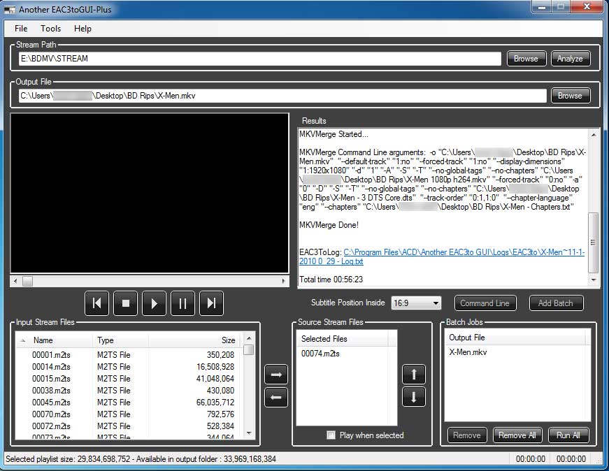

I notice I can't play the preview in EAC3to GUI. I figure I need a codec of some sort. Could that effect my MKV and make it non-playable?
Yeah. Failed again.

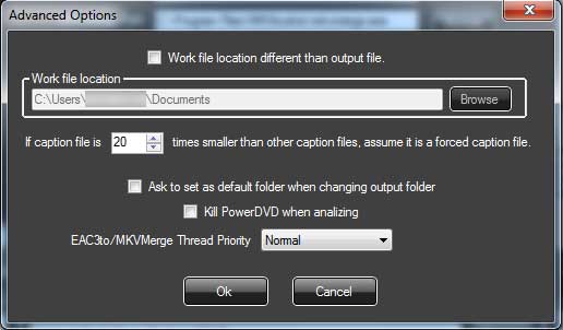

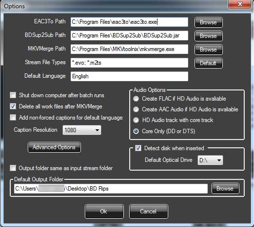

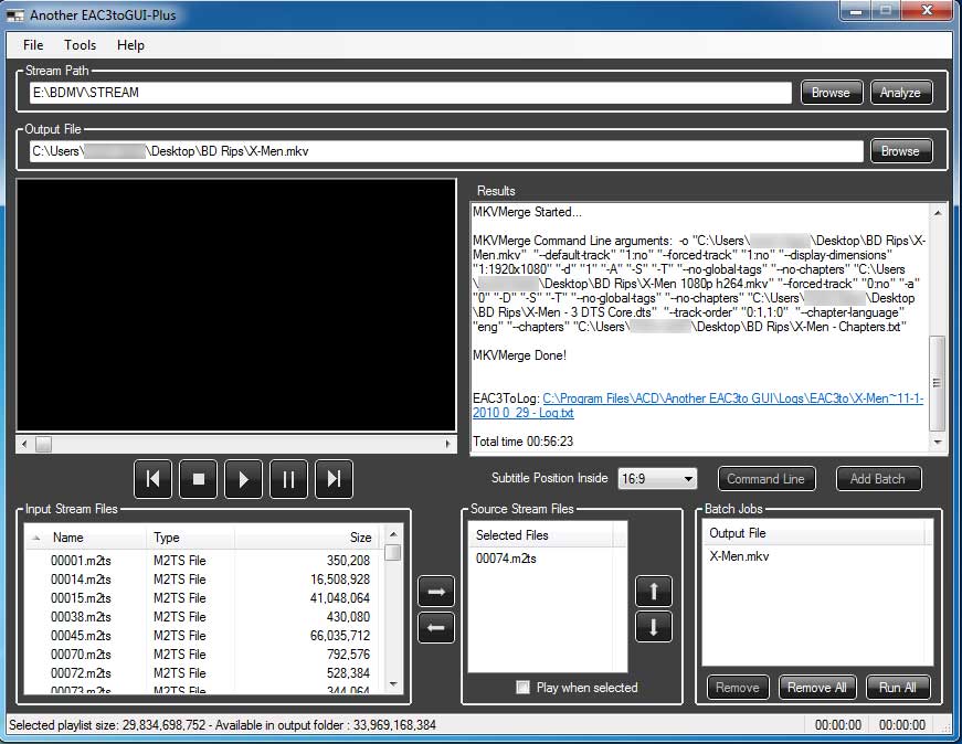

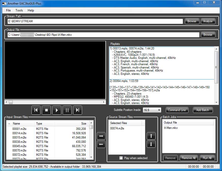

I'm going to run it again tonight and save the error log this time. In the meantime, here are the settings I use that seem to be failing.
Any ideas based on this info?

Looks like my log file is still there after all...
eac3to v3.24
command line: "C:\Program Files\eac3to\eac3to.exe" "E:\BDMV\STREAM" 1) 1: "C:\Users\My Username\Desktop\BD Rips\X-Men - Chapters.txt" 2: "C:\Users\My Username\Desktop\BD Rips\X-Men 1080p h264.mkv" 3: "C:\Users\My Username\Desktop\BD Rips\X-Men - 3 DTS Core.dts" -core 9: "C:\Users\My Username\Desktop\BD Rips\X-Men - 9 English Subtitle.sup" -log="C:\Users\My Username\Desktop\BD Rips\X-Men - Log.txt" -progressnumbers
M2TS, 1 video track, 6 audio tracks, 7 subtitle tracks, 1:44:20, 24p /1.001
1: Chapters, 40 chapters
2: h264/AVC, 1080p24 /1.001 (16:9)
3: DTS Master Audio, English, 5.1 channels, 24 bits, 48kHz
(core: DTS, 5.1 channels, 24 bits, 1509kbps, 48kHz)
4: AC3, English, 5.1 channels, 448kbps, 48kHz, dialnorm: -27dB
5: AC3, French, 5.1 channels, 448kbps, 48kHz, dialnorm: -27dB
6: AC3, Spanish, 5.1 channels, 448kbps, 48kHz, dialnorm: -27dB
7: AC3, Portuguese, 5.1 channels, 448kbps, 48kHz, dialnorm: -27dB
8: AC3, English, 2.0 channels, 224kbps, 48kHz, dialnorm: -27dB
9: Subtitle (PGS), English
10: Subtitle (PGS), Spanish
11: Subtitle (PGS), Chinese
12: Subtitle (PGS), Korean
13: Subtitle (PGS), Chinese
14: Subtitle (PGS), Portuguese
15: Subtitle (PGS), French
Creating file "C:\Users\My Username\Desktop\BD Rips\X-Men - Chapters.txt"...
[v02] Extracting video track number 2...
[a03] Extracting audio track number 3...
[a03] Extracting DTS core...
[s09] Extracting subtitle track number 9...
[v02] Muxing video to Matroska...
[a03] Creating file "C:\Users\My Username\Desktop\BD Rips\X-Men - 3 DTS Core.dts"...
[s09] Creating file "C:\Users\My Username\Desktop\BD Rips\X-Men - 9 English Subtitle.sup"...
Added fps value (24 /1.001) to MKV header.
Video track 2 contains 150097 frames.
Subtitle track 9 contains 747 captions.
eac3to processing took 50 minutes, 9 seconds.
Done.
Not recognized in the nightly build of handbrake or in VLC.

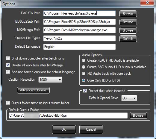

So I have been spending the last week playing around and have learned a few things.
1) Just an important note, if you choose the option HD Track with Core track, it leaves the DTS-HD track intact and if you go to convert that MKV in handbrake and convert the DTS-HD to AC3 using a nightly, it will fail with a DCA-Syncinfo. Any DTS-HD blu ray must have the DTS-HD track converted to AC3 before handbrake or you have to choose the Core only option so only the 5.1 DTS track is extracted. If you feed a 1080P MKV with only a DTS (not DTS-HD) track into Handbrake then you can use convert to AC3 option in Handbrake.
2) Another EAC3to seems to be inconsistent in how it handles conversion/decoding/encoding when you choose the Core only option. When it comes to TrueHD files, there doesnt seem to be an issue all the way through the process to MKVmerge. But with DTS tracks its more problematic.
3) Compared to Clown_BD, one nice option to available in Another EAC3to is to take a slightly less automated approach by demuxing all the appropriate files (Video stream, audio, chapters, and subtitles if applicable) similar to Clown but also taking advantage of Another's capability to auto convert the subtitles so you end up with files ready to be muxed using MKVmerge (in Clown, you have to manually feed the subtitles into Bdsuptosub).
MiS, try this. Update your version of MkVtoolnix to 4.4 (uninstall 3.3 and install 4.4). Then, open up the MKVmerge gui (mmg.exe) and go under options in the menu and make sure you choose the option to disable header compression by default. Close out.
Lastly, make sure every app you use (EAC3to.exe, all the mkvtoolnix apps, another eac3togui, halli) has the properties set to always run in admin mode. Then make sure that your UAC settings are set to the lowest (all the way to the bottom). Restart your computer.
Run X-men again, same options you had choosing core only. Only this time make sure that the option to delete work files when mkvmerge finishes is unchecked (so the work files remain; important if this process fails again because we will manually feed mkvmerge your files as a last test). The big thing is that after eac3to is done, the mkvmerge process should start and take 15-20 mins. If eac3to finishes, mkvmerge starts but then the process says completed - similar to what your log says - then mkvmerge did not work.
let me know.
