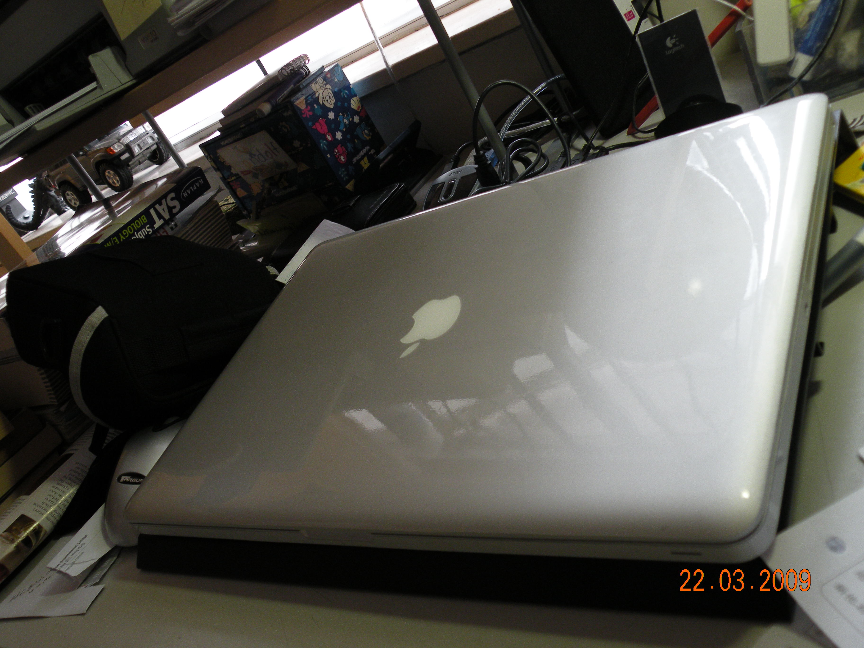

The hardest films to apply: cover, bottom, and palm rest flim

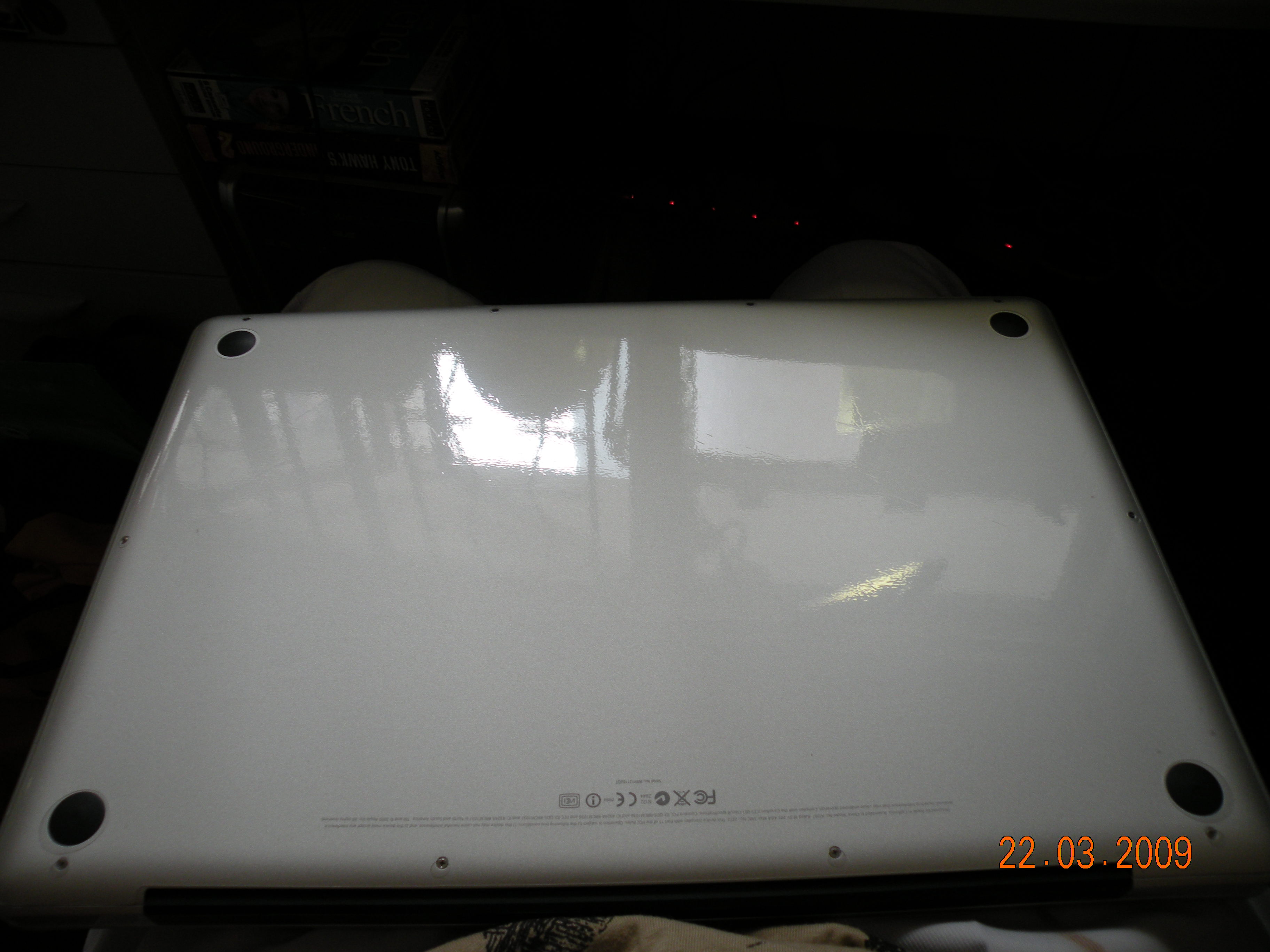

FYI, this shield does not cover the entire bottom of the MBP, it only goes up to the edge of the bottom lid.

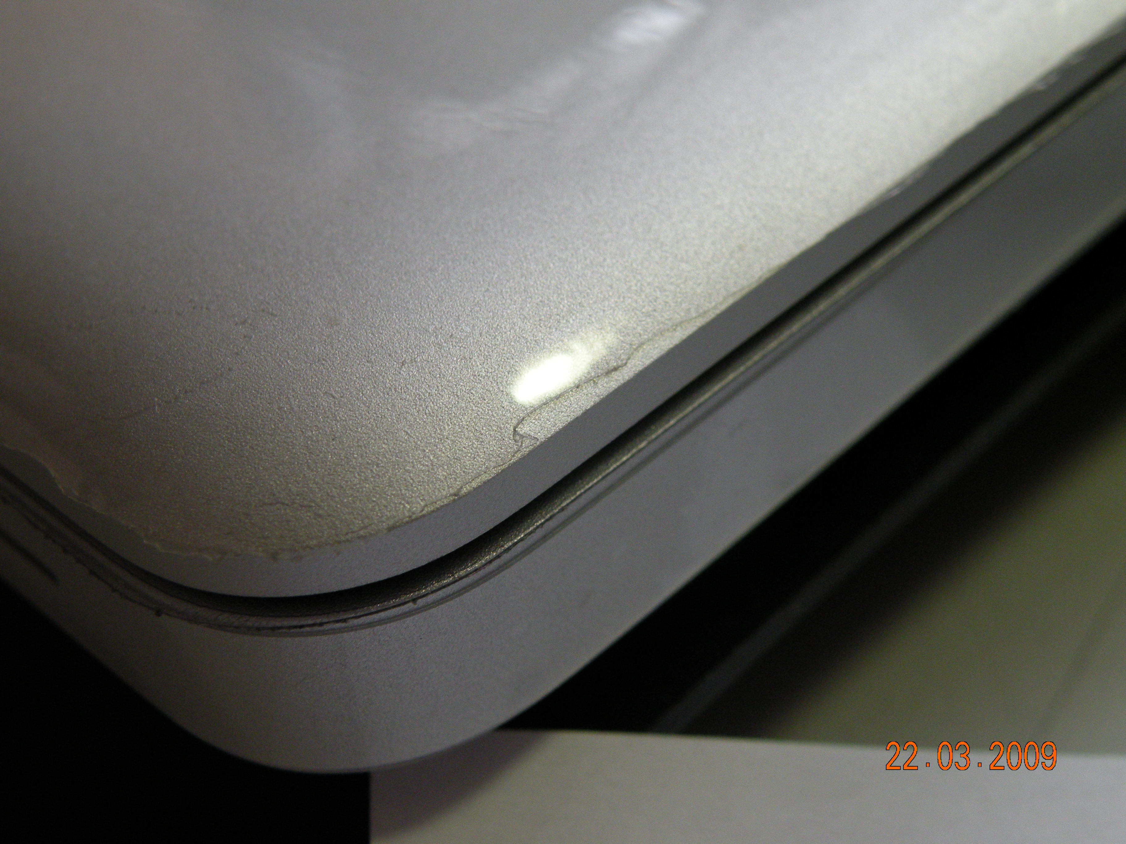

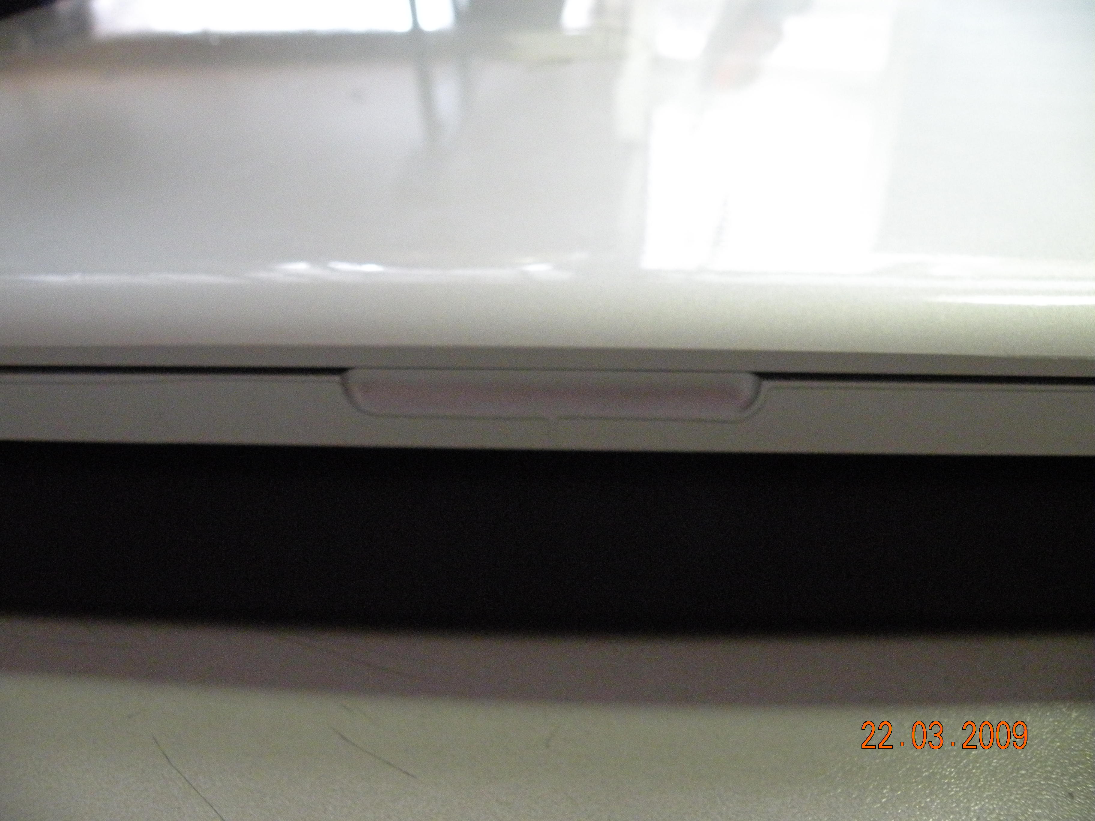

On the other hand, the side films over everything except the ports and cd drive (yes even the black plastic part at the back is protected)

- The corners of the top film and the edges of the palm rest extend a bit out. You should cut a bit of it before hand.
- It's better to leave it cut in a bit than to stick it out.
