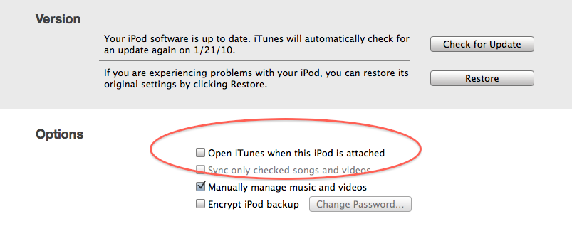

iPhone interaction with iTunes should work the same as the iPod Touch. I am able to do that. That option is available via a radio button in iTunes under Summary for my iPod Touch.
The radio button under Preferences is related to automatic syncing. There is also another option under the device summary - but it is also related to automatic syncing. The option for "open iTunes with this device" is gone. Nevertheless - this was remedied with a .plist refresh. But it really speaks to what Apple is trying, unsuccessfully to do.
Okay, in the midst of your issues something may have happened to your iTunes because I am not missing that feature. Like I said, it should be the same with the iPhone and iPod Touch but maybe it's different for the iPhone. Hopefully someone with an iPhone will confirm this but meanwhile here's a screenshot of my iTunes with my iPod Touch connected and the feature to "Open iTunes when this iPod is Attached" is very much there and it works. Now granted it does begin to sync when attached but it opens automatically when I connect it. Were you looking for it to do something different?
