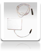

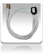

and one of these (from China) for just the magsafe connector:
http://cgi.ebay.com/ws/eBayISAPI.dl...02494&ssPageName=STRK:MEWNX:IT#ht_3261wt_1145

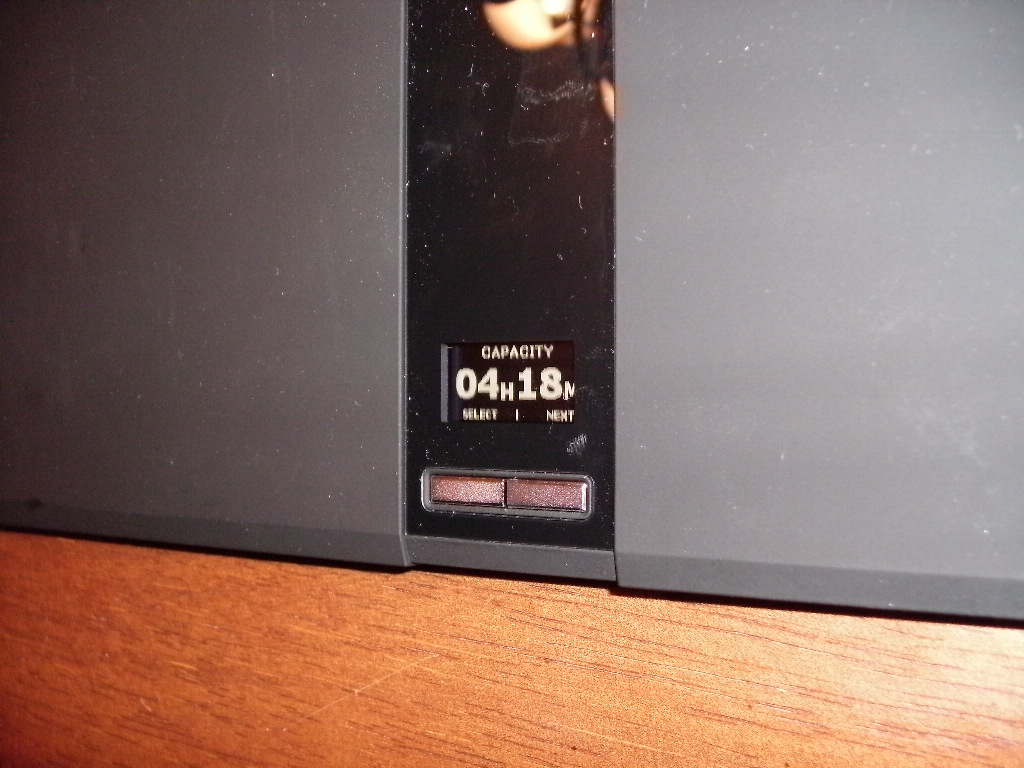

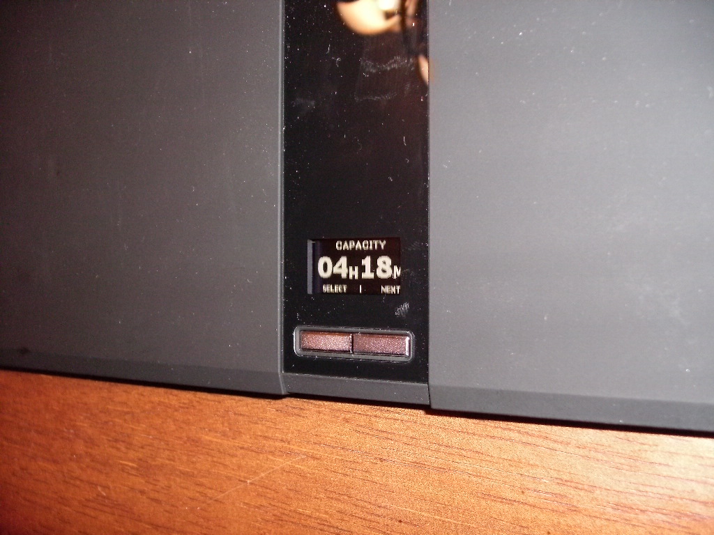

And now I have a full external battery solution. The UPB90 is a really nice unit. Slim (slips right in a laptop case), light and has a really nice OLED display that shows the charge (in % or battery grafic), discharge rate (in watts, hours till dead or %) and has auto settings for voltage, or just set it from 15v-20v. Since I got it today, I have been running my MBA (set at 15v) off it for 3 hours so far (using wifi, bluetooth and brightness at about 75%), and the display says I still have about 2 hours of charge left (at current discharge rate). Of course, when this external pack is done, I still have the internal MBA battery charge (it has stayed at 100% while plugged into thsi battery).

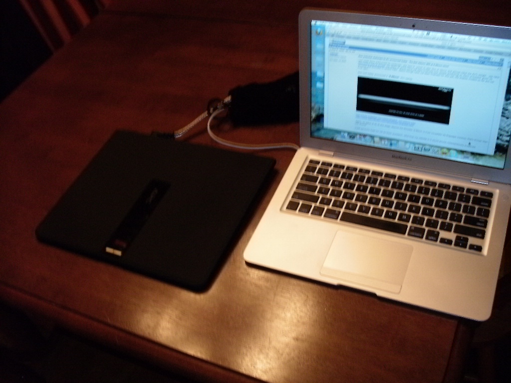

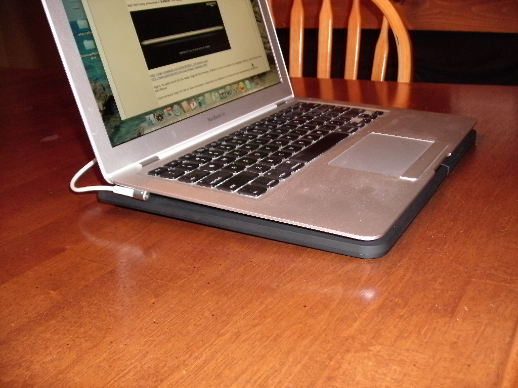

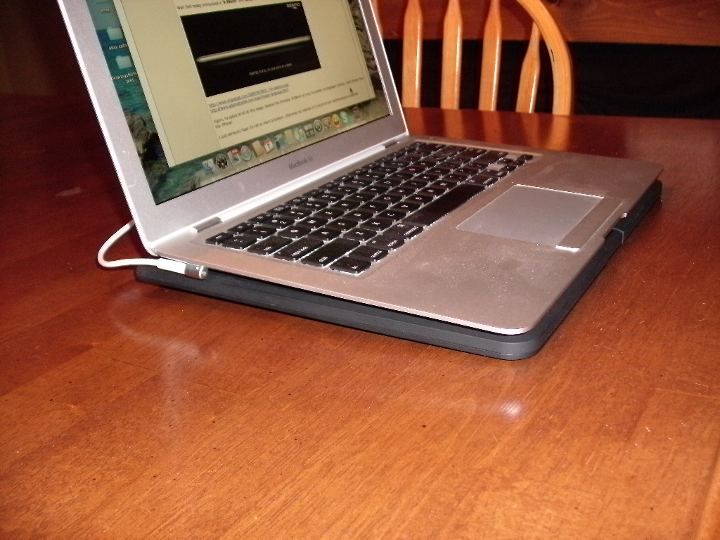

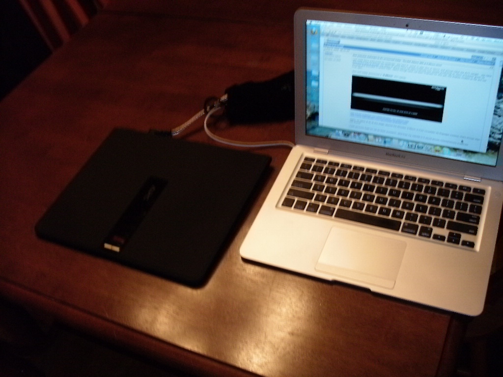

Tonight I might post some pictures. One nice thing about this battery (unlike others) is that it is thin and about the same size as the MBA, so it makes a nice tray that keeps the air vents on the MBA unobstructed when sitting on my recliner arm (or other soft surfaces). Plus it has 2 USB ports for charging MP3/cell phones. Great unit to slip into a laptop bag for travel.

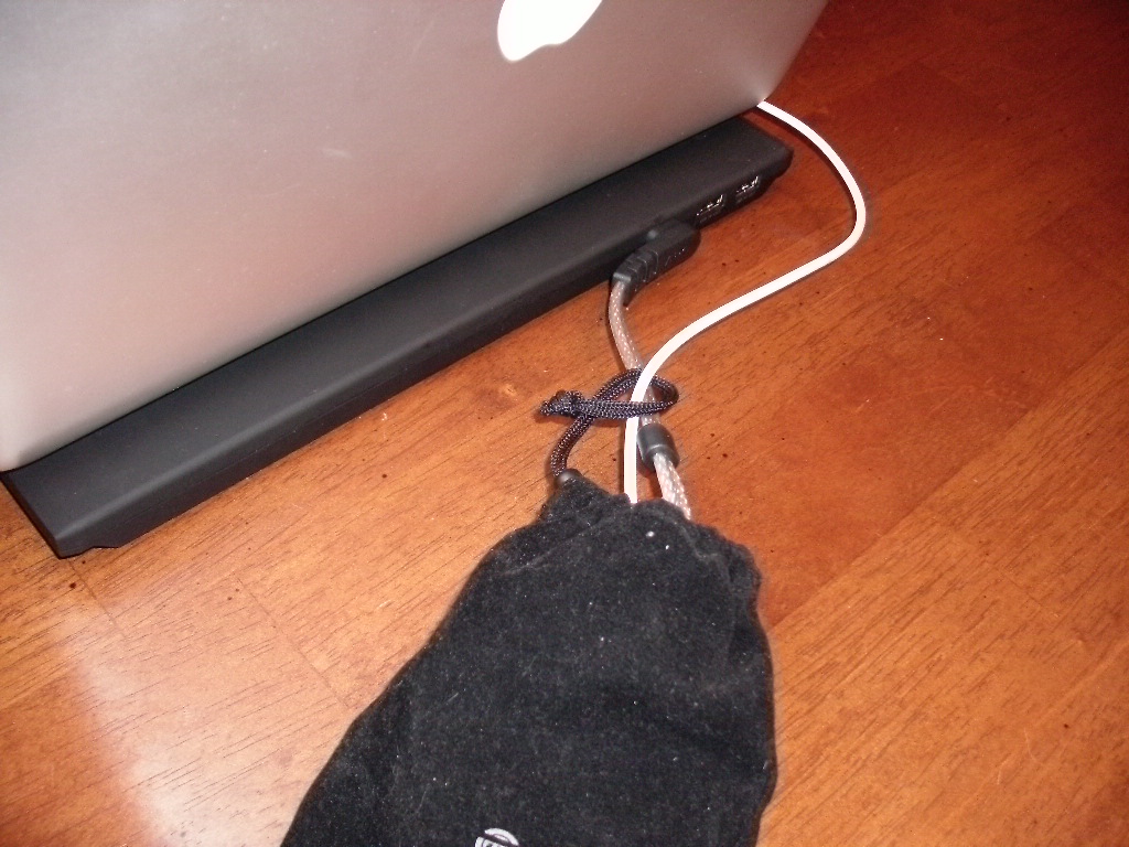

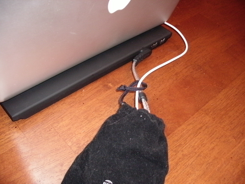

One thing I don't like, is the connector cord. It is a bit of a tangle. It is pretty long and with my magsafe cable, even longer. I might modify the cable to make it shorter and less cumbersome. It also has 2 connectors (output to laptop and input to charge, which makes it more bulky). But for about $100 total ($75 for battery, $25 for the modified magsafe cord), it is hard to beat.

Thanks, but I would not say mine is the best solution, but it is a really nice solution for me. And as MacModMachine pointed out, APC discontinued there external laptop batteries. But this one (the UPB) can be had on ebay for much less then the original $250 (as I mentioned, mine was $75). I must say, the digital display is both handy and gorgeous. I have found it is almost accurate to the minute on the remaining runtime. I got home late tonight, so no pictures to post yet, but maybe tomorrow.
Here are a few pics.
