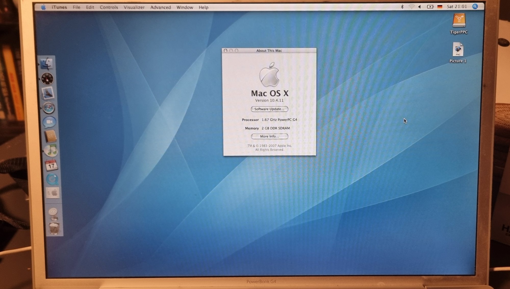

But only by the clunky expedient of using an external FW800 drive. The internal ATA bus seems kaput.
Now I have it running, will try and get some sort of Linux on it.

DDR(1) RAM and what looks like a reasonable resolution? I'd guess a 17" 5.7.
Sure the bus is dead or maybe just the drive? mSATA to IDE would be the way to go.

Have already tried all that, and none of it works. Original drive, new drive, mSATA with adaptor - not even visible on the bus, with or without ODD connected. ODD opened, cleaned, tested on another machine, all good.
Hence the FW route.
1440x900, 17 inch A1107.
I'll see if i can still get an ATA ODD caddy and try an SSD in that, but tgese things are so picky...

The ATA bus being dead is extremely unlikely. I guess not impossible, technically. But its unlikely. More likely would be the cable. And, I see you said you put the ODD in another machine to see if it works, and it does.
Before writing the bus off as dead, get a new cable, and a new drive (HDD\SSD). IDE by nature is odd sometimes in, if one thing on the bus doesn't work right, it can screw with everything else on the bus. IE, if you have a bad HDD cable or HDD, it could make the ODD not show up or act weird too. It wouldn't hurt to put a known working cable in the problematic PowerBook, it could be that the ODD cable is causing an issue. They still have to properly be set as slave\master\CS which if one of the cables is screwy that could cause them to not show up.
So that's what I'd do before writing off the bus. If that doesn't work, consider yourself unlucky I guess lol. At least it's a FW 800 model, an SSD in a FW800 enclosure is pretty quick, and you can daisy chain a FW ODD too, and whatever else. Just be aware in this scenario that there is only a single FW bus, so it'll default to the slowest speed device connected. If you have a FW 400 ODD plugged into it while booting off the FW 800 drive, you'll be bottlenecking the boot drive with 400Mbps.

I've ordered a replacement cable. I have a selection of drives, from the original spinner, a newer, larger spinner, and an mSATA adapter. If that works, great. It will still be a desktop machine, as it were, because a new battery for this is simply unobtainable.
How is this done? There are no jumpers on the original drive, so I've always assumed the two drives use CS.
How is this done?
Nowhere.
HDD and DVD are separate cables anyways.
Removing the DVD and retesting with just a HDD/SSD might still be an idea.

I have tried that; no effect.
There is one thing I've "discovered" over the past 24 hours or so: the existence of that thing called "Apple Partition Map", and I wonder if I might have got things wrong on that front...
You don't select the jumpers on laptop drives, the cable does. This is true in almost all laptops, and for sure all Apple ones.

Correct, but (unless I'm mistaken here) it is the same controller. IDE needs those jumpers by nature, but we don't set them like in desktop drives. They're already part of the cable. If that part of the cable is shorted out or damaged, it won't read right.
They may be on separate ATA controllers, they are in the PowerMac G4s so it wouldn't surprise me if they are in the PowerBook too. But that would make it even more unlikely to me anyway, that both ATA controllers quit.
If they're different controllers, the cable is still "setting the jumper" as either Master or CS for both.

If the disk isn't being recognized at all in disk utility or system profiler, it would probably be a hardware issue.
That's exactly it - invisible disk! Anyhow, replacement cable on the way. If it's not that, then I'm stumped.
Another thing I've noticed now I have it running (Tiger 10.4.11) is that if I plug any sort of drive into USB, it will eventually vanish, whereupon the machine scolds me because it wasn't 'put away'! 😀

It happens with multiple drives? Normally, I'd say the USB drive may just be flaky. Thumb drives are always flaky, and so are the old micro and mini USB cables. Maybe try cleaning the port or using another port?

a) does that happen both on the left and right USB?
b) are your sure all cables are properly seated?
c) is there still life in your battery and if not to do you use a 65 or 45W PSU?
d) is or was there any physical damage on the PowerBook?
You might have a case of a dying logicboard.
Nope, these are no longer available anywhere, so that option is closed.
Is this what you are looking for? Having said that, 12.7mm is probably too thick for even the 17" PB. Maybe you could butcher one and just get the connectors and circuit board you need out of it.
a) does that happen both on the left and right USB? - yes.
b) are your sure all cables are properly seated? - yes.
c) is there still life in your battery and if not to do you use a 65 or 45W PSU? - no battery, 65W PSU.
d) is or was there any physical damage on the PowerBook? - no, good condition all round.
You might have a case of a dying logicboard. Hope not, still a few things to try.
A 65W charger should be able to deliver stable power without a battery but you might want to reduce consumption.
Reduce screen brightness, turn of kbd light and maybe even remove the non working IDE devices since you also need to run the FW drive.
See the if that reduces USB dropouts.
Also try running the USB sticks through a powered hub.
