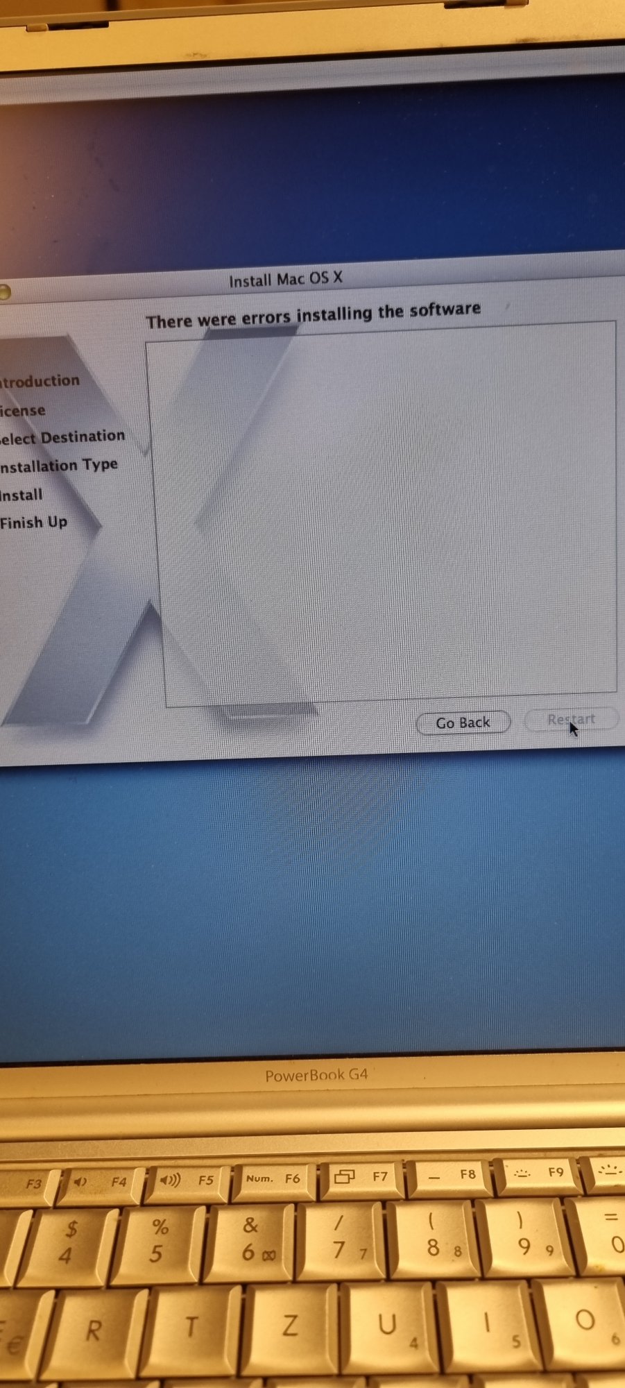

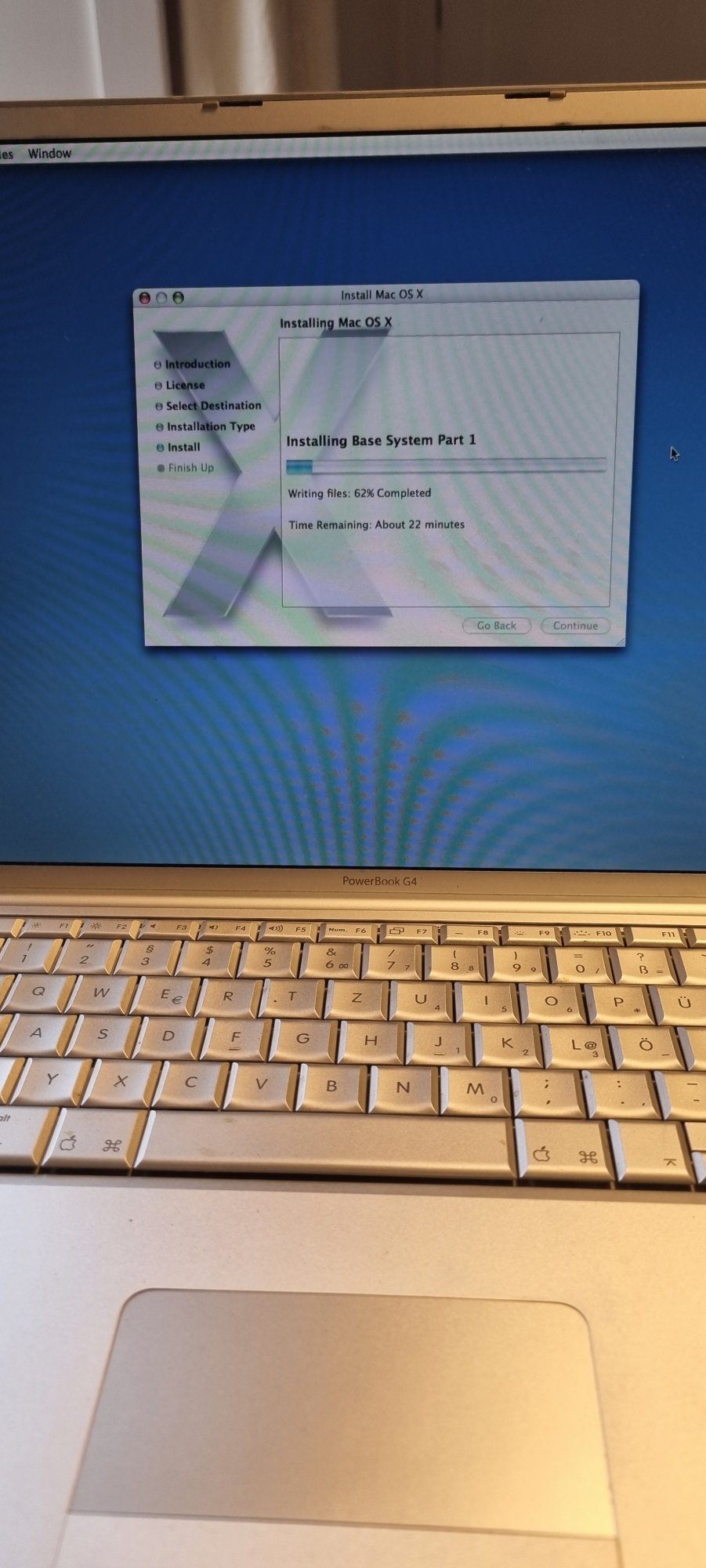

What is the furthest you've gotten? Your problems remind me of the issues I had with the first SATA to IDE adapter I tried in my PB. The installation of OS X would proceed like normal before either failing (as if the DVD image was corrupt), or finished successfully but result in a system that was not bootable. For some reason the adapter worked fine with a newly formated SSD but writing to the drive severely impacted the performance. I tested the drive in other machine and it worked flawlessly, it was just the adapter the caused the problem. Switching to the red adapter I linked to above solved all of my issues.
