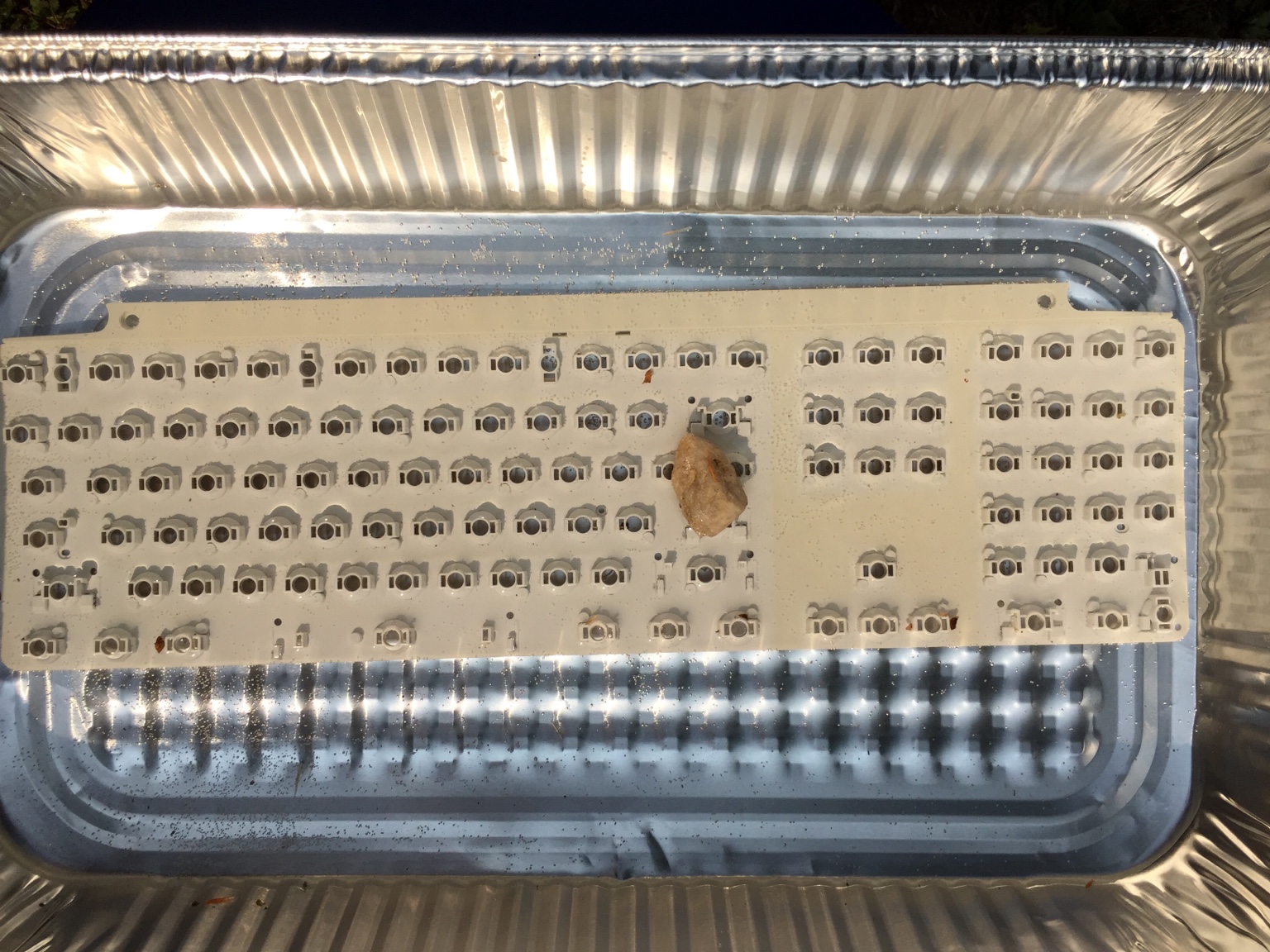

Also, I just went outside to check again, I moved it back into the sun since it came back out, and I noticed it was floating, so I put a small rock on top of the most not yellowed area and now it's completely submerged in direct sunlight
3:30PM- it was completely covered in bubbles, so I lifted it out of the Peroxide to let the bubbles pop. I put it back in and because of the position of the sun right now, part of the right side isn't getting any light. I guess I should go rotate it now that I think about it...

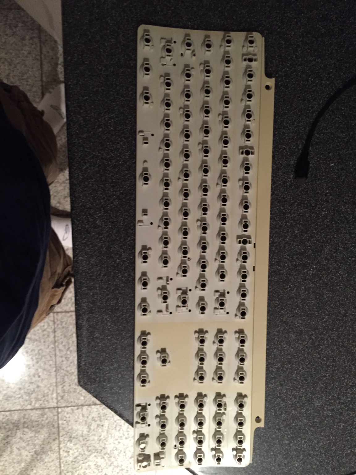

Here are some progress photos!
Before-

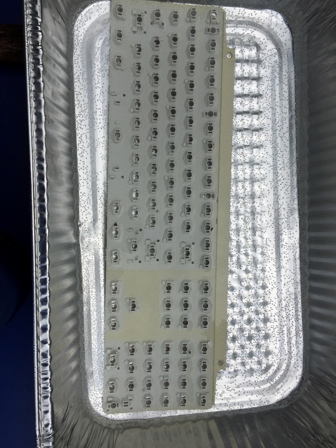

During-
12:30:

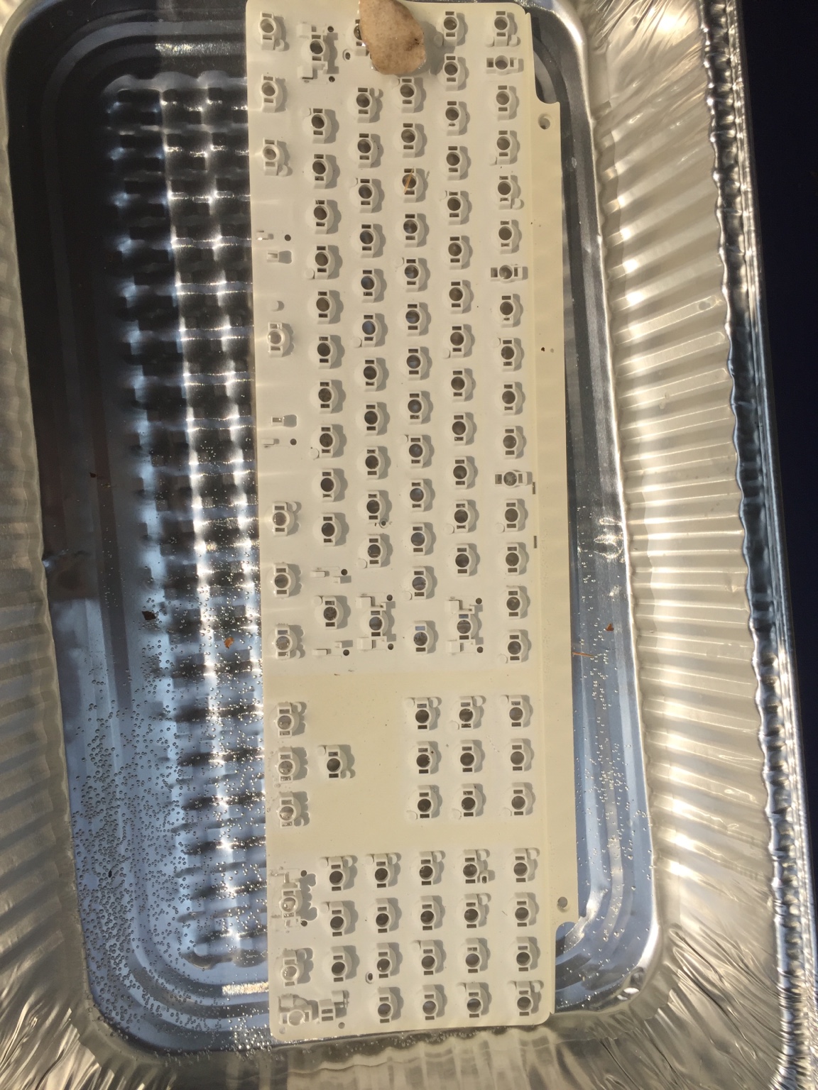

3:30
(rotated)

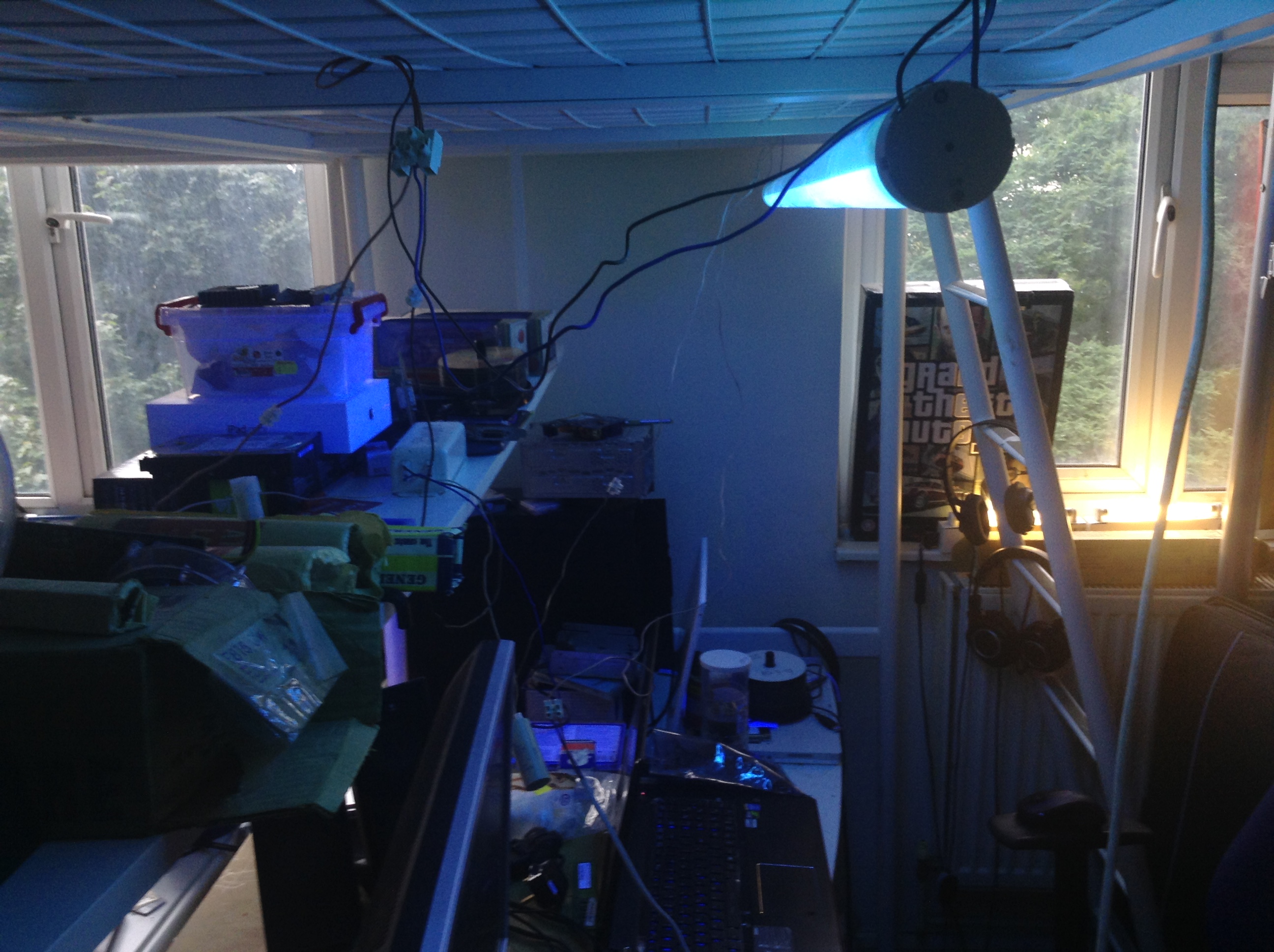

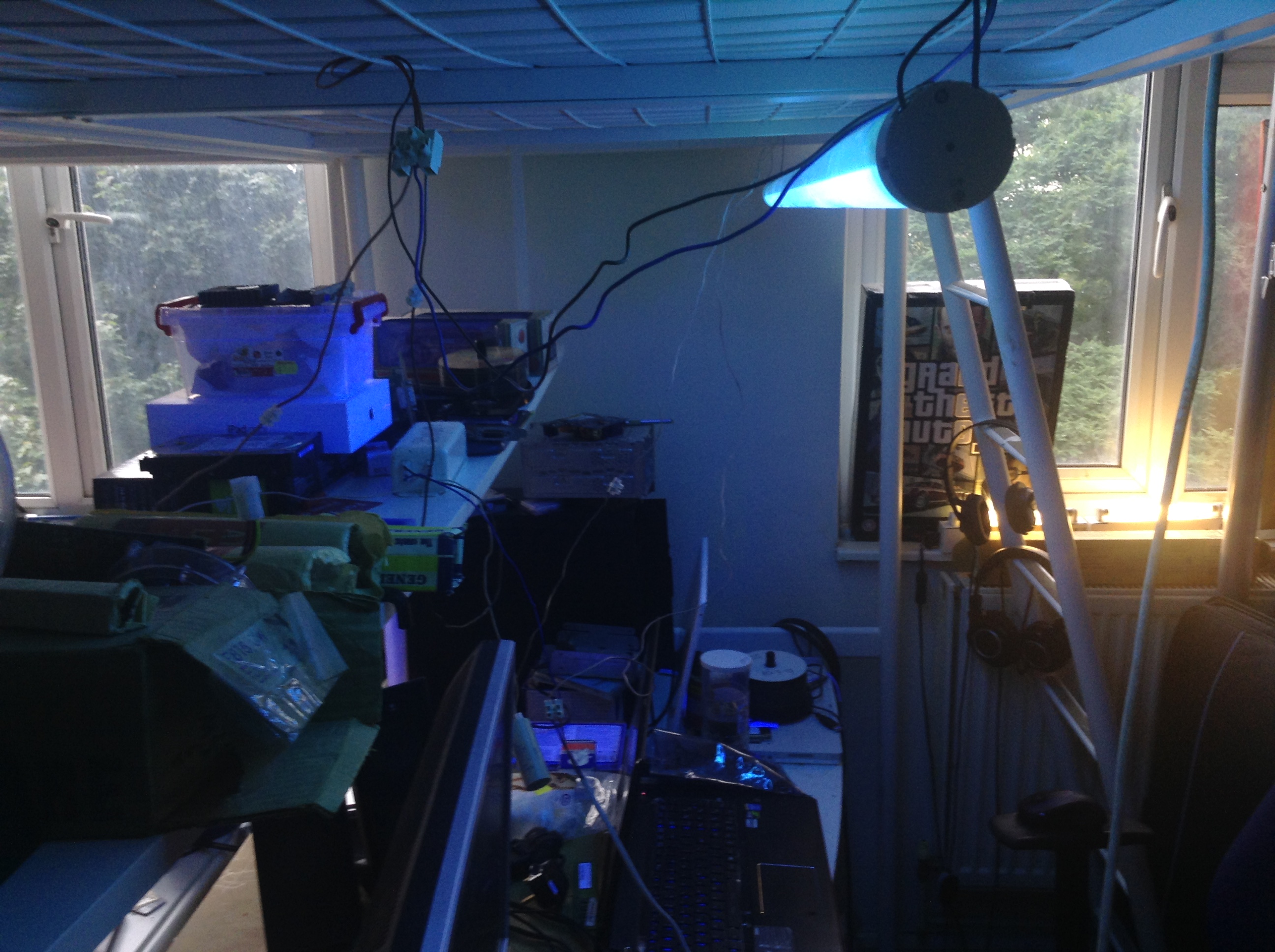

looking good! heh the only thing i have that id consider retro brighting would be my G3 beige but thats a big thing LOL at least I wont have any UV issues considering I own the mother of all UV light sources 😛 this is my Desk under a 80W 5ft UV Sun tanning tube with a built in reflector heh

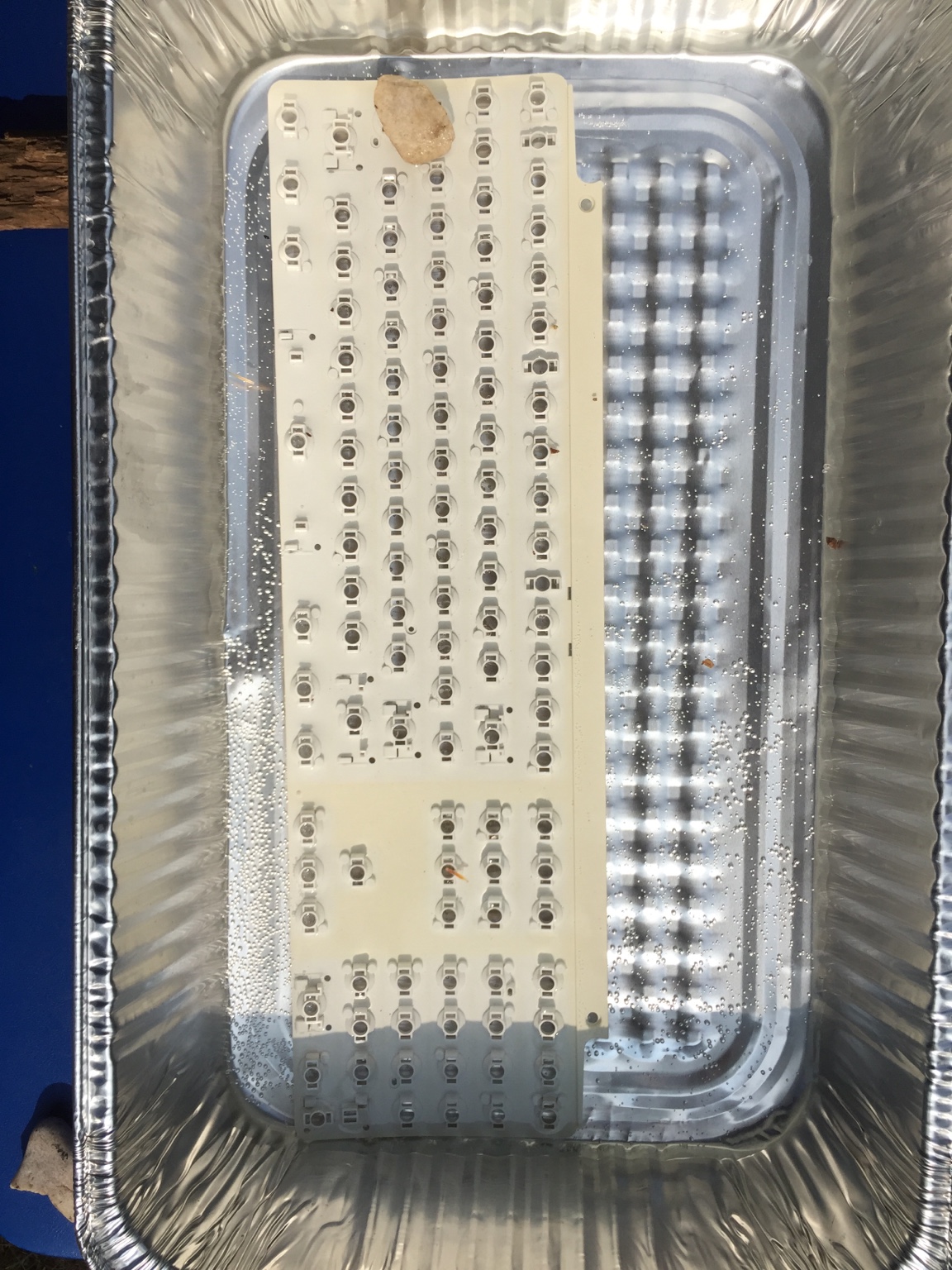

Day 2 of Retr0brite-
I stuck the keyboard outside today at about 9:00AM. It's absolutely beautiful out with not a cloud in the sky. I just got back inside from checking on it and it looks even lighter! So here are the pictures from today:
10:30AM-
