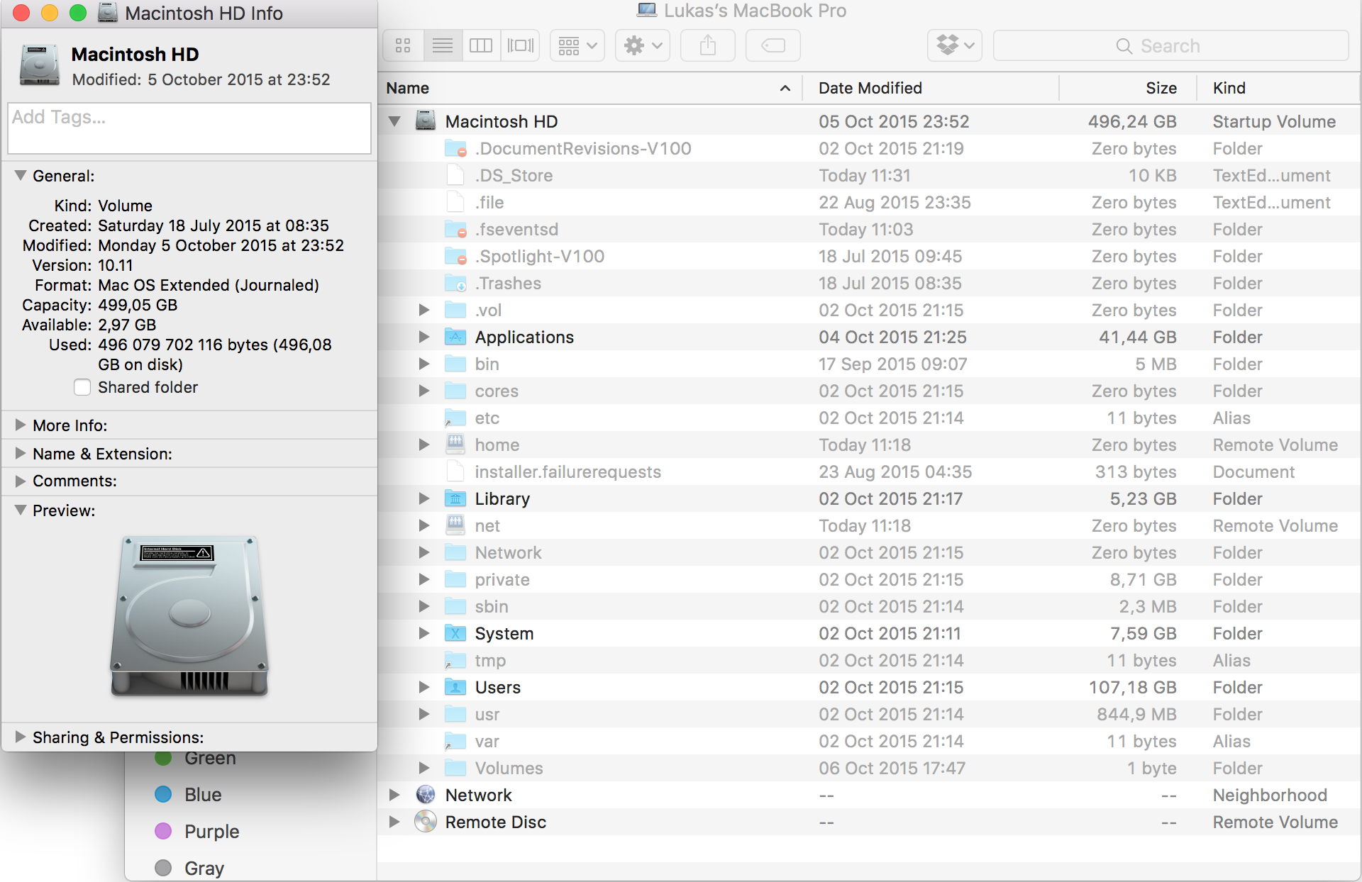

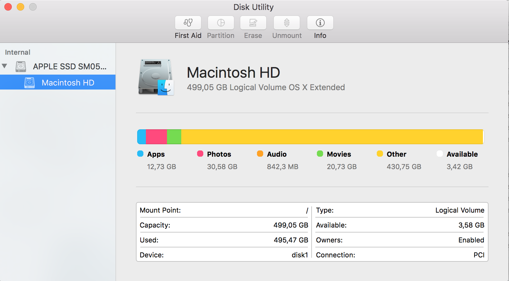

Hi!
I had a strange problem with my old Macbook Pro (2012 13") that my free space on my hard drive was getting gobbled up by something, if I checked all the folders (hidden and visible) and there was nothing that could explain that I suddenly had only a few GB left.
I have now a "new" computer (late 2013 15" retina) and now to my surprise I have the same problem!
Please see the attached screenshots for explanation. I am quite stunned by this. My thought is that it might be due to Dropbox och Creative cloud. I have also tried doing First aid in disk utility and no errors were found.
Ideas for how to troubleshoot this further would be much welcomed.

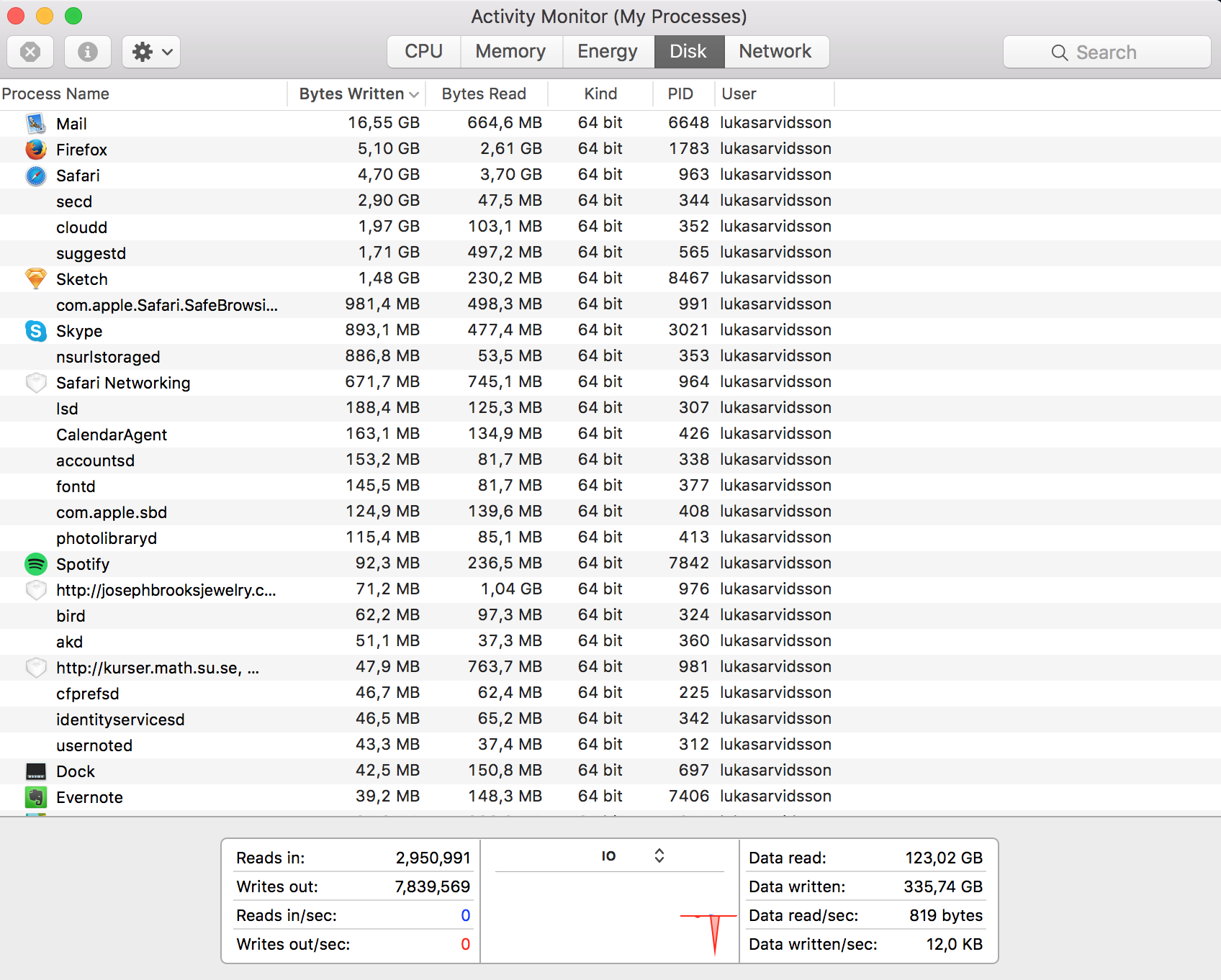

Can you check you activity monitor and see if there is a process writing to disk? My guess it's some temporary data written bij an application gone rogue.
Thank you for your answer.
Here is how it looks in the activity monitor.

I have now found the error. It is the application Sketch by Bohemian coding that has a bug with document revisions. I just deleted 323GB of version history from my saved sketch files. Each time I save a new file is added to DocumentRevisions.
To clean my document revisions i used the following command with great success "sudo rm -rf /.DocumentRevisions-V100” and my total disk usage has gone from 496GB to 173GB.
