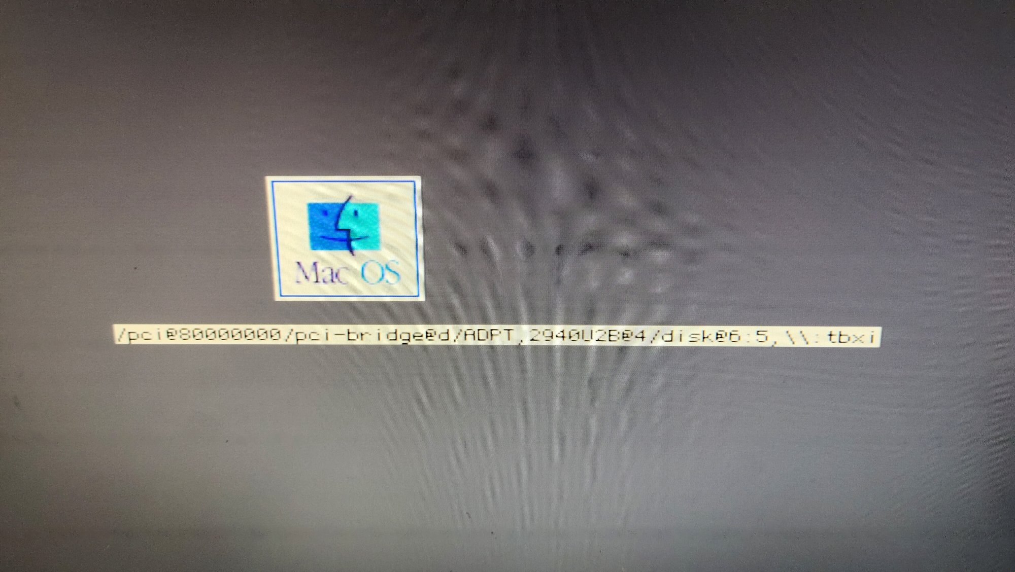

My G3 blue and white machine, openfirmware 3.1.0 appears when booting up.
I tried using the MAC-BOOT instruction, but it still doesn't work.
Is it a hardware fault?

Looking at the second image, there’s a reference to a hard drive connected to an Adaptec 2940 SCSI controller.
OP: is your boot drive connected to that controller?

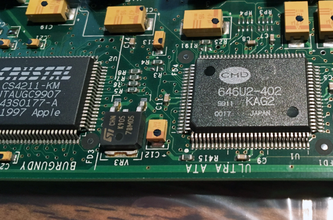

*Rev.1 or Rev.2 mobo might not be of any importance here - but this is what a Rev.2 CMD chip looks like. (Notice the CMD 646U2-402 numbered controller chip.) No 646U2-402 number on your CMD chip = Rev.1 board.

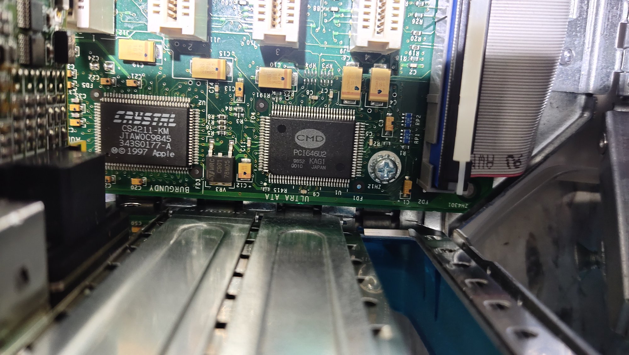

3.My chip was 646U2,I think it is Rev.2 mobo.

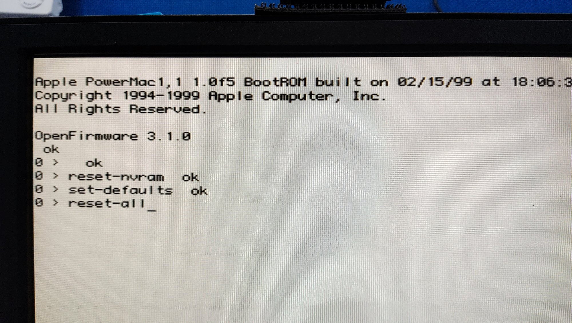

If you again get the open firmware screen, try a couple of reset commands on that screen (these are simple commands that I always use whenever I work on a powerPC Mac) :
type reset-nvram, then press enter. You should get "ok"
then, type set-defaults, press enter again, and you should again get "ok"
finally, type reset-all, press enter. Your G3 should immediately reboot.

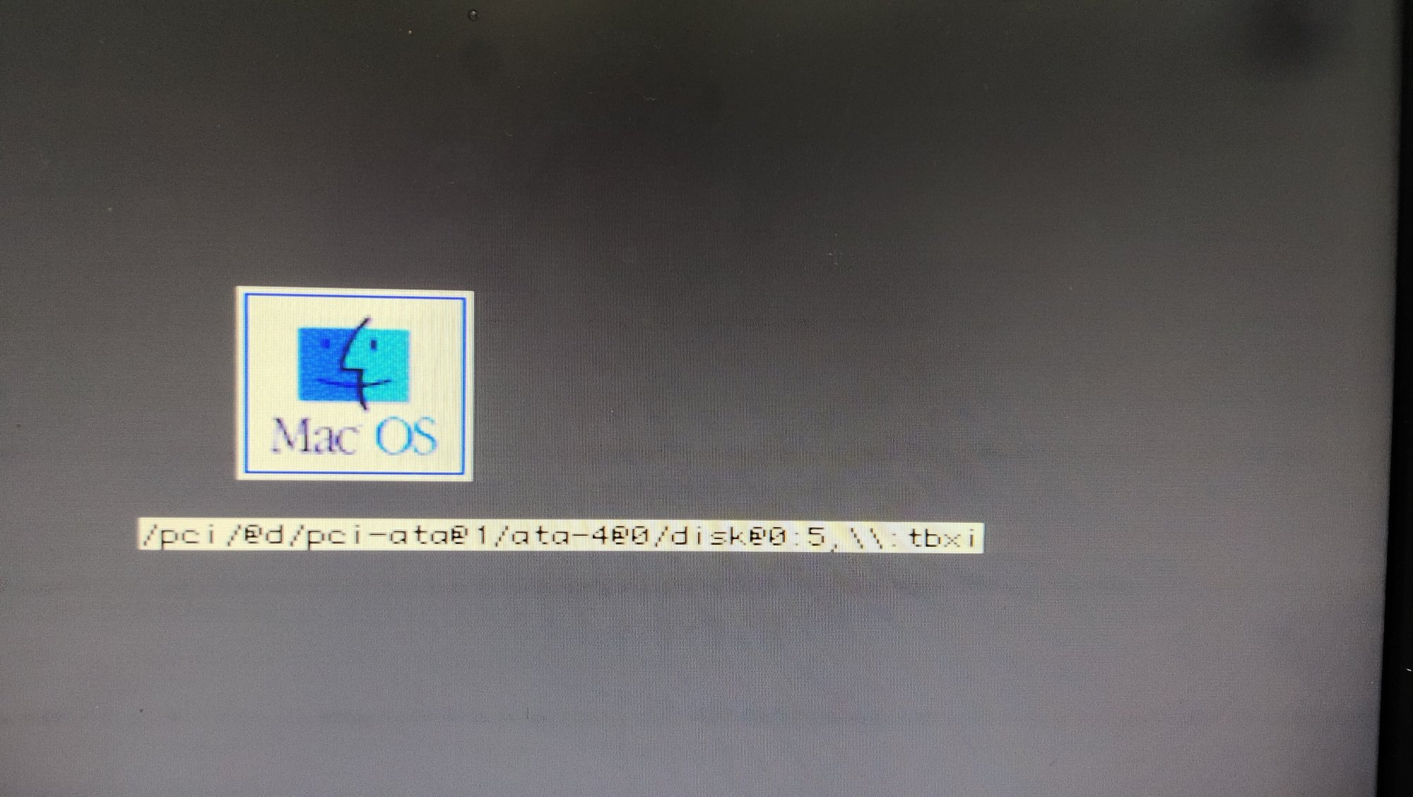

Hi Sir:
For ram issue,i had only one,i try to change slot still no improve.
I tried to use reset-nvram & set-defaults & reset-all & try to PRAM reset still no improve.
I try to use mac-boot got pic2 status.
If you still get that single beep - and you have just one memory stick, I would suggest your memory stick is bad. The only way to test (or fix) this is to try another memory stick. You DO need to make sure the memory stick that you have is correct for your G3.
Check the battery on the logic board. It needs to be at least 3.3 VDC, a low or dead battery might contribute to the problems that you are having.

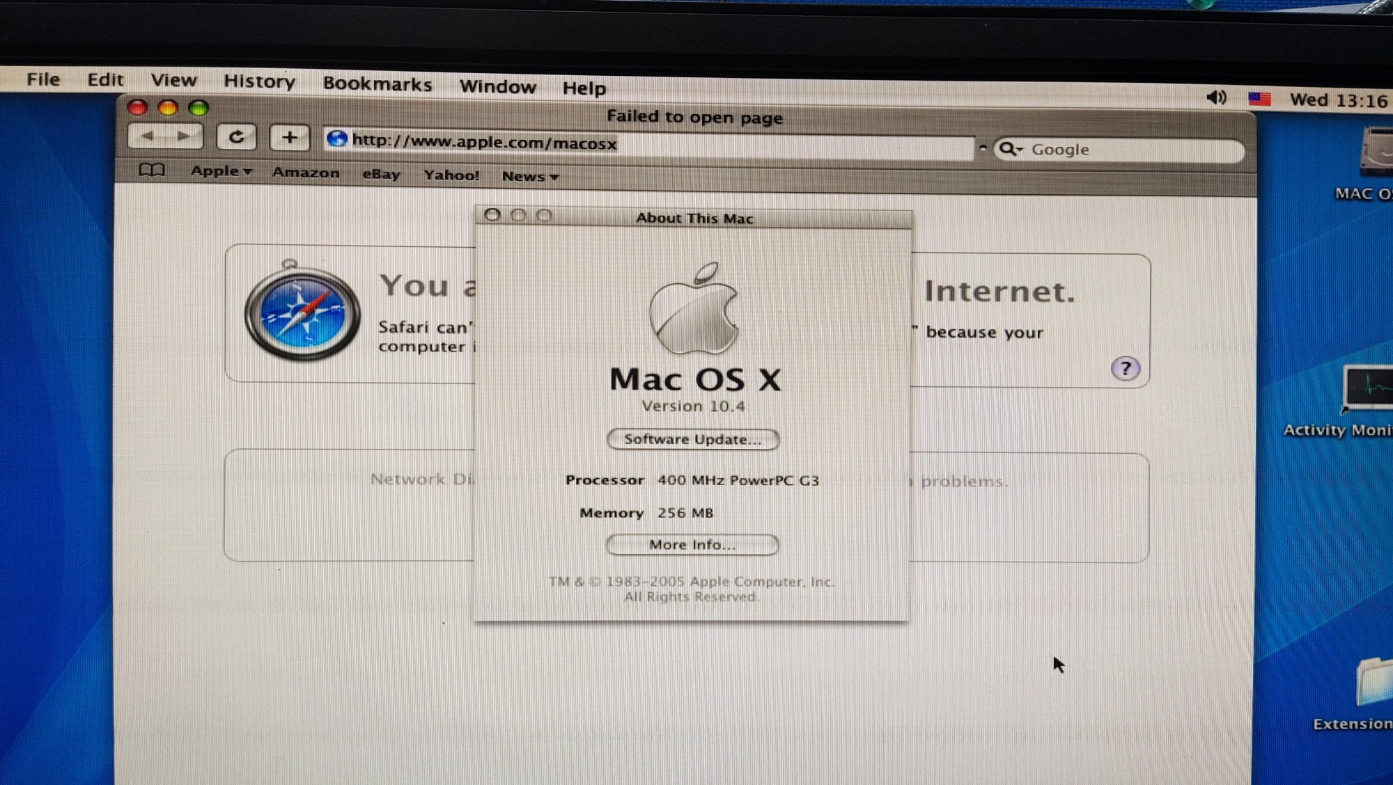

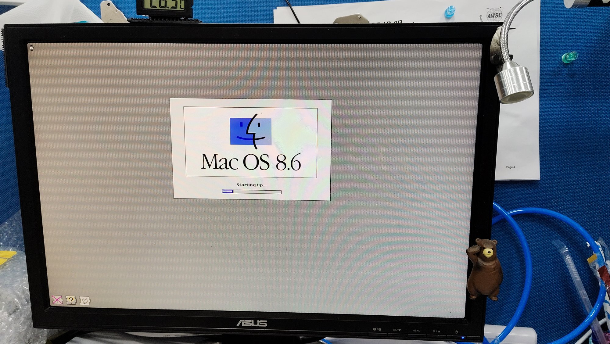

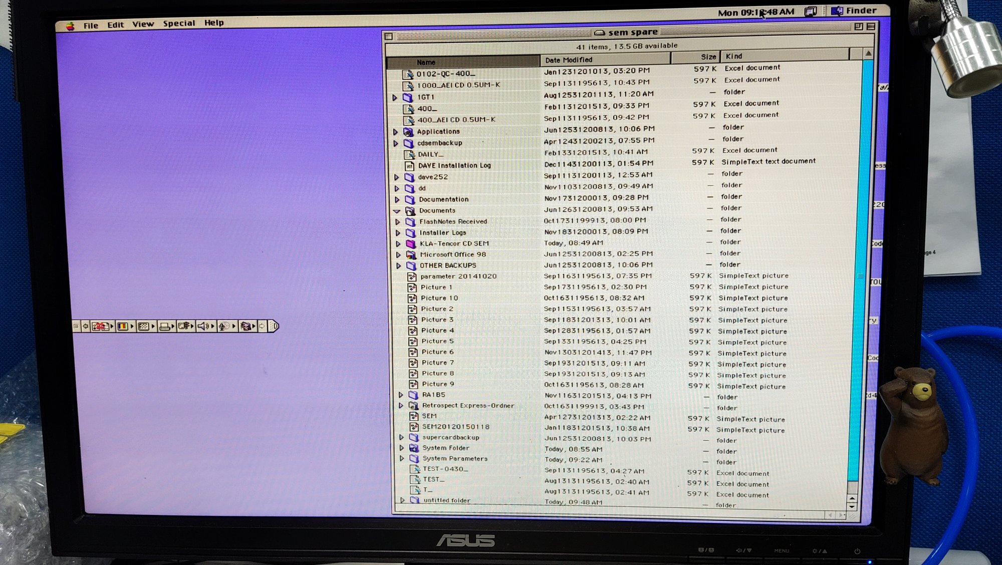

Hi Everyone:
I tried to remove the logic board from the machine and reinstall it. Then the retest became normal. I tried
to install OS 10.4 successfully and observed no abnormality after a few days. I will ask you for other
questions later.
Thanks
Jacky
