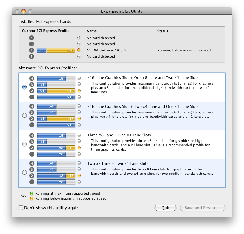

Yes, see attached.
Lou
Better to choose option 3 because there is no way that you can use slot 3 with that heat sink.

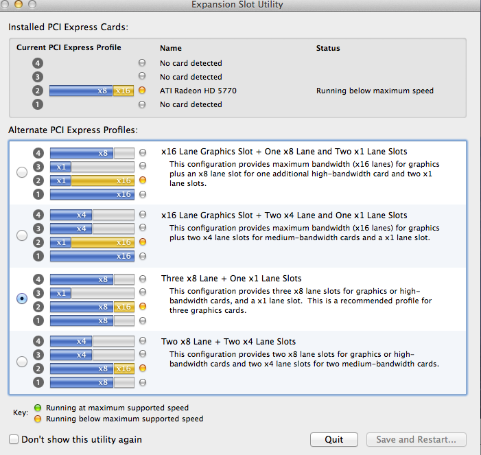

Just tried option 3 and restarted, but it still says that my card is running below maximum speed.
Don't worry, I run my 2nd GPU (7950) in a x4 PCIe 2.0 slot, just 4% performance hit (compare to the same GPU in slot 1). The actual penalty is negligible.

It could just be in my head, but I felt like certain graphics/animations felt slower than usual. I'm unsure as to whether this happened previously or not, but an example would be the 'More Info' menu in 'About this Mac.' (I'm referring to the modern one, not simply System Profiler.) When I switch between the tabs it has, the animations are at a very low frame rate. However, when I played Minecraft, I noticed that my FPS remained the same, so who knows?
