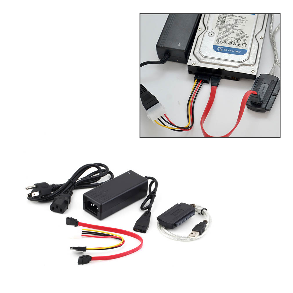

My MO anymore is to install on the new drive while it's still external, verify that I can boot from it, and then install. Saves the potential aggravation of having to pull it if something goes wrong.
Reactions: 960design
We have a kit that does that very thing...
Something like this:
Ours is a bit 'fancier' or 'unfancier' if a huge headache of cables is something that kicks in your OCD.
