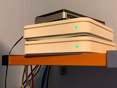

I took this photo a couple of minutes ago. These two are in my office and each has a 6T WD Red. One is about 7 years old and the other is nearly 10. WiFi is disabled on these and ethernet is fine.

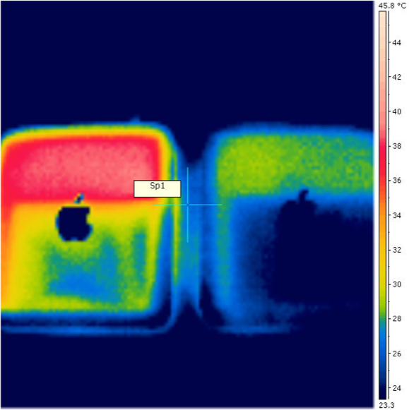

The following image shows infra-red imaging of two TCs, during 33GB with of file transfers. On the left with ex factory fan setup and a WD Green drive, the right one with a Seagate drive and modified fan setup:
There has been indeed some testing done with temperature examination on the old TC design (e.g. by Chris Fackrell), using different types of hard drives. Basically, the temperature difference is essentially negligible between e.g. an original 500GB Seagate and a 1TB WD Green drive - during above file transfer scenario it is about just 1°C difference (Seagate 45°C to WD Green 44°C, which is actually quite hot for a WD Green).
The main source of the heat in a classical TC is the power supply temperature which is about 10°C higher than at the hard drives (about 54°C, red area in above image).
Thus, while a Seagate overall runs marginally hotter in an old TC (please note emphasis) than a WD Green, the main source of heat comes from the power supply. As this is not in the fan air path in that old TC, the massive heat emission of the power supply warms up also the drives, considerably so.
Modifying the fans reduces temperature at the power supply by more than 10°, and concomitantly also at the hard drives to healthy regions well below 40°C.
This is why I personally think that the technical temperature difference between a Seagate and a WD Green is actually higher than just 1°C measured by Frackrell, but it is masked by the heat coming from the power supply.
