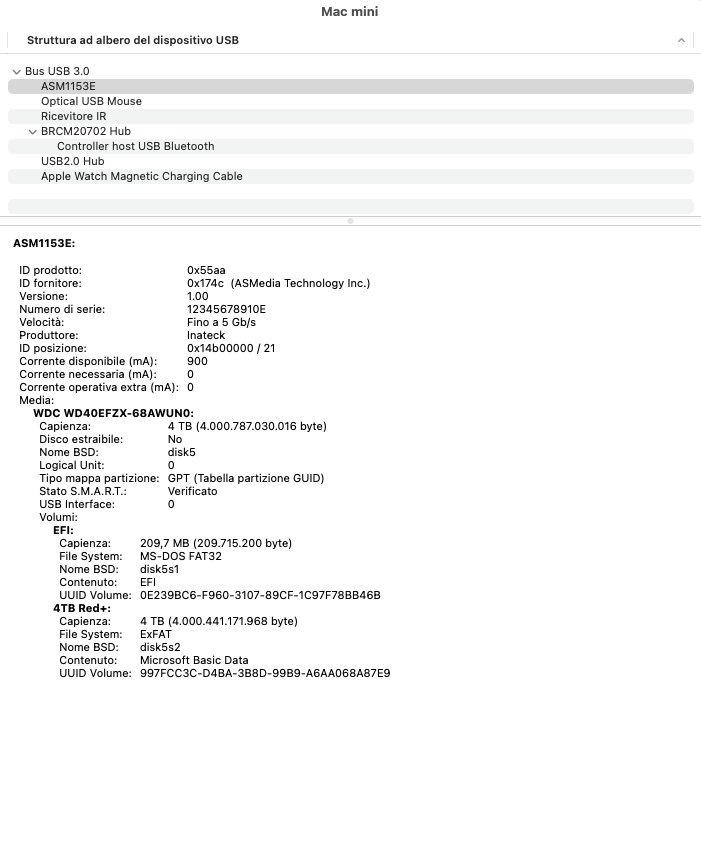

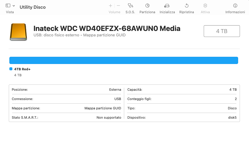

Have no clue why it won't mount the disk even tho the enclosure is recognised by MacOS, here a screenshot showing enclosure being seen:

p.s. actually after quite a while being connected it mounts onto the desktop but if computer goes in stop, even tho I have disabled the sleep for hard drives, it gets unmounted and as such, being a backup drive, the backup process gets interrupted
An ExFAT disk formatted by a Mac or PC?
A Mac!
I can format it again as it's a backup drive and, fingers crossed, I have the whole content onto both the Mini's HD and the external drive serving as a photo archive, how should I format it like for max compatibility and considering I only use Mac so no need for FAT or NTFS?
