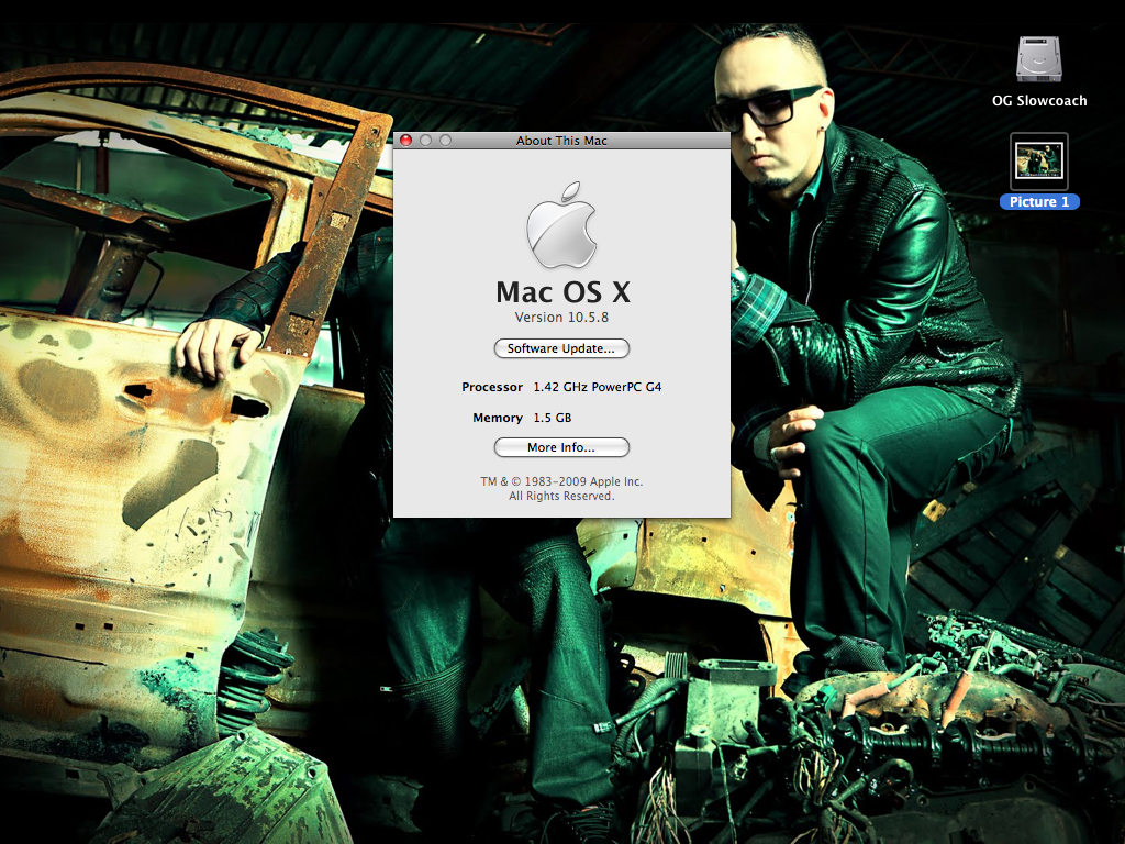

I left the iBork iBook for a week, and for some reason, it booted up into the copied across Leopard, and it was working. It was a bit slow (HDD) but not freaking out? And it was running off battery also. But then it froze, and I rebooted it. And then the 'no hard drive' crap started flashing across it, and I can't physically open those 🤣 (even trying to follow a guide, it's useless for me). I guess it's gonna have to suffer and wait for a while.
ANOTHER UPDATE: I did a PWM reset and it rebooted fine, and the apps work on it now. It falls asleep, and the fans aren't kicking in. Let's see how long this lasts.
