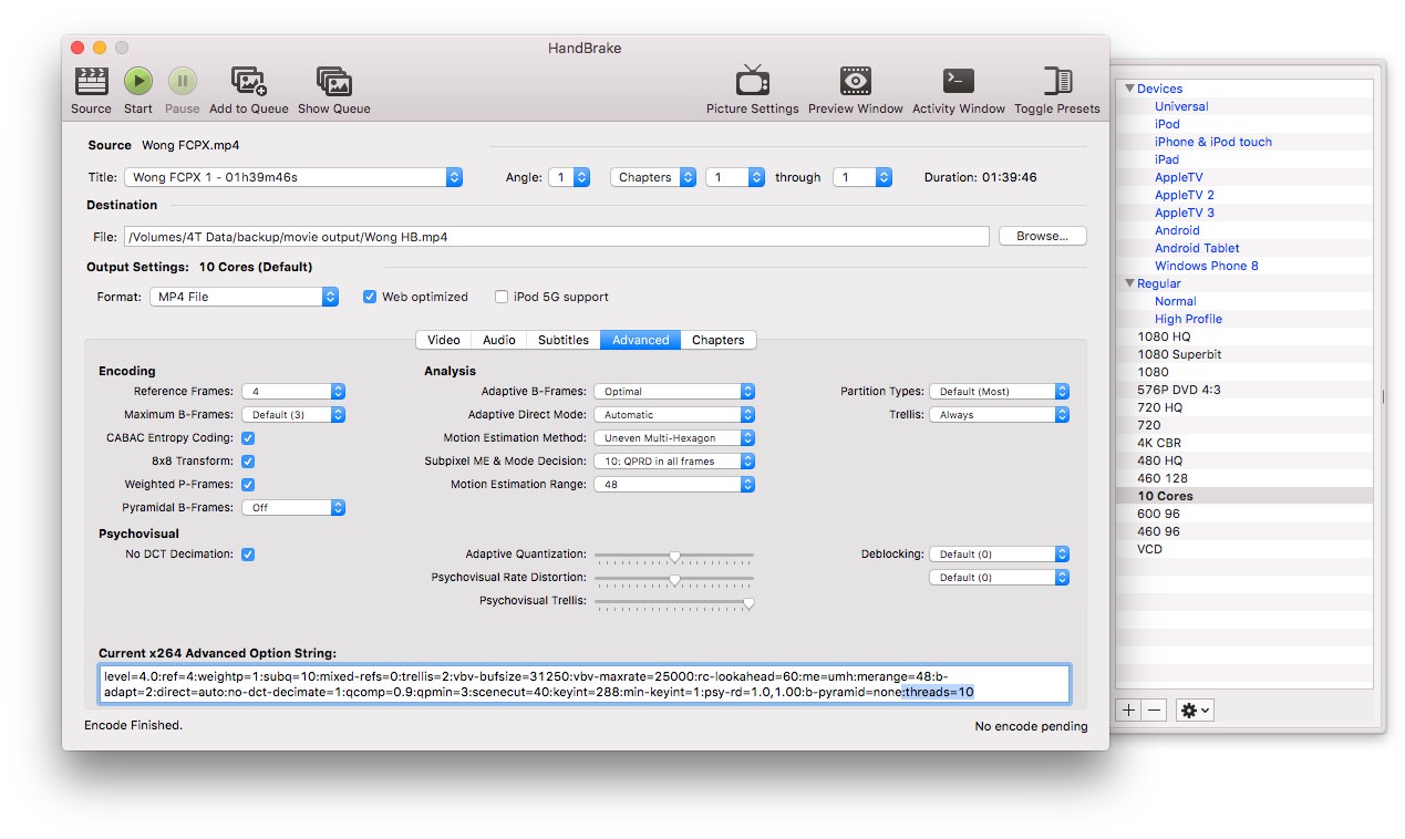

For Handbrake, rather than turn off HT, you may just add ":threads=6" (or =4, whatever you want) command in the advance section, that will limit Handbrake only use up to 6 thread of the CPU. So, you still has HT, all 8 thread still available to you, but effectively avoid Handbrake fully occupy your CPU.
This is what I often do to my machine, not for cooling, but leave 2 threads for something else. In my case, I limit Handbrake max at 10 threads, because I frequently run Handbrake continuously for >100 hours, and I want to reserve 2 threads for my Mac to give me same responsiveness for other ops. But in your case, it should help to cool down as well. I don't know if those encoding job is time critical for you, if not, you may simply limit it to use less core, and leave it in the background. That's how I use my Mac anyway. 😉

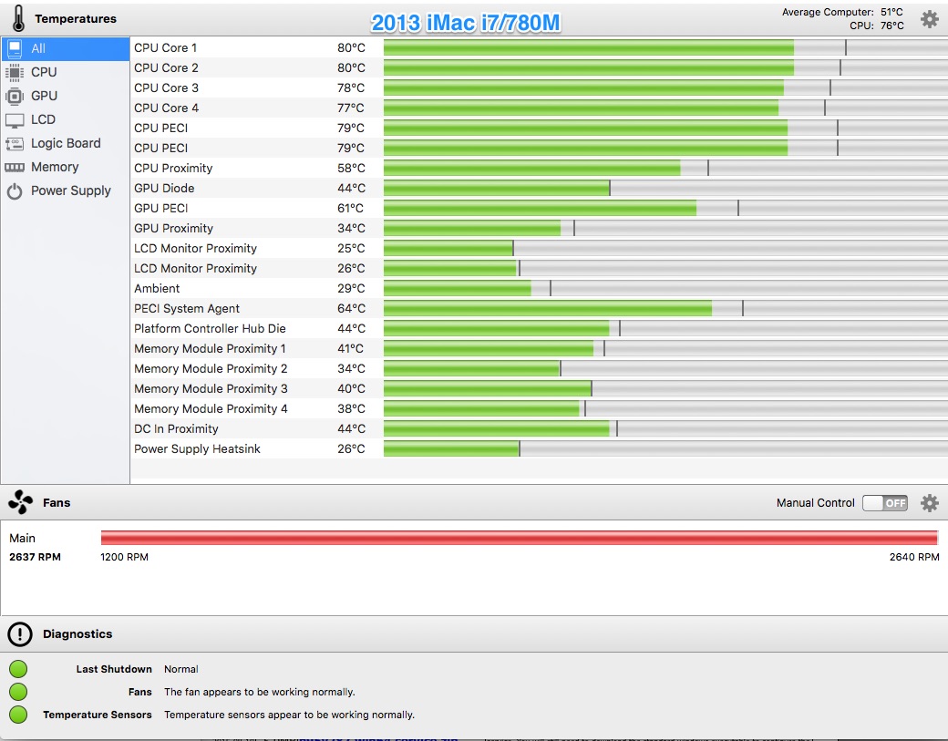

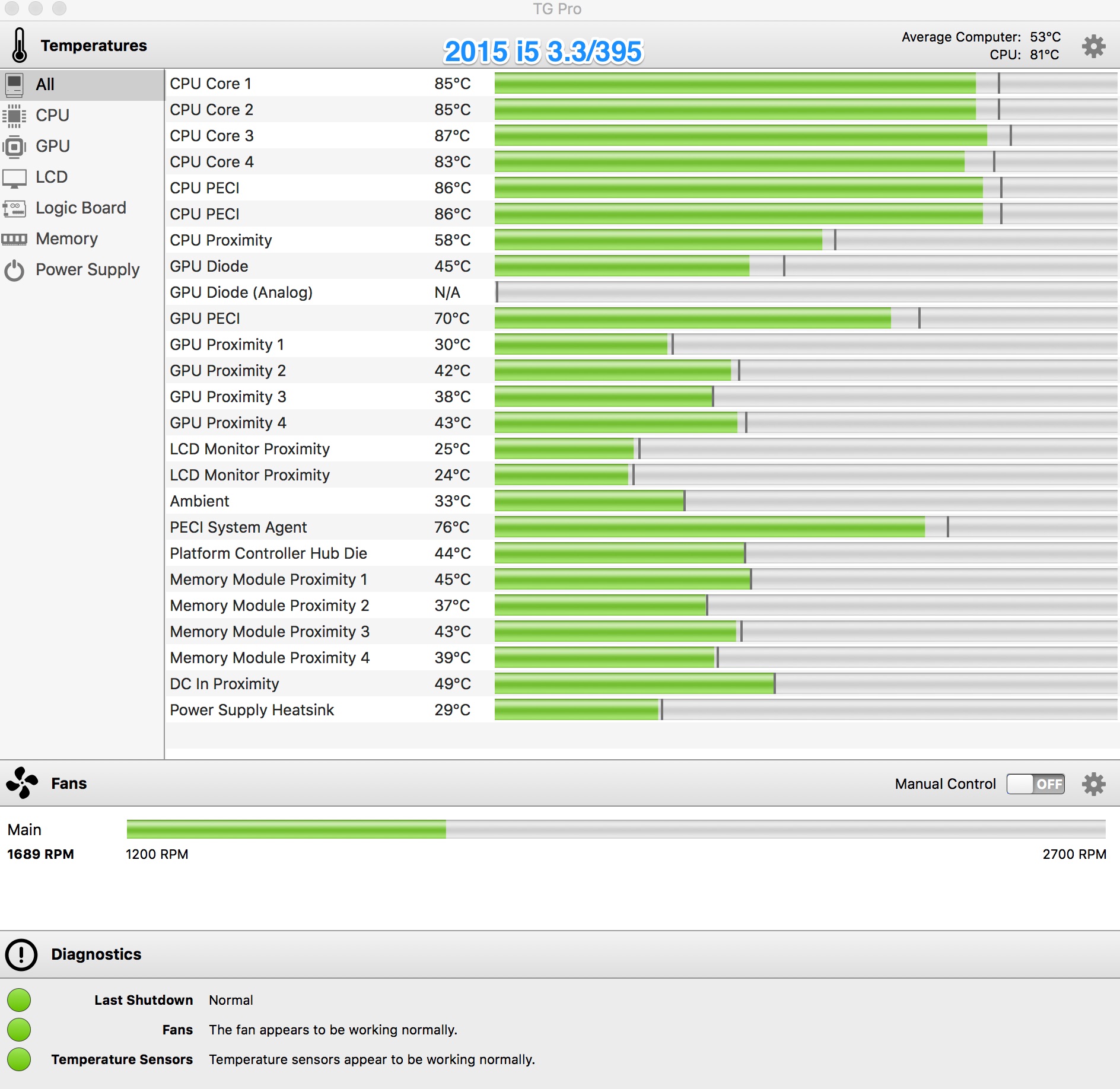

I have a 2015 i5 3.3GHz/395/32GB/1TB SSD, so that should provide you with a comparison all else being the same apart from CPU. Nothing to encode in Handbrake right now, but I ran the Prime 95 "torture test" on both my iMacs (see screen shots). Subjectively, the 2015 i5 was much quieter, temps were lower and fan didn't spin up as much. The 2013 iMac is a Haswell 3.5 GHz i7 (I think it's a 4771)/780M/32GB/1TB SSD.
Conclusion: as expected the Haswell i7 generated more heat than the Skylake i5. In both cases, the iMac's cooling system kept the CPU core temps <90C most of the time, but this required high fan speed for the i7 iMac.

Data from my iMac be next.
Processor: i7 6700K
Memory: 8GB
SSD 512GB
Graphics: AMD Radeon R9 M395 2GB

The point is that the fans in this colder days does not have any reserve on board.
The result is that the cooling / noise is already at its maximum RPM.
