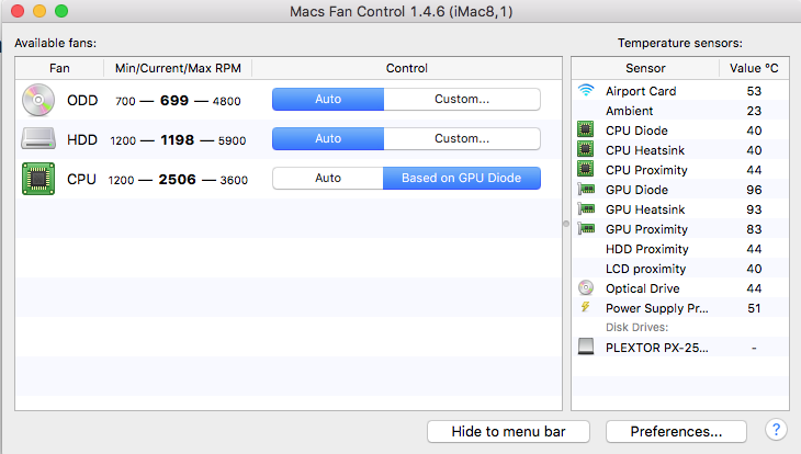

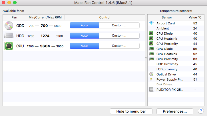

Hi there!
Reviving the problem on an imac24 2008 with ElCapitan...
Resetting SMC & NVRAM and nothing has changed.
After a short period of booting, the fan is starting to increase speed until it reaches the full speed!
with macs fan control i have these results:
CPU fan works at full speed...
Its possible to decrease speed but... is it ok?
I tried to customize speed in relation to GPUdiode temp and decreases as follows:
do u think that is ok?
Is it only acoustical my problem or not?
