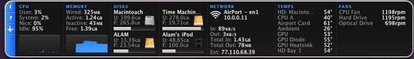

Those temps are definedly not normal. Are you sure your not having some heavy calculations on background process ? I bet you have some program hogging your CPU at 100%. Check your activity monitor!

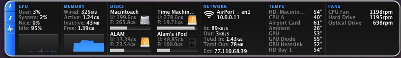

Here is my temps and have my fans boosted "just a tad"

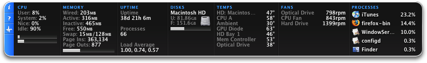

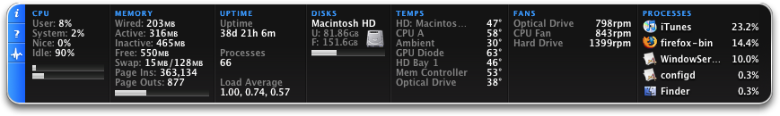

well i have picture for my state and right now i'm not running any application 😱
i hope that it's ok
i hope that it's ok
