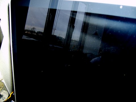

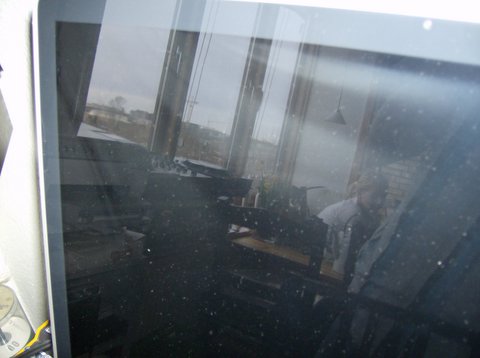

My 1 month old 24" alu iMac is turning white.
It looks very very strange and can only be seen whem the computer is off (when the screen is black). It's coming from the upper left corner of the screen, and go in about 15 cm, the shape of it is somewhat simular to the leopard standard screensaver - you now the light beams going up in the mittle of the screen. it looks milky-white, and seams to be on the inside of the outer layer of glass...
Any idea what this might be???
Thanks in advance.🙂
EDIT: SEE PICTURES IN BELOW POST
Her is a picture, its not the white dots im talking about, thats just dust on my camera lens, its the white lines going down from the corner.
I've upladed a darker image to, on wich its more clear, what i am talking about.

I've never seen that on my own iMac. It looks almost like it could be condensation. Is it particularly humid where you are? Does it change shape or size is it constant?
At any rate I agree with the others in this thread that no matter what it is you should be contacting Apple to send it in for service. It's easy enough to pop the glass panel using suction cups but I wouldn't recommend it. It's even easier still to get dust between the panel and the LCD when you put it back. 😉
Its constant.. And no, i live in Copenhagen, Denmark, where it may be rainy and cold outside, but not humid at all. I will call applecare to see what they say.

That could be smoke inside the screen. Do you have a fireplace near the computer? Do you smoke? Do your friends smoke?
I smoke a lot in front of the imac and that happened to me 2 or 3 times. If it is smoke it can be in the glass panel (in the inside) or even in the tft panel. Just remove the glass to see what's that.
If it is caused by smoke, just clean it.

Well, its fixated, so i seriously doubt that it is smoke, eventough I do smoke.

Looks like someone (housekeeper, spouse etc.) might have used a
glass cleaner with ammonia in it to clean the screen. That will over
time discolor it.

Hi mate i think thats condenstation
I had it the same, leave your mac on for a couple of days, dont let it sleep as it'll get cool
the glass infront of the screen can't be vaccum sealed as it will bugger the tft screen behind it, so its likely a little condensation can get in..
make your room warm, leave it on for a couple of days im sure it'll get rid of it.
mine has been fine ever since - and happened like you said (well it was off for about 2 weeks over xmas while i was away.. i had it for a week before that)
cheers 🙂
p.s its blatently not smoke 😀
